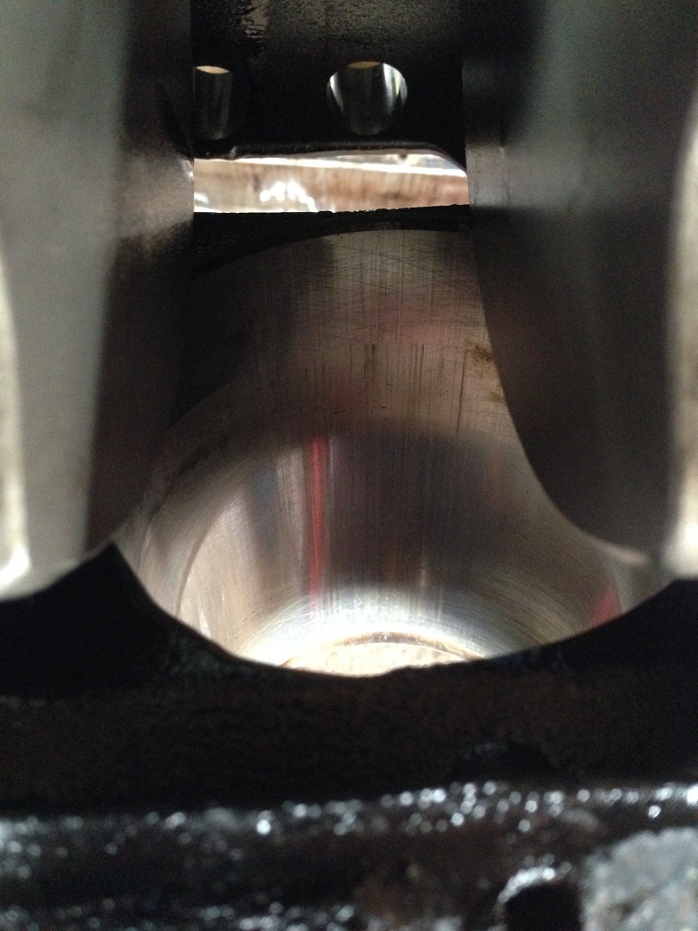

Looks like there has been a possible over heating of this Engine at some point the way the piston skirt has scored the bore? Scoring of the skirts and bores on all 8 Pistons and cylinders
- bore.jpg (250.08 KiB) Viewed 1326 times
- piston resize.jpg (241.72 KiB) Viewed 1326 times
