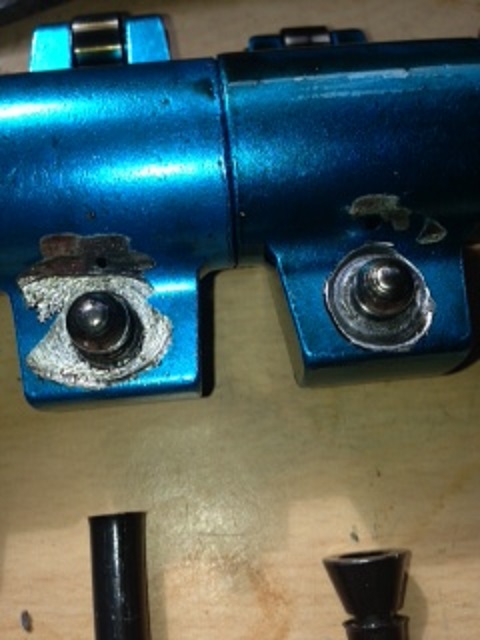

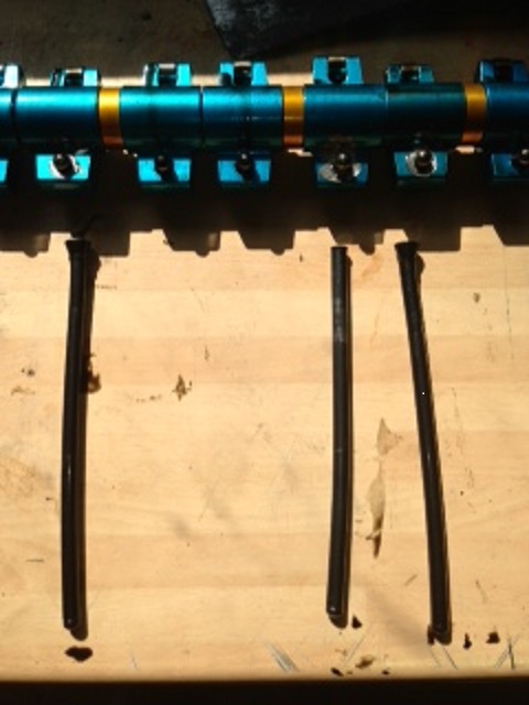

3 rocker locking nuts (cheap Chinese proform crap) on the left bank came off causing the pushrods to smash into the rockers damaging the rockers and bending themselves at the same time.
rockers resize.jpg (88.92 KiB) Viewed 3193 times
damaged rocker resize.jpg (70.74 KiB) Viewed 3193 times
bent rods resize.jpg (64.42 KiB) Viewed 3193 times

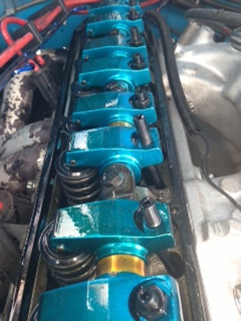

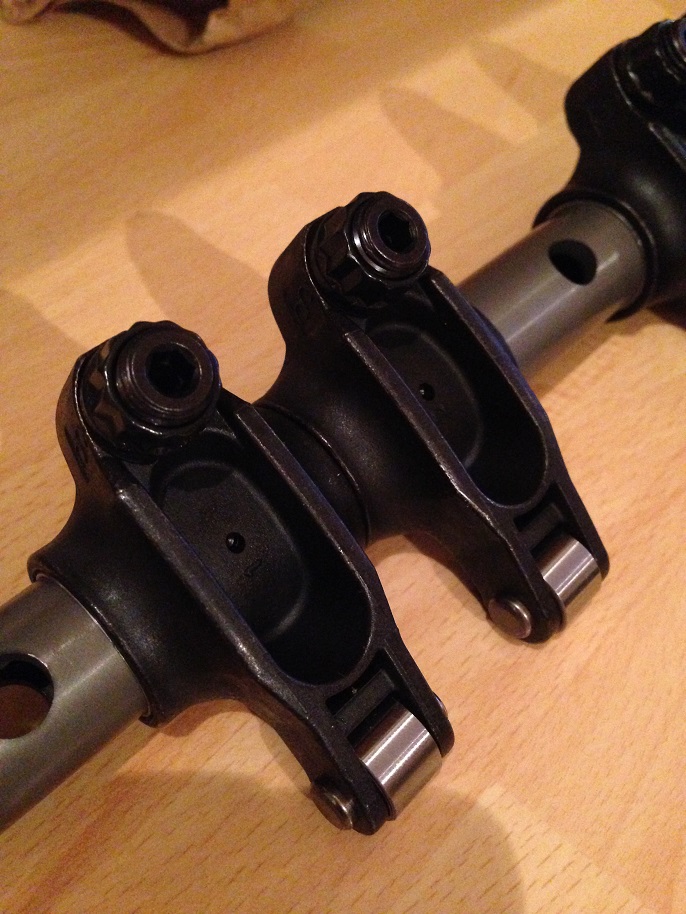

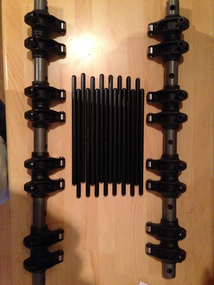

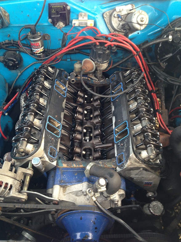

Okay so fast forward to March this year. when I finally got around to looking at the car. Only need a new set of Roller Rockers and Pushrods, not too bad..........or so I thought. Off I go gets me new Rockers and Pushrods, fitted 'em lovely.
Comp Cams Ultra Pro Magnum Roller Rockers and Comp Cams .080" Push Rods 7.55"

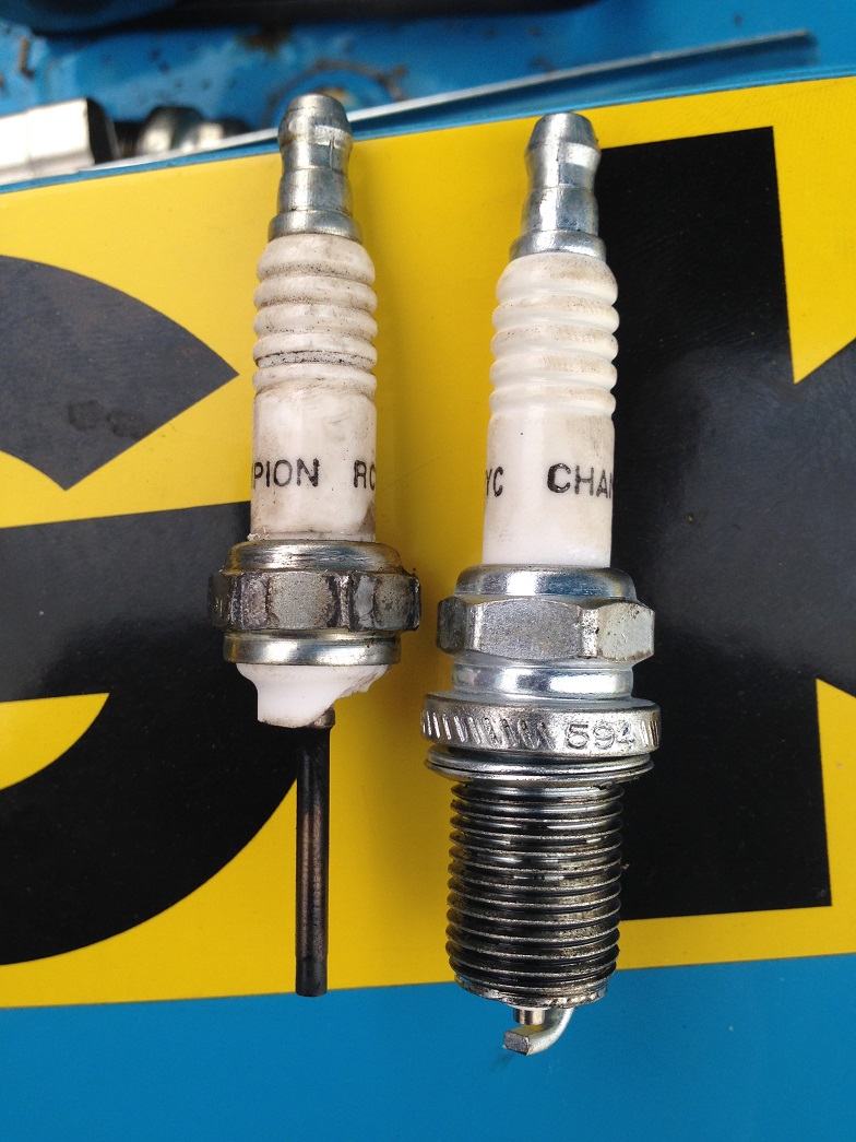

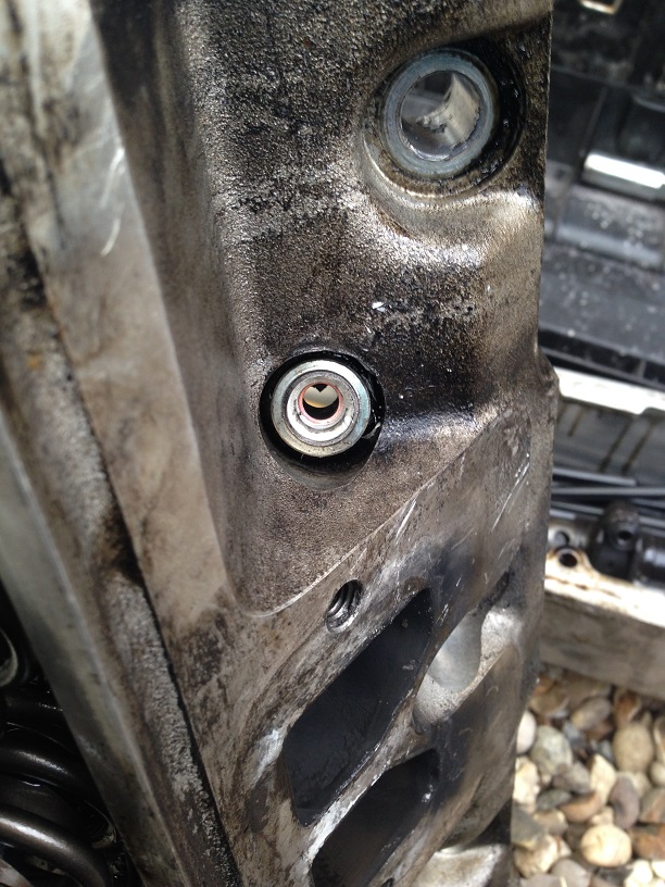

Change the plugs I thought.........Second from last one to do F,me this is tight. Bang! ratchet went flying, that didn't sound good. And this is why.
*MMA-609*
"Built to be driven!"
Why me??? :banghead:
Carl
Posts: 4826
Location: Rochford. Essex
Post by Carl »
You Bugger I thought.

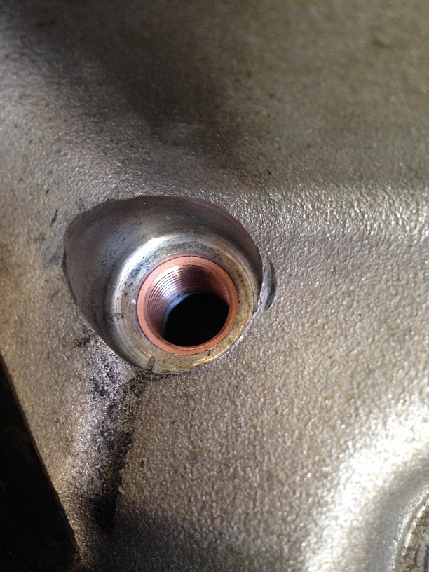

Head off and broken plug still in, no way I was getting that out thread f'kd anyway. So off it went to machine shop to get plug out and a new thread insert put in.

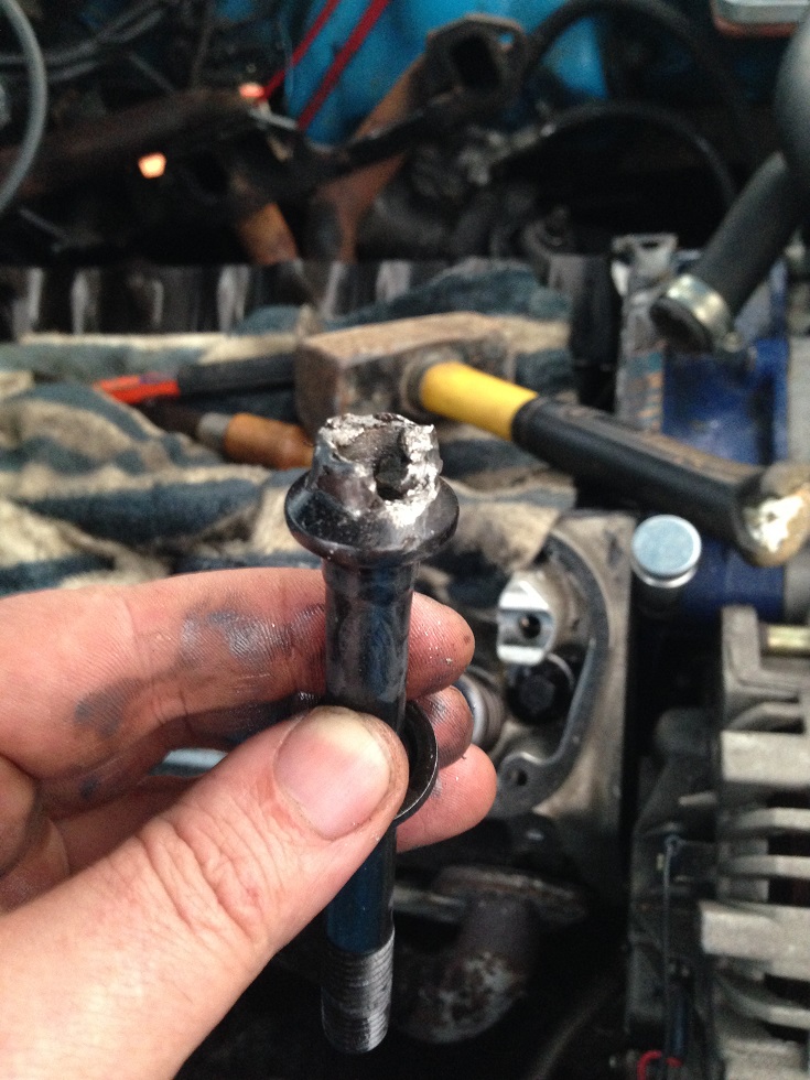

Okay so now I have to do the head gaskets, not a problem. Have to do both sides so off comes the other head, but not quite that easy, which it wouldn't be coz its me.
Rounded off head bolt no way can I get anything on it, out comes the drill. Lump hammer and cold chisel sorted that out.
bolt out.jpg (250.33 KiB) Viewed 3164 times

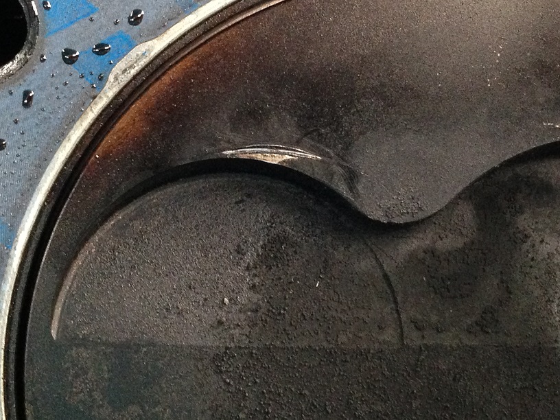

Heads off now, and what do we have here? A bit more damage than first thought, Piston Bananarama! the valve. This happens to be on one of the cylinders the rocker got damaged.
As blue pointed out on a different post with this pic, something don't look right.

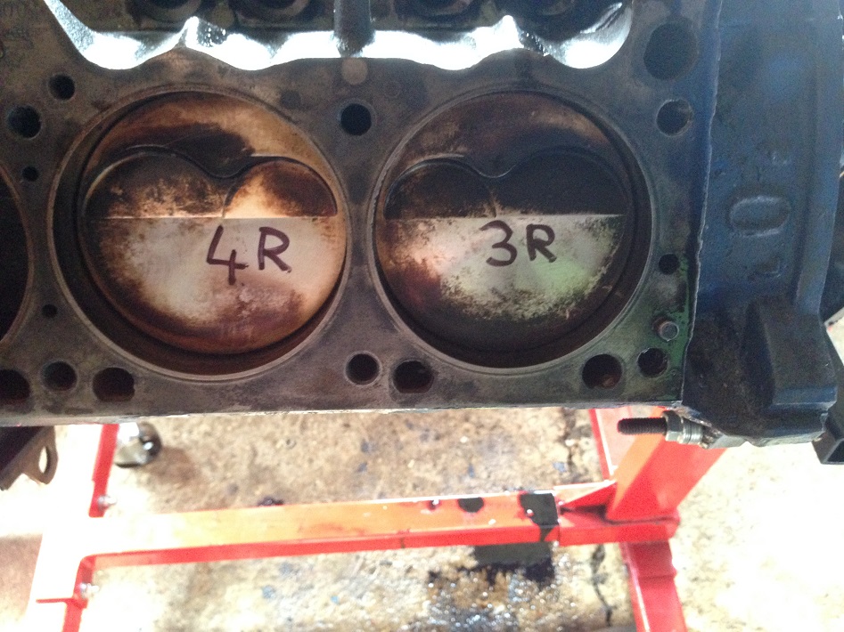

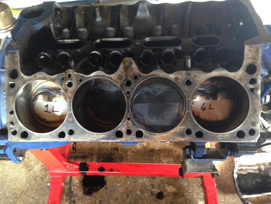

A closer inspection was to reveal all. 4 Bloody pistons have been put into the wrong cylinders, 2 on each side. The piston reliefs are on the wrong side to the relevant valves, the larger inlet valves are trying to fit into the smaller exhaust valve relief. (Some engine builder he is) All 4 have contact marks on the pistons.
The Keen eyed amongst you will see the deliberate mistake. 1 and 4 need to be swapped over I have pre marked them to the cylinders they will be swapped to. The exhaust reliefs should be at the far ends of the head, not the inlet as they are in this pic

And on the right side.

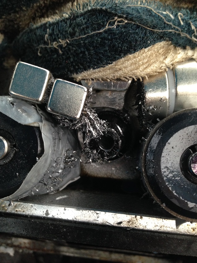

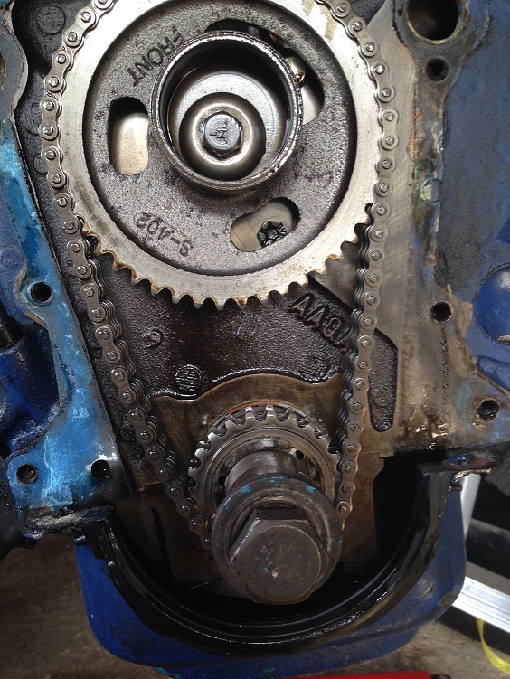

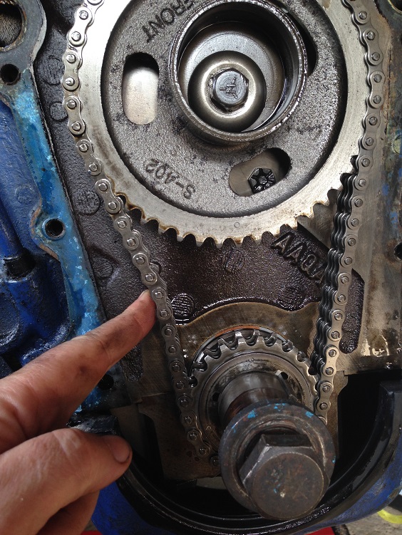

And whilst stripping the Engine I came across this. Im not too fussed about the chain coz if I change the cam it would be wise to replace the chain anyway.
*MMA-609*
