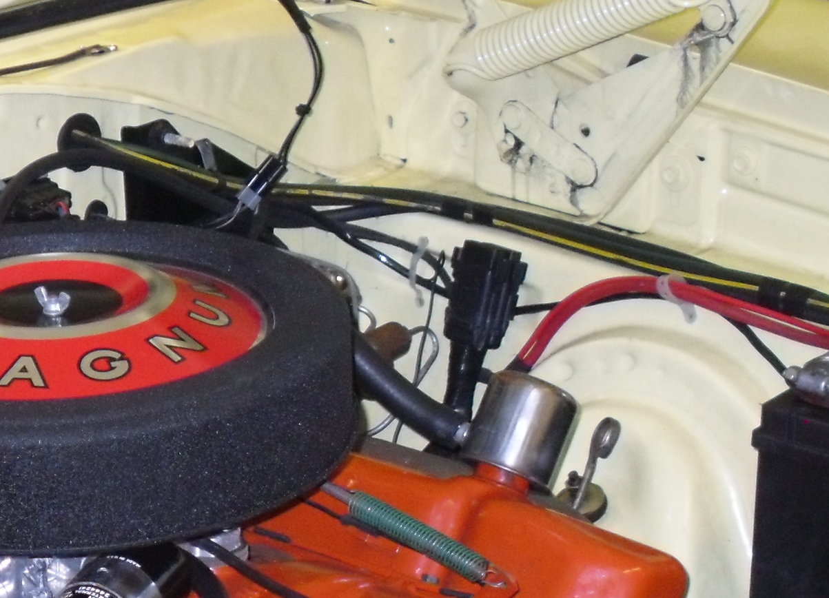

, with out getting into a long drawn out answer , & me making something sound more confusing than it really is :( :lol: :? , :sleepy2: , as your factory wiring set up is prolly different to a 68/69 b-body with a rallye dash , in a nut shell on mine , removed the red & black wires that run to the amp meter completely ,
run a 60 amp wire from alternator to starter relay via a couple of 30 amp maxie fuses , then another 60 amp cable to from the starter relay to a junction / small fuse box up under the dash via another 30 amp maxie fuse , from there ran three separate thick gauge ( forget exactly was a long time ago ( prolly 40 - 45amp) to ignition switch , headlamp switch & fuse box & protected them each with 15 amp fuses , this is in addition to the factory fuse box set up , have wired in blade fuses else where , in the field wires etc too .
did originally think about using the midi fuse set up , but went with the maxi blade & standard in the end , for me less agro , to change if fuse blows :oops: ,
may well change this slightly sometime , seen new products come up for sale , that wern't available on the aftermarket when I done mine
picture below , you can just make out the maxie fuse holders on the driver side inner fender , by the master cylinder
