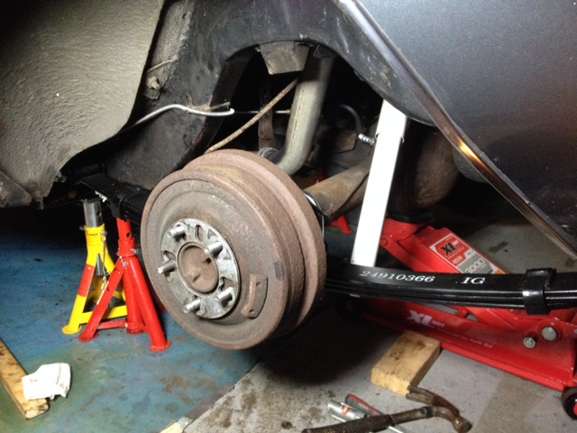

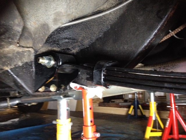

conclusion. Very smooth. Cant fault it... Had to re-do one side to make sure u-bolts were 100% straight, but no hassles.
Not driven, but the bounce test suggests much MUCH firmer.
Expensive, but seem good quality and fit. Pics for those who care...
photo 3.JPG (138.69 KiB) Viewed 818 times

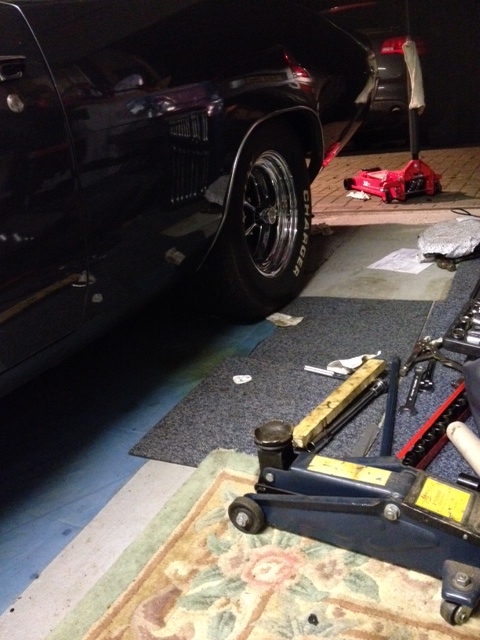

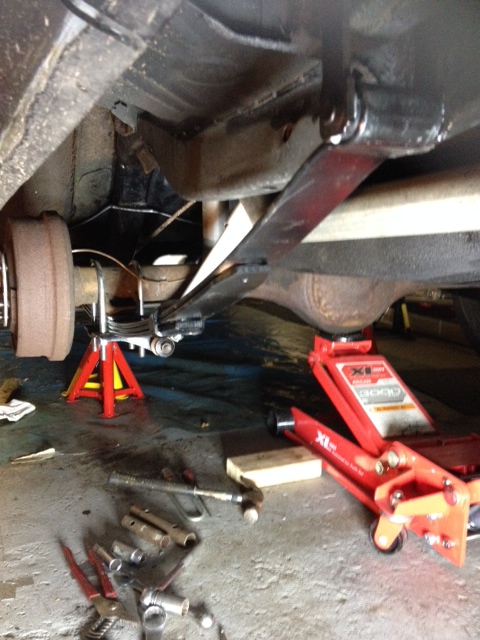

Posts: 4226
Ride height. Not ideal pics, but seems quite low (apparently 1" under stock). Looks OK though.
photo 5.JPG (105.35 KiB) Viewed 815 times
photo 4.JPG (139.93 KiB) Viewed 815 times
As long as you still have a very slight rake it will look cool. Or should I say even cooler. :thumbright:
Ride height looks great to me Morgan :thumbright: At least the wheelarch isn't above the top of the tyre, which to my eyes, is when they start to look ridiculous :roll: :lol:
Great job :thumbright:
