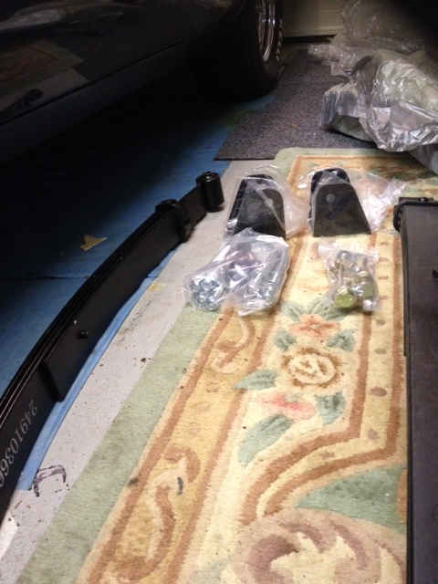

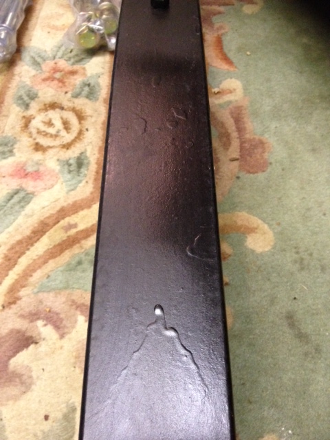

First impressions OK, seems to come with everything you need to fit (bushes, ubolts, grease, hangers). Finish seems a bit rough and ready (see pic3) but then I suppose its only a spring - get a grip Morgan...

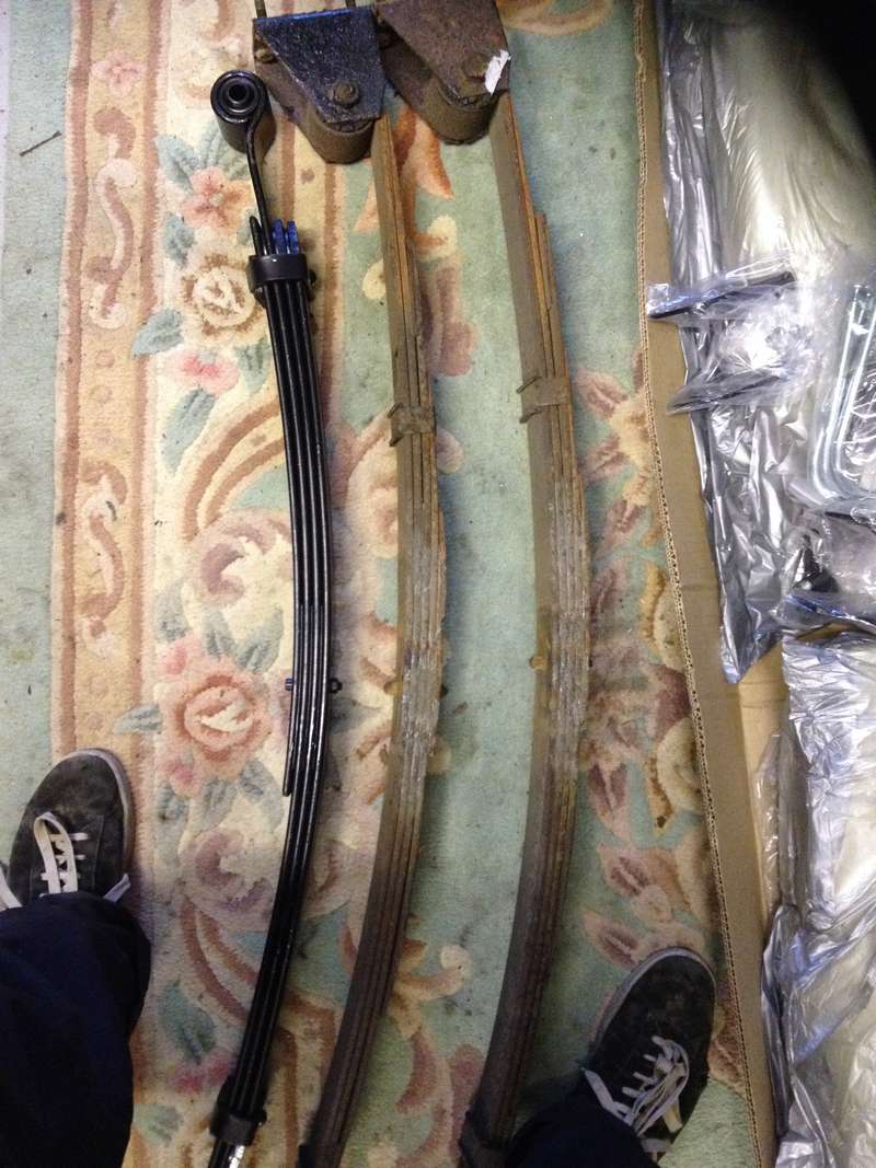

Pic2 is interesting. Geometry correcting seems to mean 'Drill the mount off centre' which is why I guess they ride 1" under stock height. I presume I could fit it upside down and go for the jacked up look :geek:

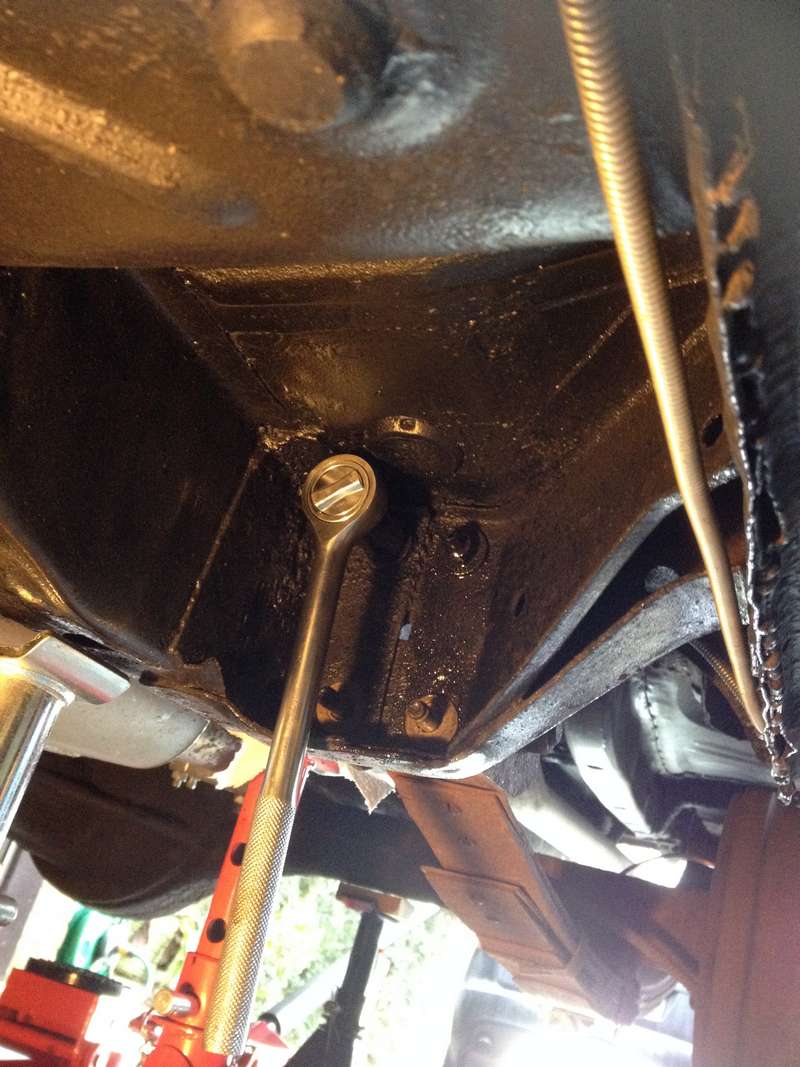

Front hanger came off nice and easy - no great shakes.. Rear was trickier, but 30 mins max.

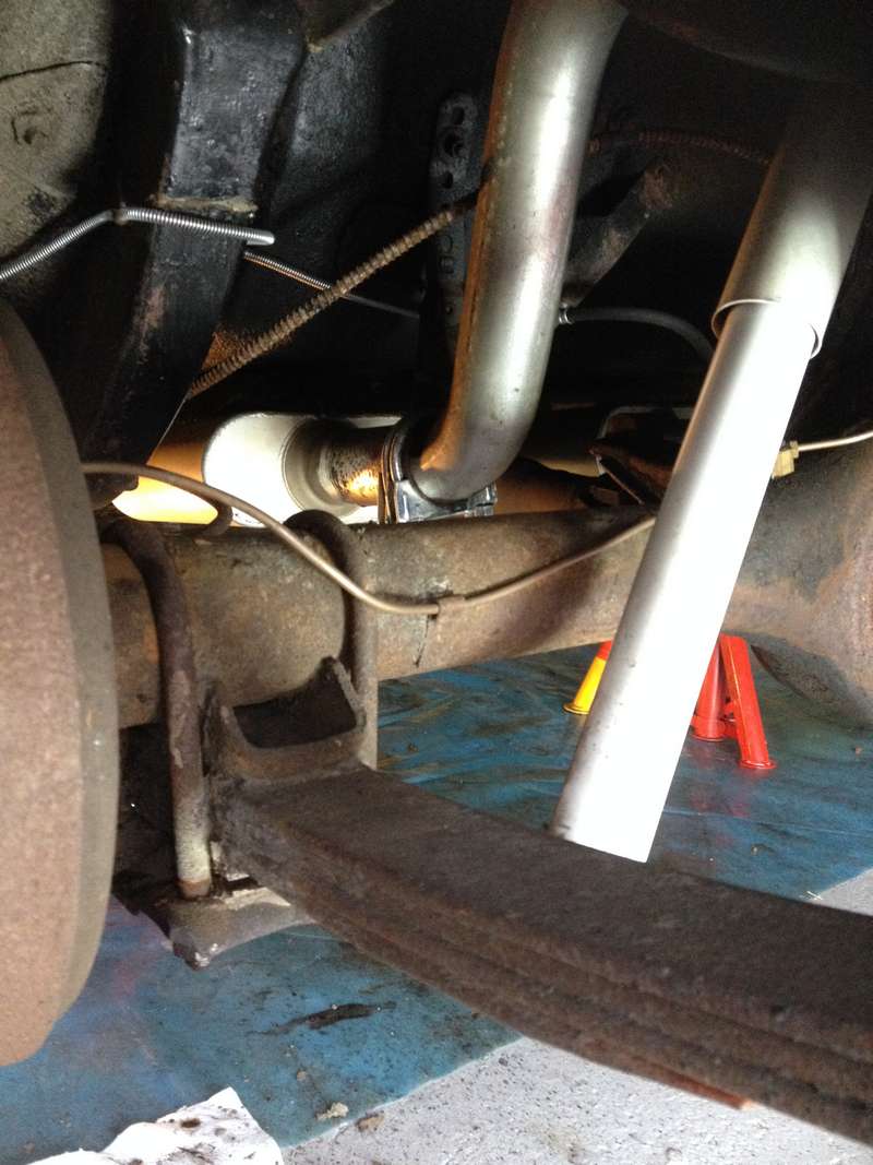

Rusty old u-bolts. Surprisingly, with a bit of heat, WD40 and 'the persuader' they came off. Then I got bored and cut the rest off.

Close up of the old/new springs. Quite different. Notice as Blue says the eye is aligned different too.

if you had orginal mopar U bolts they would have been flattend round the base of the U to help stop crushing the axle tube and had a waffle pattern to help grip....
i.e quite good
whether that outweighs the benefit of some nice brand new ones i don't know.....Probably not, given the age...but chrylser obvioulsy put in a bit of time and effort with something as simple as a u bolt...
