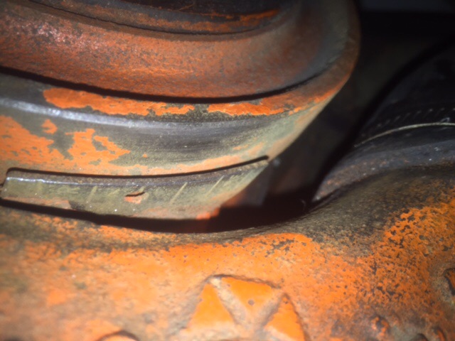

Ok so went out to have a quick look for timing marks, haven't found it on the pulley/balancer yet. It's all been painted over. It took me about 25 minutes to sand/wirebrush the paint off the plate.
Can someone please advise me. On those I can make out an 'R' which I presume is retard, I presume the notch with the hole is '0' and the other side is advance is that right??
Next how much timing is each notch??

They look about 5 degrees to me. 1 degree is about 1/16" so measure them and you'll know for sure.

I'll try measure them tomorrow, its very awkward to get at. Plan on doing a little work on it tomorrow.

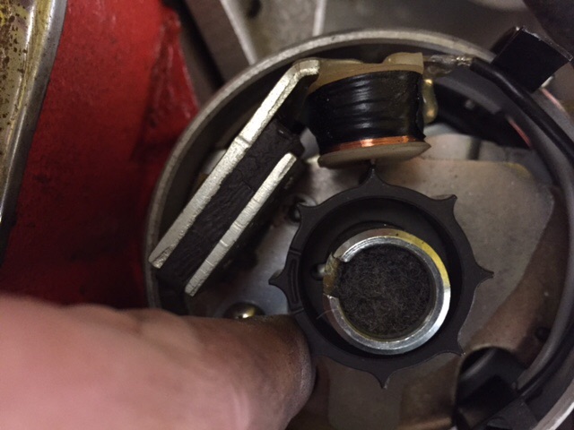

Ok folks timing light arrived today and I'm starting to feel better. Just came out to spend and hour on the car and checked dwell first. The dwell was 7degrees. I presume it's neg at coil and battery positive to measure, never had much cause to use this function before😀.
I presume I adjust the point gap on reluctor below top rotor arm to adjust the dwell?? Anyone know the correct gap for 383. Google says 30deg dwell is that correct

Measure with the positive and one side of coil is showing 44,
Can't get the 0.015 feeler gauge in the gap on points.
Mick70RR
Posts: 1885
Location: Birmingham
Post by Mick70RR »
That gap should be 8 thou. You don't use a dwell meter with electronic ignition.
