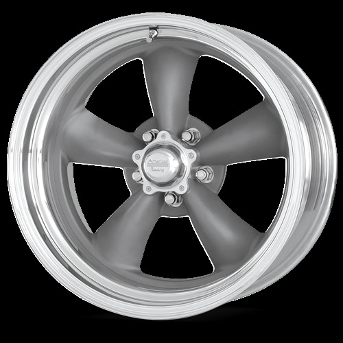

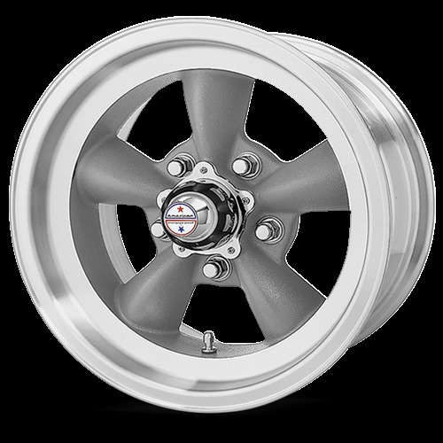

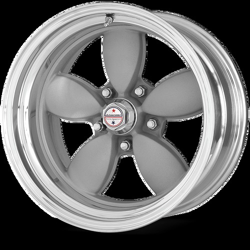

think any of these wheels below , would suit your charger ! :thumbright:
pictures from American racing wheels website
http://www.americanracing.com/
