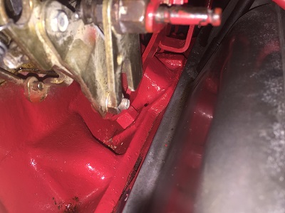

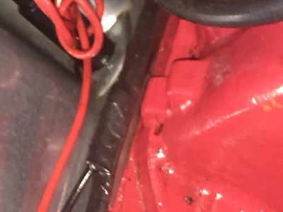

Take the rocker covers off and look for tell tail oil leaks on the basket face. I had one at the rear of the rocker where you couldn't see it. I had to use gasket seal to get it right but the leak stopped.

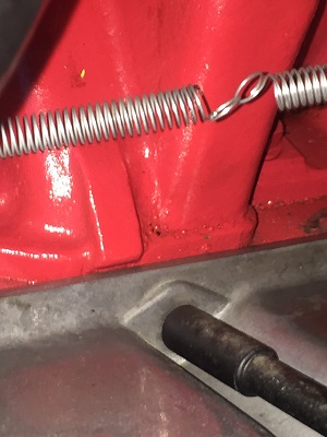

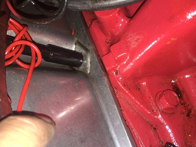

Blue wrote:A problem I have found with cast covers on small blocks is they often hit the intake manifold and therefore don't seal correctly. Have a close look at where they pass the intake runners. if you can't see a definite gap then chances are there's no clearance. If the intake was coming off you could grind that for clearance, otherwise grind the covers or double up the gaskets by evo sticking 2 together before you fit them. I had this problem on both my 318 and 408 with 3 different makes of cast cover and 4 different intakes so it's clearly commonplace.
:iagree:
I had this issue and resolved it as Blue says by stacking two sets of rocker cover gaskets rather than attack anything with the grinder. I used rubber gaskets stuck to the covers with a second set of Cometic gaskets which I bought from Turnip as they were a good thickness giving the necessary clearance between intake and valve covers.
..... so it appears that Blue has found something that I never would've and I would have gone mad trying !!!
Eliminated the PCV, Eliminated the dipstick and took a look at how the rocker covers were sitting compared to the intake manifold and as far as I can see, they are snug up - meaning that no matter how tight the rocker covers are turned down, there is always a chance they are now not compressing correctly ...... to say I'm feeling better is an understatement - now to go about fixing the problem ....
Can anyone point me in the direction of a suitable set of gaskets for my 340 ??
Should it turn out to be correct that they were leaking, do I discard the old ones or can I use them in the "sandwich"
Thanks Garp
