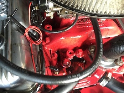

pooling behind water lines under carb'

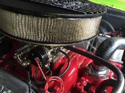

oil patch on air filter

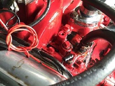

pools around the blocked studs ????
Bloody mess !
Bloody mess !

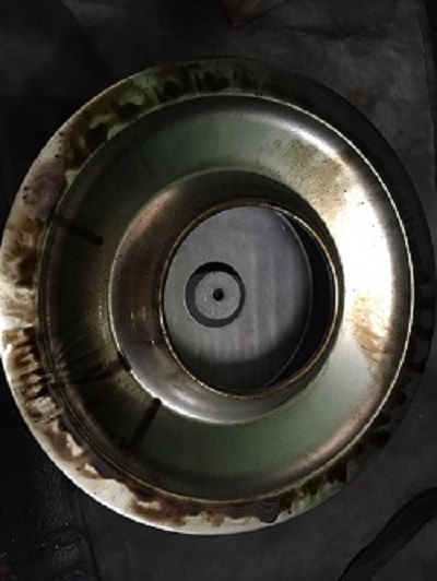

underneath of air filter

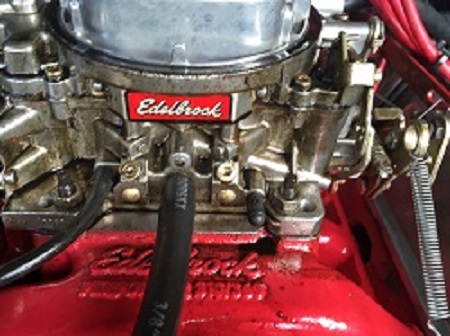

breather hose line to base of Edelbrock
