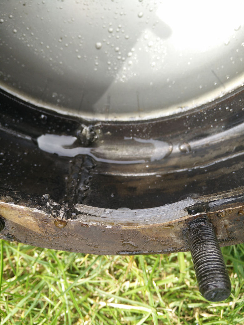

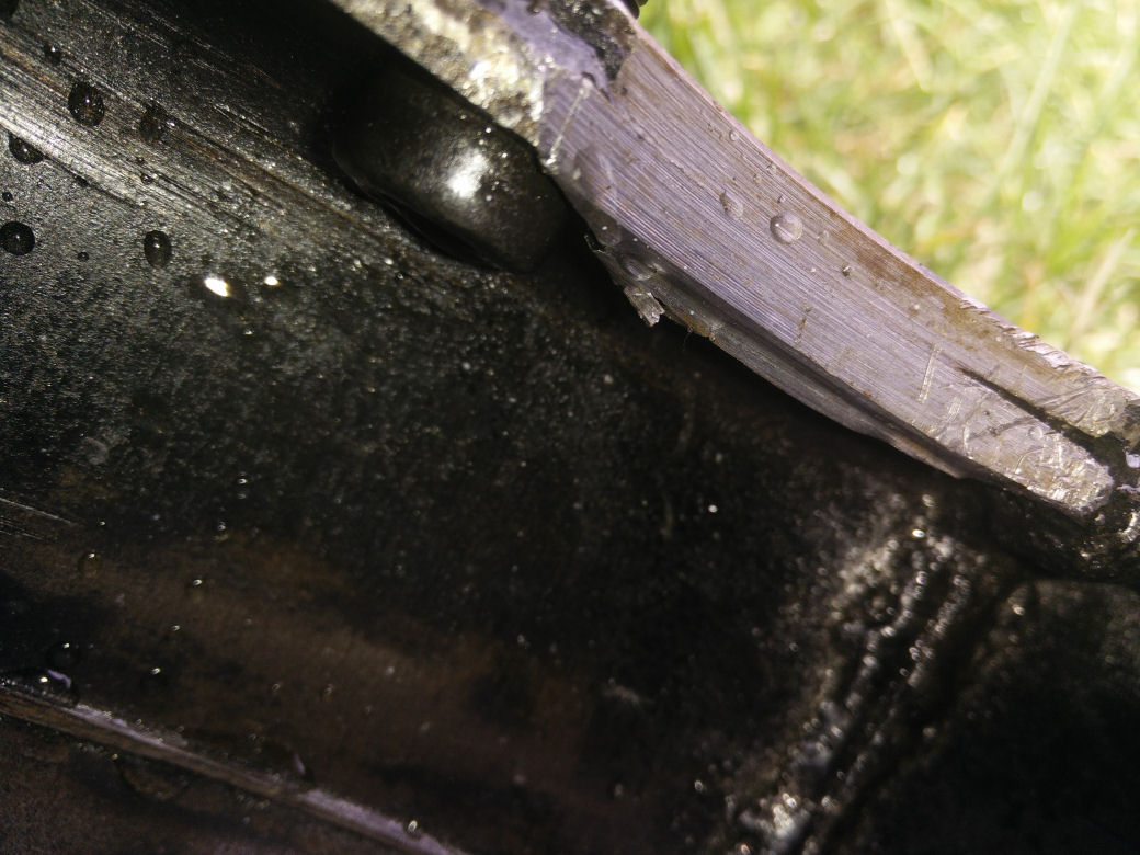

So maybe I missed the wood for the trees, I looked at the axle today...
GJUK
Posts: 2486
Post by GJUK »
Re above - I have no idea what has caused that, looks fresh though and lots of burrs on the inside.

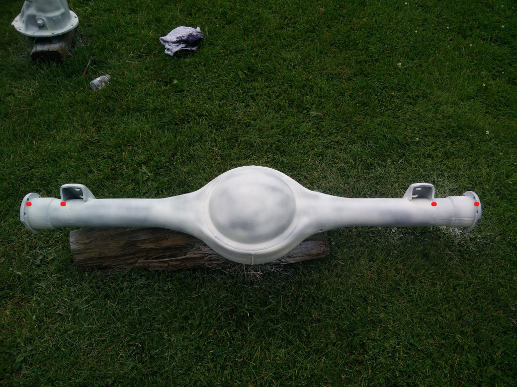

Also, axle perches - are they meant to be equal distance from the edge of the axles? (between the red dots marked)
It sat level in the car but the spring hangers appear central so I don't understand why these are not...
