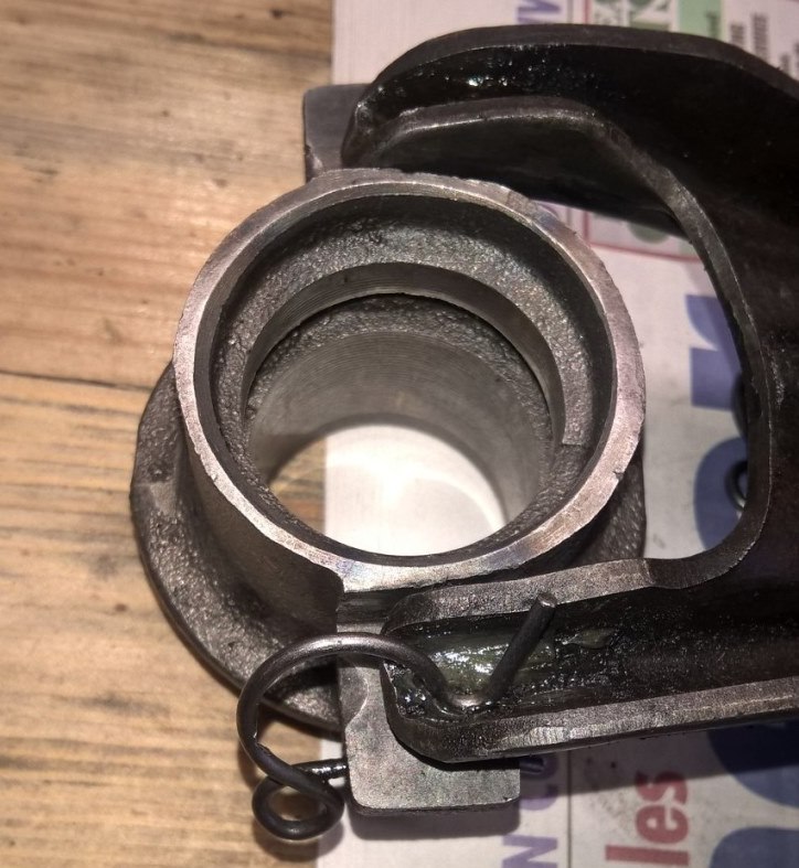

New bearing arrived today from Mick. Thanks man :thumbright:
The arm is too long from pivot to fork ends- pic 1 is where it should sit, you can see the wear marks from where it's been. That's why the spring broke, the 2nd spring is half worn through too.
Pic 2 shows where it was. I'll either need to shorten the arm, move the pivot, or replace one or both. I also now need two springs!
Brewers do a pair for $10.
Clutch bearing 02.jpg (175.78 KiB) Viewed 1344 times
Clutch bearing 01.jpg (170.84 KiB) Viewed 1344 times
Looks like you have the wrong arm and/or pivot bracket. There are several of each, some are engine and body specific.
