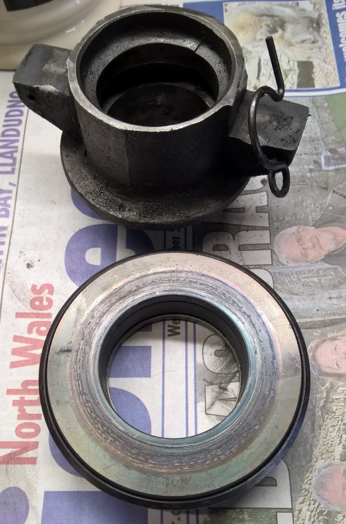

This does not sound good :(
Last time out I drove it a couple of hundred miles with no issues. I played a bit but never caned it or used the nos.
I just took it down the drive to go pick up the kids from school and as I'm creeping along the driveway it starts squealing like the fanbelt is slipping.
I pulled out onto the road with a little more throttle and the sound suddenly became a horrible metallic screeching, very loud!
Back in the garage now, I need to investigate so what's the most likely cause do you think?
If I turn it over by hand it sounds like a metal - metal squeak. The engine seems to turn ok.
I'll go pull the plugs now and turn it again.
I'm thinking either clutch/ flywheel, or maybe it's turned a crank shell?
Do I drop the gearbox or the sump first?
I assume you've taken off the belt to eliminate the alternator and water pump?

Fanbelt is off, squeal is still present.
Slack of me but in my flustered state I didn't look at the oil pressure. Now I daren't start it.
There's no top end damage I can see and the plugs are undamaged and there's no metal there that shouldn't be.
I'll try it with the clutch released next, then I guess it's off with the sump. Luckily that's easy with no K frame.
Noise still there with clutch released (turning the motor over by hand)
Next it's oil out, sump off :(

Is it the release bearing, check you have correct free play in the clutch linkage.

I've dropped the sump and windage tray and there's no sign of swarf or shiny bits in the oil.

Damper is eliminated from my enquiries, as is the starter- now the sump is off I have a clear view.
Lying under it and turning it slowly, it sounds like it's around the flywheel or rear of the crank.
I'll get a second opinion before I dismantle further.
I do need to drop the gearbox to sort 2nd synchro so it's not wasted effort.
shovelheadrob wrote:Is it the release bearing, check you have correct free play in the clutch linkage.
Rob wins :thumbright:
I don't know if the missing retaining spring affected it or just bad adjustment but bearing is pretty seized.
