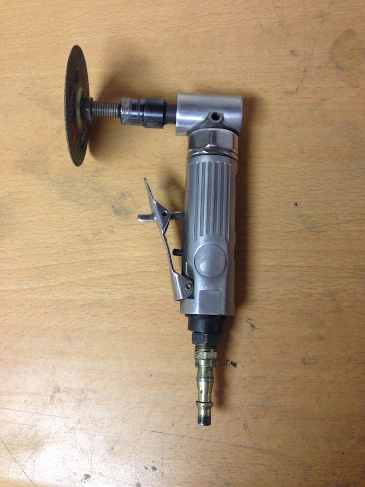

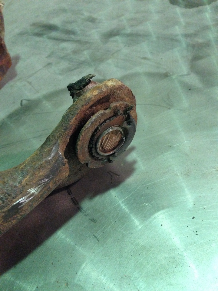

If like me you're unlucky enough to have to cut the cam bolts to get the A arms out, you've got a job on your hands. For a start they are hardened and will instantly blunt any kind of saw blade, and then you have very little room to work. I found a cheap right angled die grinder with an arbor to take a 3" cutting disc the only tool I could get in there, you need to work slowly and patiently to avoid cutting through anything other than the bolt, I only cut one knuckle :roll:

Have some cam bolts if you get stuck.
Richard. :) ps don't forget it's supposed to be your retirement project. :lol:
Blue wrote:If like me you're unlucky enough to have to cut the cam bolts to get the A arms out, you've got a job on your hands. For a start they are hardened and will instantly blunt any kind of saw blade, and then you have very little room to work. I found a cheap right angled die grinder with an arbor to take a 3" cutting disc the only tool I could get in there, you need to work slowly and patiently to avoid cutting through anything other than the bolt, I only cut one knuckle :roll:
Dont get me started , sometimes I would rather pound sand ;)
