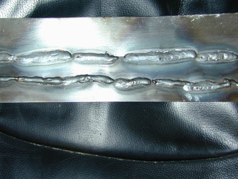

Anyway, with that done back to the car. I haven't used the MIG for probably 20 years, so I've had a bit of a play about on a practise piece and after a stringy start, got some moderately OK welds that look the same from both sides.

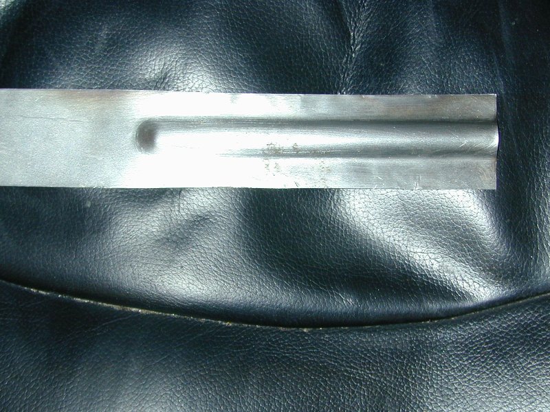

I've also tested a simple tool I made up to press in some ribs where needed and that seems to work OK (with a bit of dolly work afterwards).

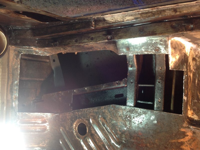

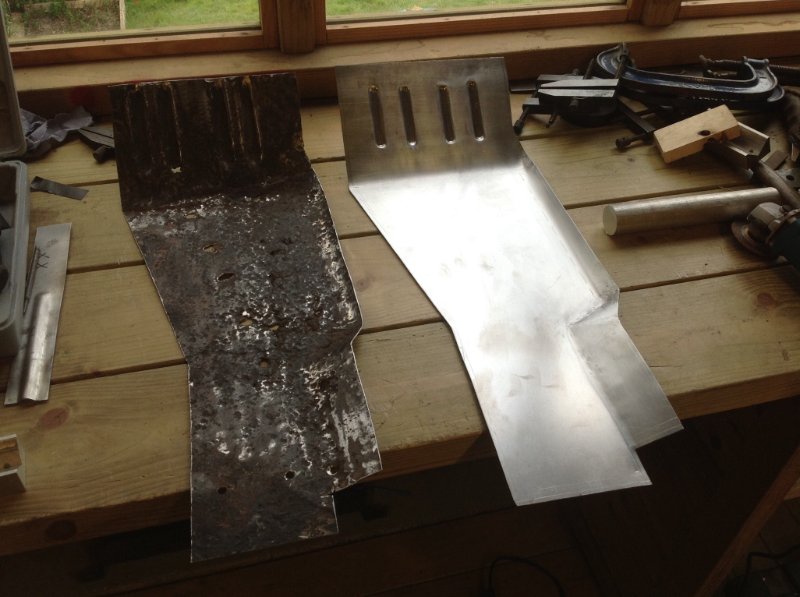

So, that's the bad bit out
Floor 7.jpg (115.85 KiB) Viewed 4030 times

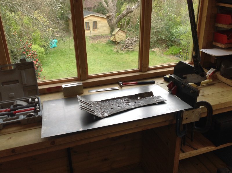

Best make a new bit...
Floor 9.jpg (104.67 KiB) Viewed 4030 times
Re: Dom's 66 Coronet 500
Nice view,very relaxing 👍

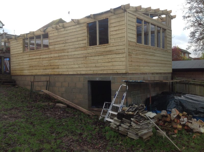

That is the extended version ! Thanks to the slope we're on it's already nearly a storey above ground at the back...

That’s lovely. Room underneath for stuff too👍

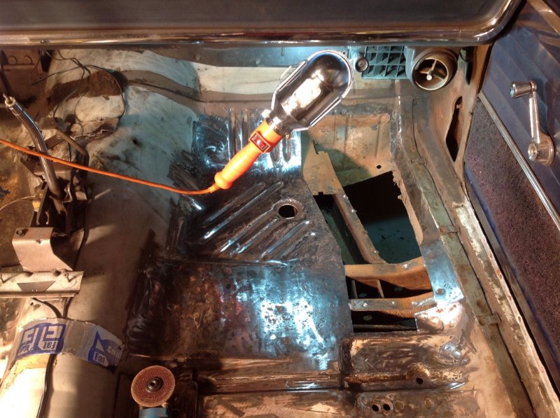

Got a wire brush and some rust converter as far up the exposed sections as I could, I'll hit it with some weld-through primer before zipping it up.
Floor 12.jpg (103.49 KiB) Viewed 3994 times

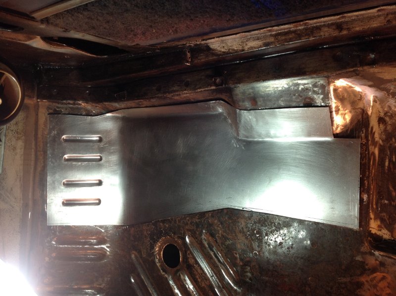

Got pretty close with the new patch...
Floor 15.jpg (74.79 KiB) Viewed 3994 times
It'll just need a final trim to fit.
Floor 13.jpg (96.69 KiB) Viewed 3994 times

Bet that garage was a bit of a bugger to build?

Thank you, not really, I have done it about 50 times in my head after absorbing loads of other peoples resto blogs.
The garage certainly involved more ground work than I'd wanted, but I needed something larger than what was there before...

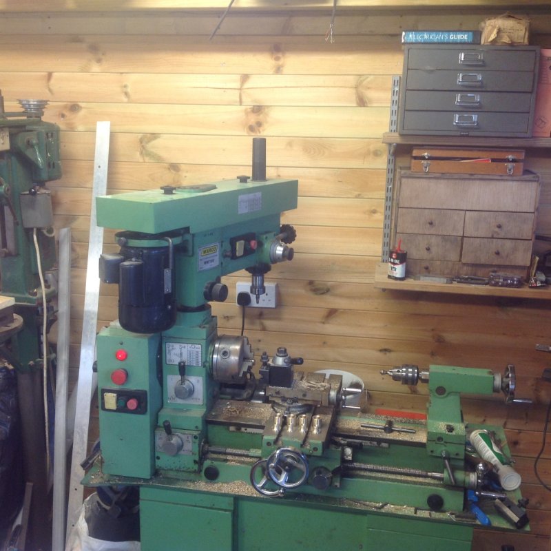

Underneath is a good store, but not quite high enough to stand up properly. 'Machine shop' is upstairs though...
