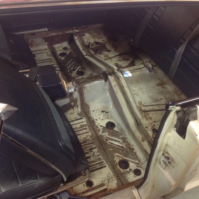

With a bit of time at last, you can imagine it was with some trepidation that I chiselled off the badly fitted, lumpy looking bits of soundproofing from the brown and flaky Looking rear floorpans......result ! A few hours with a wire brush and some thinners and, well I couldn't be much happier right now. I'm sure the front will be worse, but now I have the enthusiasm to find out :)
Posts: 2326
Re: Dom's 66 Coronet 500
That looks very good for her age :thumbright:

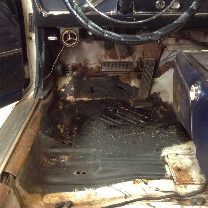

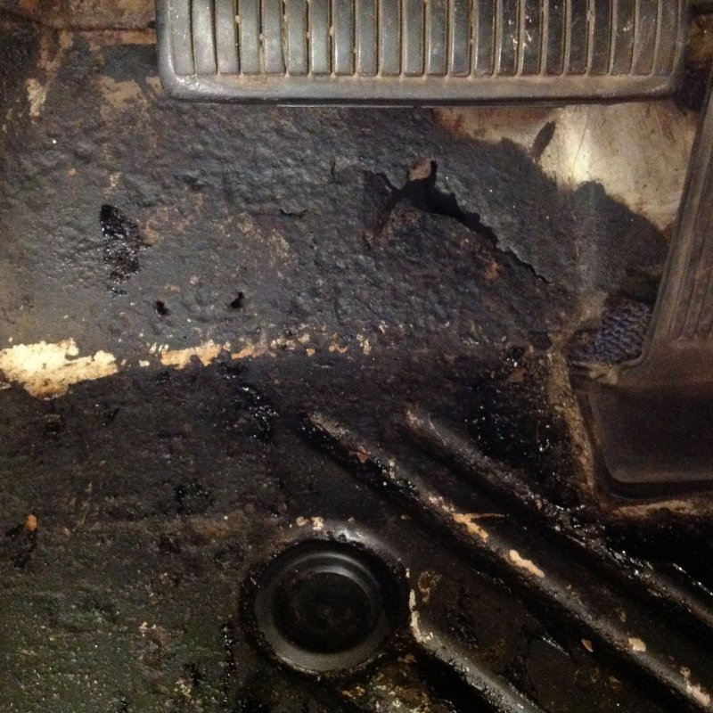

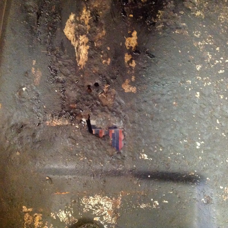

Hmm, Ok, so I've just hoiked out the front passenger seat and scraped that floorpan. Not quite so pretty, but not a disaster. Looks like the welder will be coming out after all.
Floor 1.jpg (121.91 KiB) Viewed 25446 times
Floor 2.jpg (149.09 KiB) Viewed 25446 times
I suppose I should get on to the other side and find out the worst...
Is that actually holed or heavy surface rust? A decent session with the grinder and some POR15?
Posts: 3596
Yeah, the small dark patches to the right are holes.

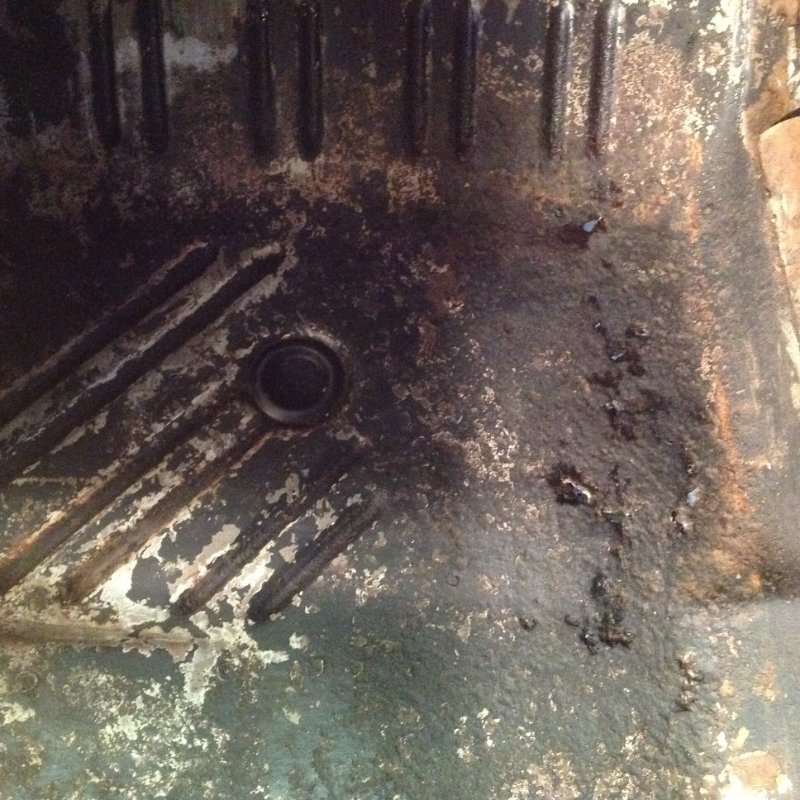

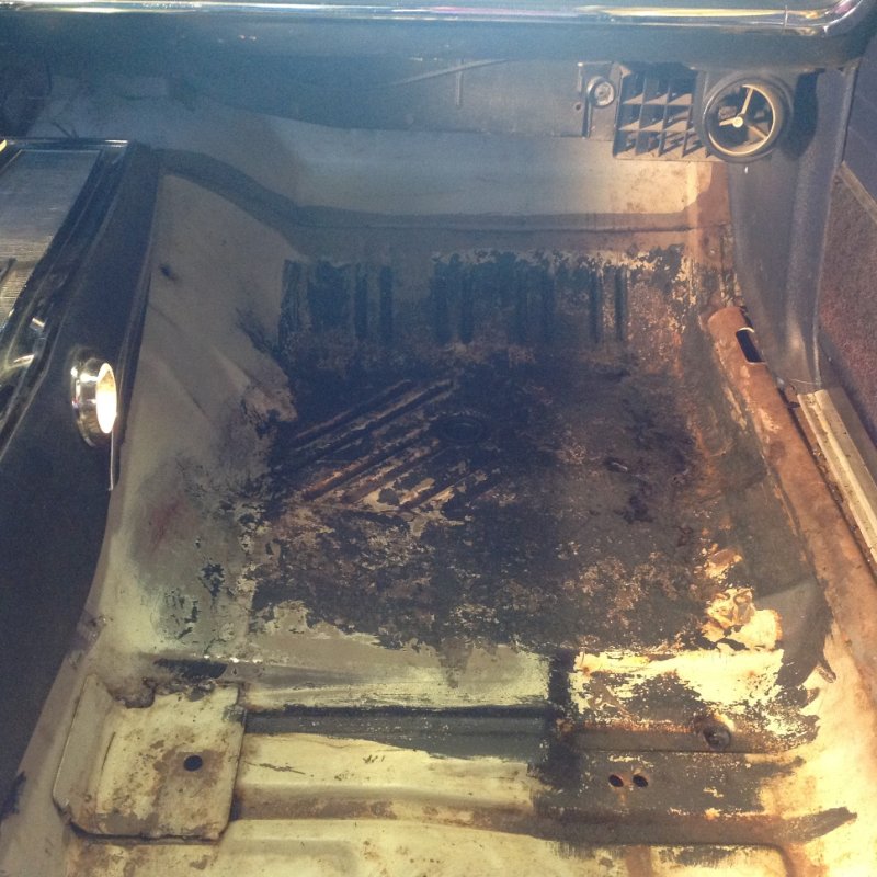

I've done the drivers side now, a bit worse as expected, but really not bad considering...
Floor 3.jpg (123.99 KiB) Viewed 25436 times
Floor 4.jpg (154.08 KiB) Viewed 25436 times
Floor 5.jpg (138.97 KiB) Viewed 25436 times
It looks like someone has used a rust converter on the floor in the past, before 'reinforcing' it with some sound deadening mat :roll:

So, I've ordered some sheet metal and a 3" mini grinder to chop out the rot, hopefully without making too much of a mess. I'll disinter the MIG this weekend and have a practise, it's been a while since I've had to do do any welding other than Arcing 1/4" plate....
The car has mid 70 's Mopar electronic ignition (chrome box), other than the battery, is there anything else I should disconnect before welding on the car ? :help:
Posts: 14457
Personally I would have bought replacement floorpans and fitted those. They are not that expensive and will make a better permanent job of it, it might even be quicker to do. Some of that floorpan although not holed will be too thin to weld and you might be surprised how much of it you end up cutting out. Anyway, your car your call!

I was kind of keen to have a go at making up some little patch panels myself, but if half the floor ends up like a teabag once I hit it with the grinder I'll be reconsidering that.... :geek:

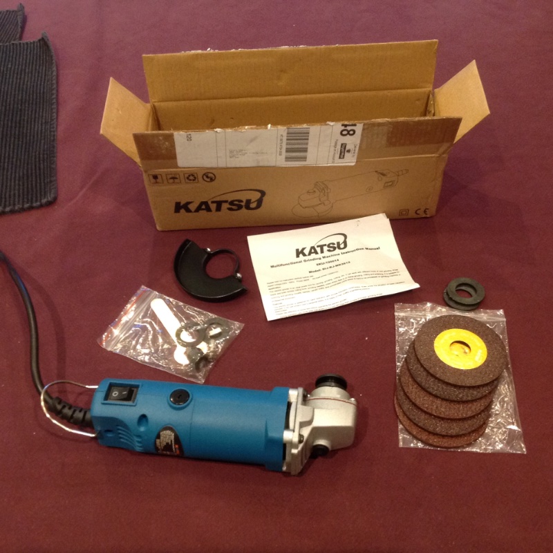

Being currently without a compressor in the garage, I'm without a little cut off wheel. not wanting to lay in to the floor with a 4 1/2" grinder, I bagged a little hand sized 3" jobby, for £23 off EBay I was fully expecting junk, but this actually feels reasonably sturdy ! hopefully good enough for what I need anyway. I 'll report once I've given it a try \:D/
Posts: 9567
sure it will be fine
probably a clone of some makita or Bosch design....
