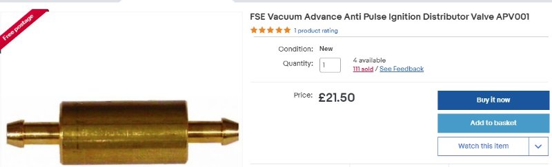

a smoother/ restrictor as used on a alfa sud may work
look up "Vacuum Advance Anti Pulse Distributor Valve APV001"
slows the vaccum can action down so it comes in, on average vacuum rather than pulsing. might help avoid the old problem of loads of degrees getting pulled in every time you touch the throttle

Well, now THERES an interesting thought.
SO (cast you mind back) I have NEVER been able to run vacuum on any engine /carb - I concluded my can was shot. I bought and fitted an adjustable vac can, so I can now screw it right down. Made not a JOT of difference - the second I connected it to the carb BANGBANGCOUGHBANG ! - even on this engine with naff all vacuum. I decided its just not meant to be. (ties in with your 'loads of advance every time you touch the throttle)
I'll dig the 'ol colortune out and make sure I am still blue and lovely. (I was before). Overrun largely cured now I have cracked the secondaries open and transfer slot is visible. So maybe it is time to try again with vacuum. Never made it work yet... But... :think:
Posts: 4265
Re: SMELLY - De-camming for de-smelling ?
Edit - Feels worth a £20 shot doesnt it ? I waste that much every time I drive her without one :)

Vacuum thing you can find em cheaper...
