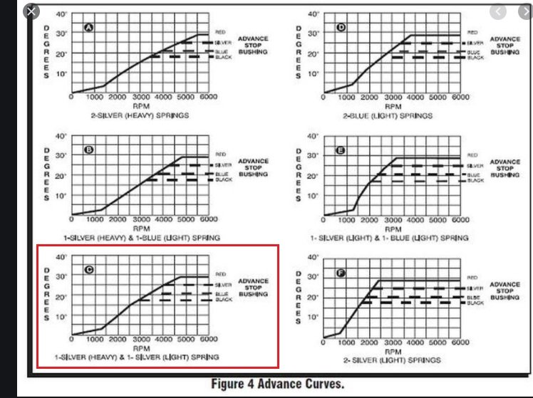

From memory I am running profile3 now with black bushing. (This gives 18 degrees total mech advance at 3,000rpm).
This allows me to set ~16 initial at startup with 34 all in at 3K.
I have an adjustable vac can, but its disconnected. No point. No vacuum.
There are 3 options to bring this advance in sooner looking at the chart. Some of these will bring in a few degrees at idle sort of speeds.
Can be 34deg all in by 2500, 2000 and 1750 by the looks of it.

Posts: 22174
Re: SMELLY - De-camming for de-smelling ?
I would want one that looked like the face of the Eiger.
The only reason you have initial timing is so you can crank the motor without ripping the teeth off the ring gear.
In my opinion, you want to get as much timing in as early as possible without causing drag on the convertor - this is where the trade off takes place.
Don't underestimate the Vacuum canisters - they have their uses, but ironically not how they were intended....
