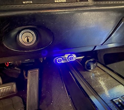

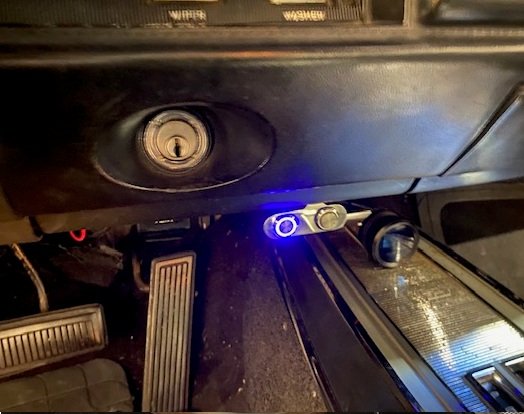

For ref, here is the very natty twin switch. I can control each fan independently; I now know that just one is enough to keep it cool in a queue but I have a backup/boost if I really need it. I might actually put one of them on a temp switch in the hose; I'll still have one for manual backup then. I dunno. Fettling fettling...
