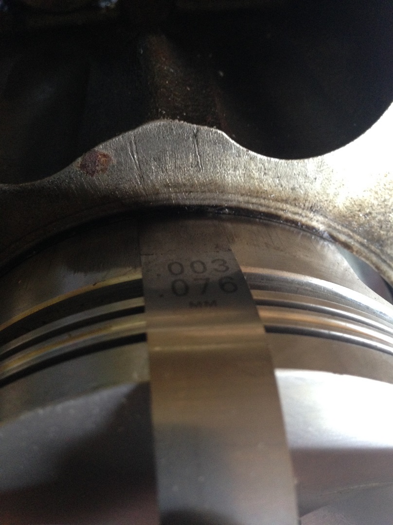

I popped a piston back in today and this is what I found :shock:
All cylinders are around .003 and .004 with one side against the cylinder wall

A few tiny nicks will be fine in a regular street driven motor & would seem to be a good option for a cheap route. A final hone & some rings is cheap in comparison to a new build.
You cant measure bores clearance as you are showing with feeler gauge. You cant beat a bore mic & regular mic for checking pistons & obtaining accuracy. A cheap digital vernier is more accurate than those feeler gauges.
Take up Les's advice & visit a decent engine machinist, take the block & pistons with you. If its a reputable or decent shop, they should be able to advise you & will also be able to measure the bores correctly. They should also be able to advise you the max upper clearance tolerance on Piston to bore, based on actual experiences v Manf stated figures.

Sorry if I'm being dim. But if your showing .003 as pic then isn't that a PTW of about .0025 ? Which was considered too tight ?
Then what is the prob with honing to desired PTW ?

Mossy68 wrote:Sorry if I'm being dim. But if your showing .003 as pic then isn't that a PTW of about .0025 ? Which was considered too tight ?
Hard to tell from the picture, it look as the piston I being pushed against the cylinder wall & the opposing gap is being measured with a feeler gauge. If this is the case, the 0.003" should be halfed, making 0.0015" PTW.
This method of measuring is not accurate, you need to know the if the bore is round, if the piston is round (not that piston are fully round, along their full length) & their respective diameters. This should be done to all 8 pistons & to all 8 bores

Sorry Mark. Meant 0015. Halved it but typed it wrong !!
I understand it is inaccurate however this is still showing the PTW is too tight. Correct ?
If so why could it be a problem to hone to correct PTW ?
Sorry chaps. Just interested. :thumbright:

I did initially mesure the bore and piston with a digital vernier to get measurements of for bore 4.100 and pistons 4.0955 I was just checking the gap out of curiosity, to measure accurately I really need a bore gauge to measure the bore all the way down.
But you are correct mark and no offence taken, the car isn't an out and out race car so my tolerances arnt going to be as critical but at the same time I want it serviceable for my needs bit if street/strip.
