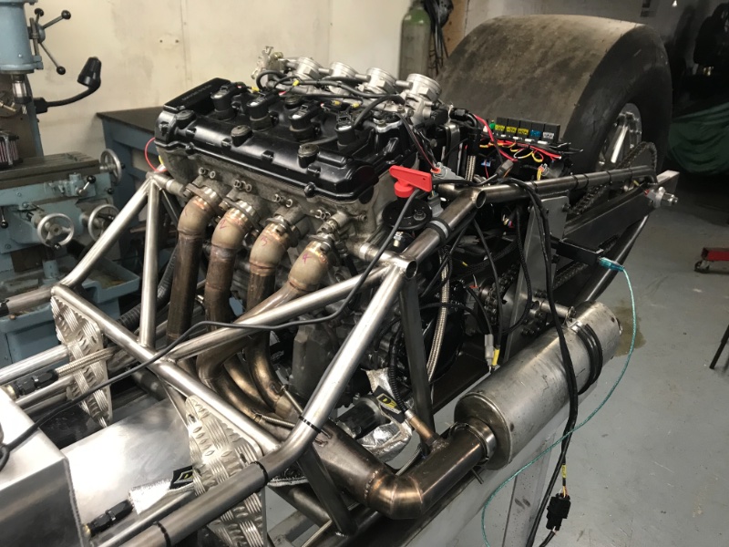

A Bananarama! exhaust fitted just to get me going as the plan is turbo have just thrown it all together.

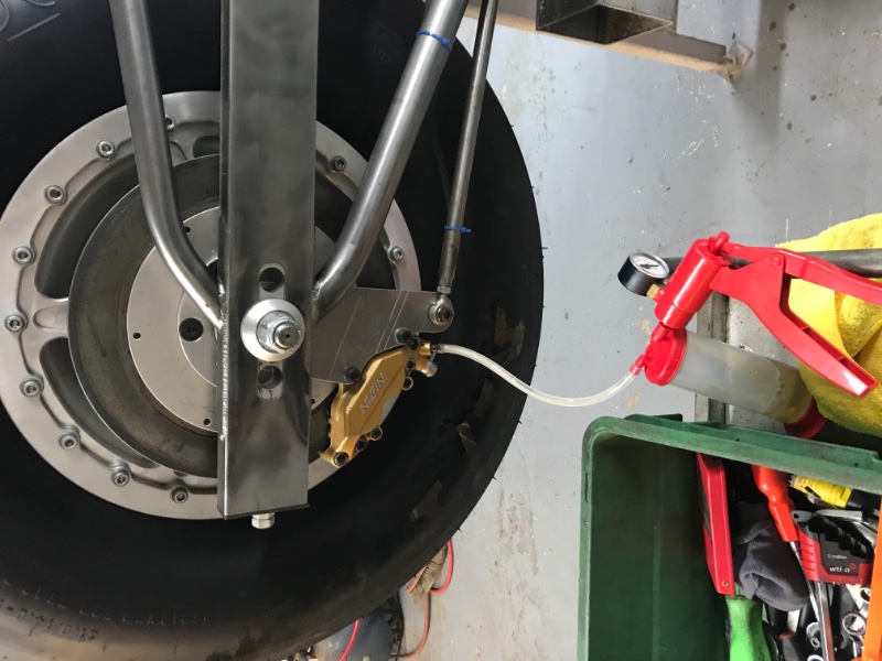

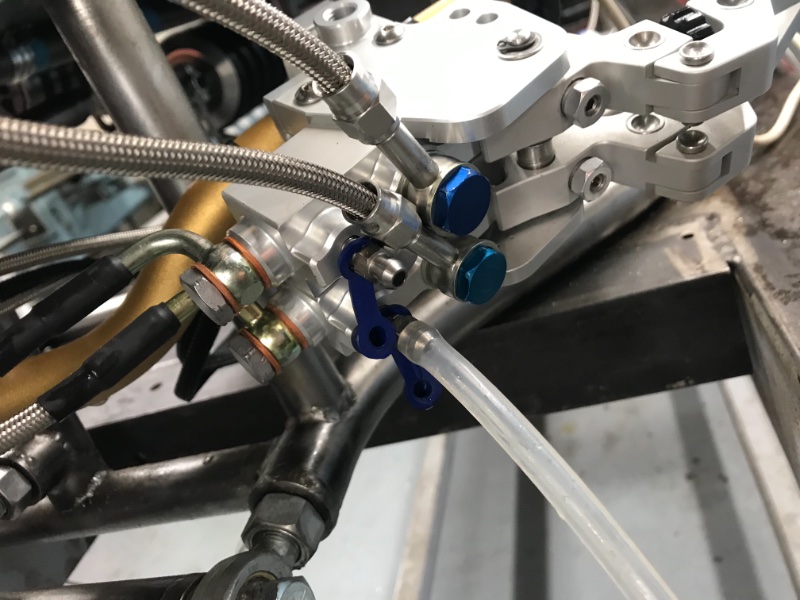

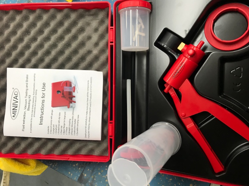

Brake bleeding !

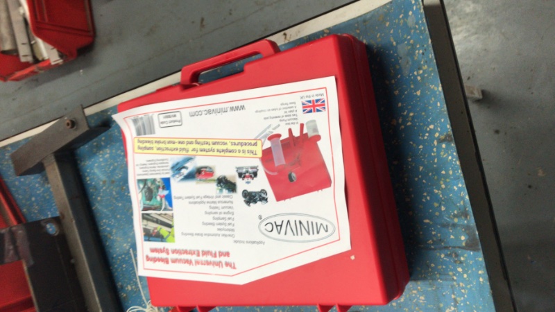

Due to the really long brake lines and very small diameter master cylinder i knew it was going to be a bitch to bleed.
I brought a fancy Vacum brake bleeder to suck it out he nipples. I was hoping to give you an amazing review but i dropped it and the arse fell off the pot. Needless to say it worked great and would have been impossible to do without. This type of system is well worth buying just get a better quality one.
Front brake = Done :thumbright:
Rear Brake = Done :thumbright:
Clutch = Somone has stolen my nipple from the slave cylinder [-( Who Steals Nipples !!!!!!!!!

i've got one of them brake suckers work quite well..... i went for one that described itself as the original got it off US Amazon
i'd be inclined to say the quality is just the same i.e just about adequate and your red one probably came out the same factory as my grey one
just you got a nice case for yours and i got a cardboard box with a blister pack front
i'd guess back when they were invented they were metal and the pots were glass jars in a nicely finished wooden rack with screw on lids..... such is progress

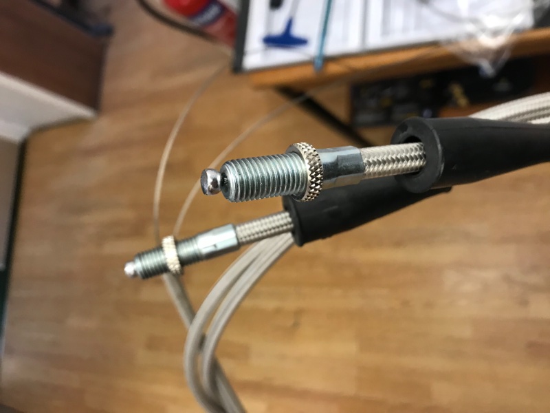

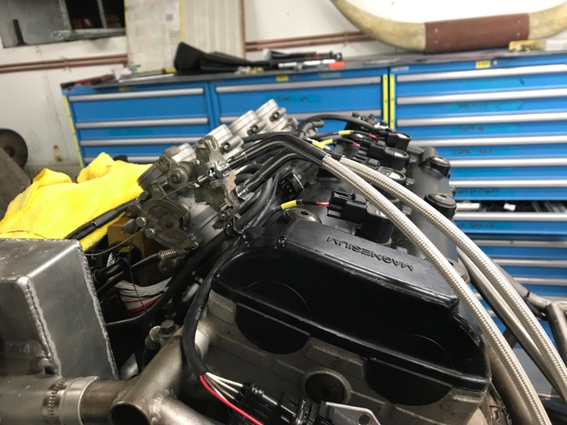

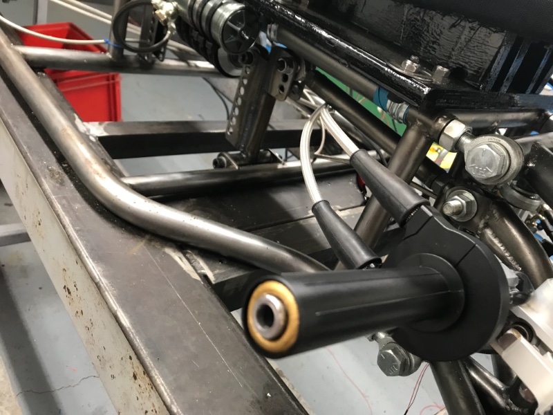

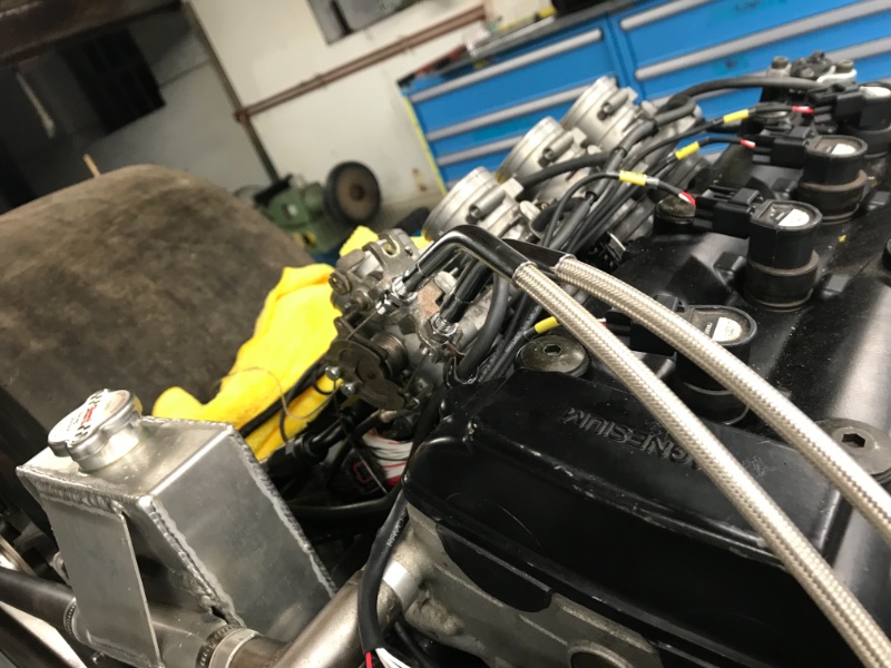

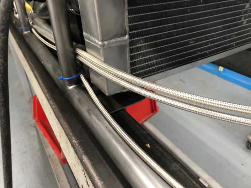

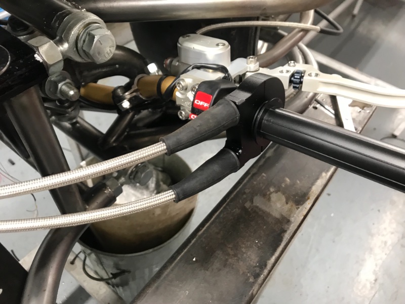

Throttle cables
Painful !!
Due to the length of the cables and the addition friction caused by long cables the butterflies would not close with standard spring pressure.
Addition springs caused a heavy throttle and a little bit to much tension going on near the throttle Bodies.
After a few attempts I got in the car drove to Venhill engineer. The man to see is Martin he is about 12 years old but blew me away with his knolage.
If you need a cable or brake line for anything he will do it !
Ended up with a boat clucth cable connected to Billet pit bike twist grip 8-[

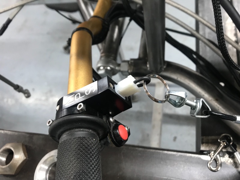

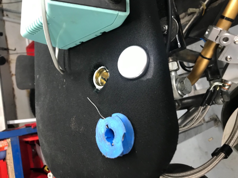

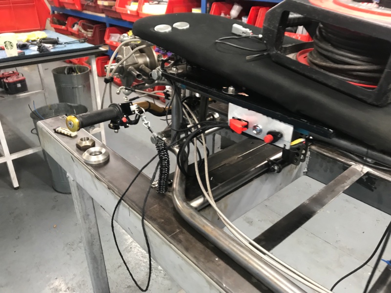

Kill lanyard
The bike has a clever relay cut circuit built in to shut down all power to every system if the lanyard is removed.
The lanyard is a good quality MPS billet drag bike one but I’m told that Santa pod / has / is / might / have new rules requiring the lanyard to pull out from any position ??
Aka - not a straight pull but left right up down ?????
Also fitted a battery isolation switch for crew (you lot) to shut down bike if my feet are on fire.

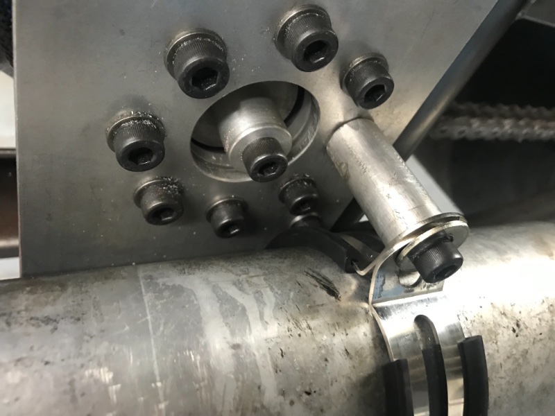

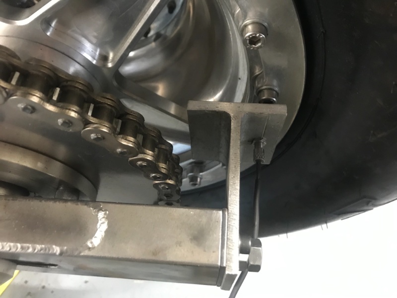

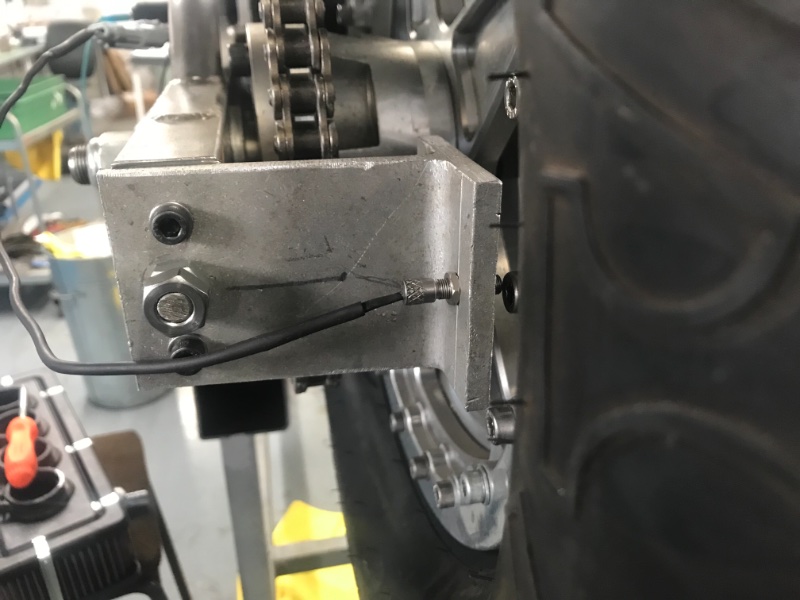

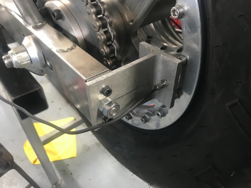

Wheel speed sensors
Mount front and rear wheel speed sensors a little over engineered and heavy and intend to change the rear once I come up with a better mounting solution...
Sensors pick up off the bolt heads

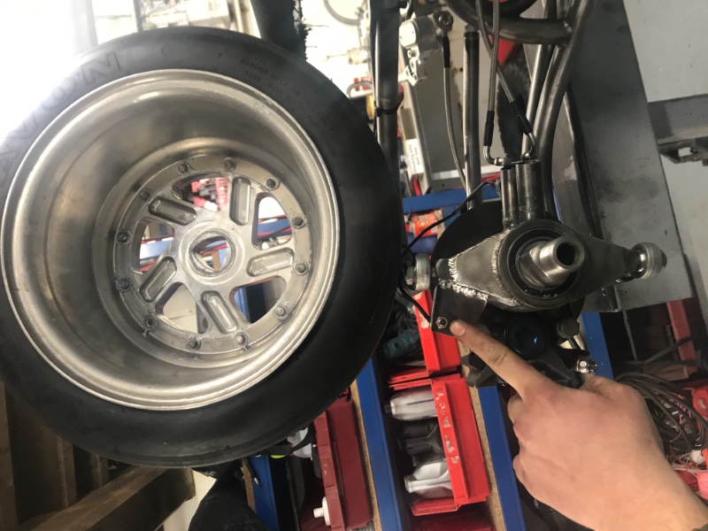

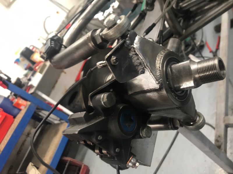

Having a horrible time with the simple operation of pulling the clucth in. From air in lines to wrong clucth heights to shimming to modifying slave push rods.
Calculating slave throw and fluid displacements. It’s all custom and a real mismatch of parts.
