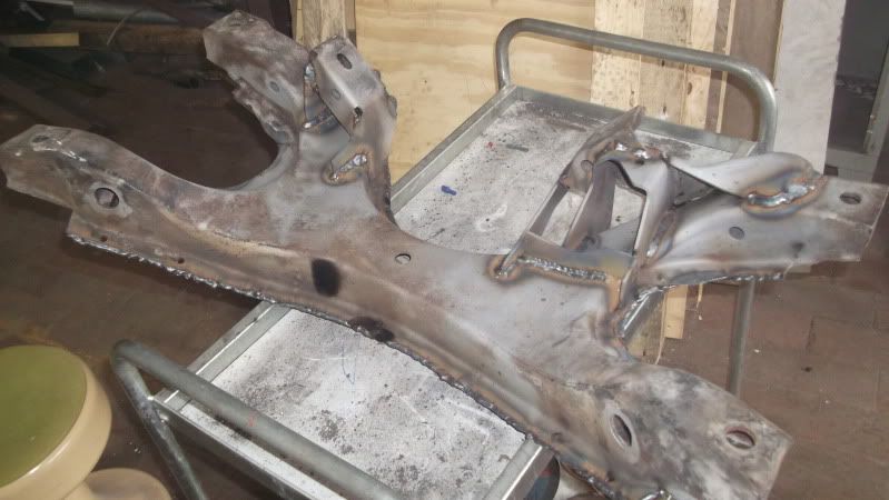

I also welded the other end of the lower control arm where they riveted the ball joint mounting to solidify the end as well and I seam welded the plate that holds the bump stop at the top the secure the top of the control arm.
Another item I seam welded was the k-frame and I also seam welded around the where power steering box mounts to stop twisting. See links below to what I copied.
http://www.firmfeel.com/reinfkfram_b.htm
http://www.firmfeel.com/reinlca_b.htm
Posts: 14459
All well worth doing, the factory welding can be really quite poor, especially on K frames.

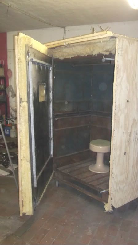

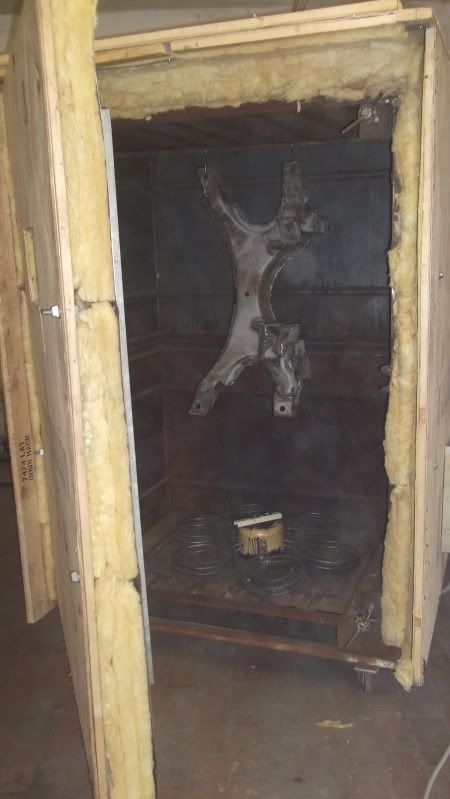

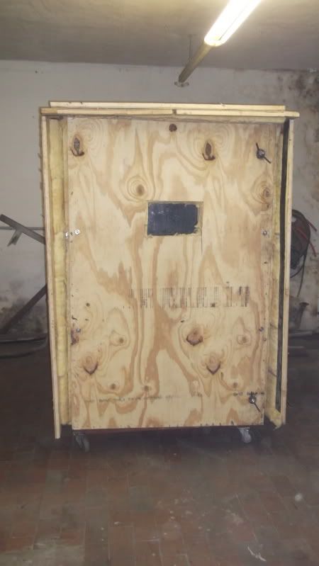

Oven now has 10cm of insulation the roof stuff thats horible Bananarama!
Fingers crossed she make 200°c
And does not tower of inferno on me
<a href="http://photobucket.com" target="_blank"><img src="http://i73.photobucket.com/albums/i205/ ... ure307.jpg" border="0" alt="Photobucket"></a>
<a href="http://photobucket.com" target="_blank"><img src="http://i73.photobucket.com/albums/i205/ ... ure309.jpg" border="0" alt="Photobucket"></a>
Jon Connolly
Posts: 3116
Post by Jon Connolly »
Will
Is it fibreglass ? or rockwool ?
Looks like fibreglass to me ... reckon you will need alot more than that
It is rockwool the translation on the packet was mineral wool ????
I have tryed to melt/burn it with oxy kit and she wont burn.
The metal box inside is air tight eg with metal door fits good.
The bottom does have some holes in but hot air does go up

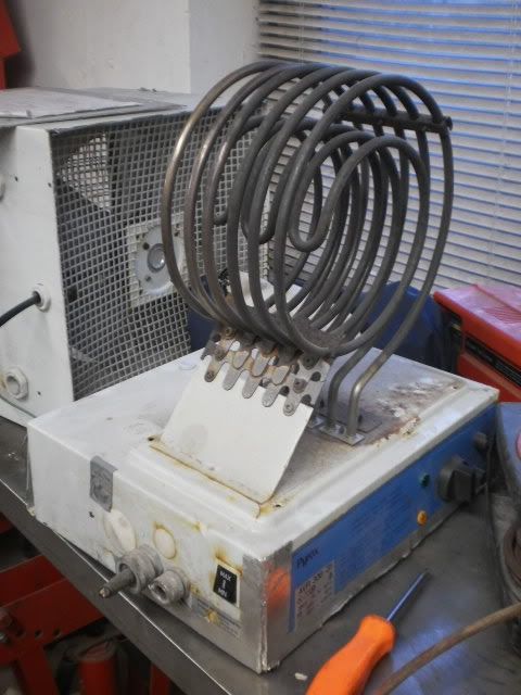

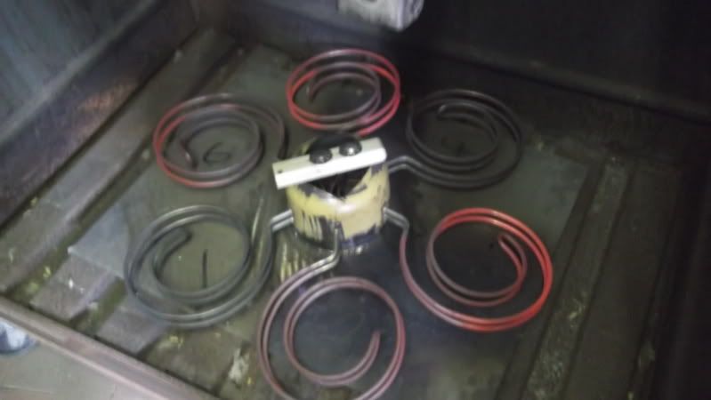

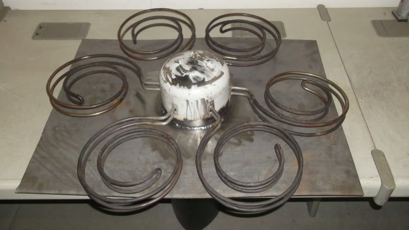

Heat will be 6 x 2kw 3 phaze heating elements giving me 12kw of heat
That i got from some industrial heaters

Oven worked well we had 250° and she was still getting hotter.

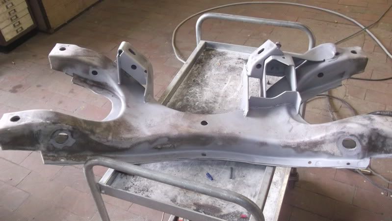

I gave my front axle a little sand blast and then welded all joint together.
On welding i found that oil and grease that was inside the axle started to come out.
So 2hr in the oven at 250°c and it smoked and smoked and all the oil it now out.
welded up front axle next in sand blast and powder coat.

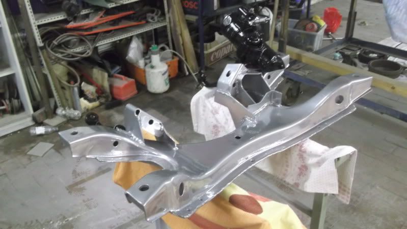

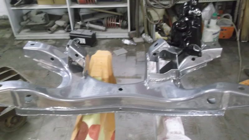

Well this build a car lark is taking some time.
After finding a great guy to rebuild a gear box i final got back to Germany and got the oven fired up.
Powder coated front axle.
Steps....
Sandblasted
Bronox rust/primer High temp
Powder primmer
Powder high chrome
Powder mix of clear coat/chrome/de scratch
Painted parts that i wont bake with Bronox primmer then nitro semi gloss/Matt paint
