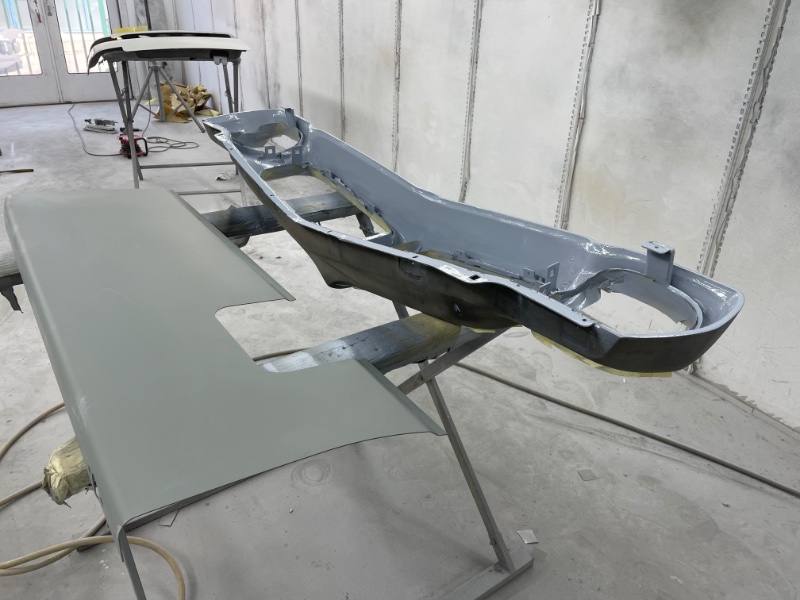

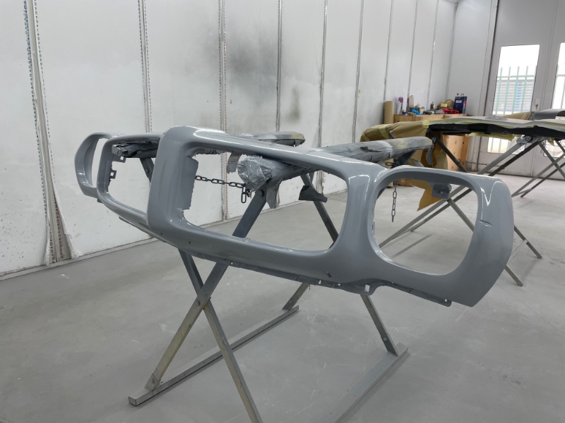

Endura front nose,
Rubbish pic but I’ve got a booth for of other crap

Got some more epoxy on the FireTurd
It’s now starting t look like I’ve actually done something!

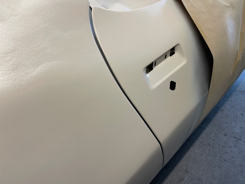

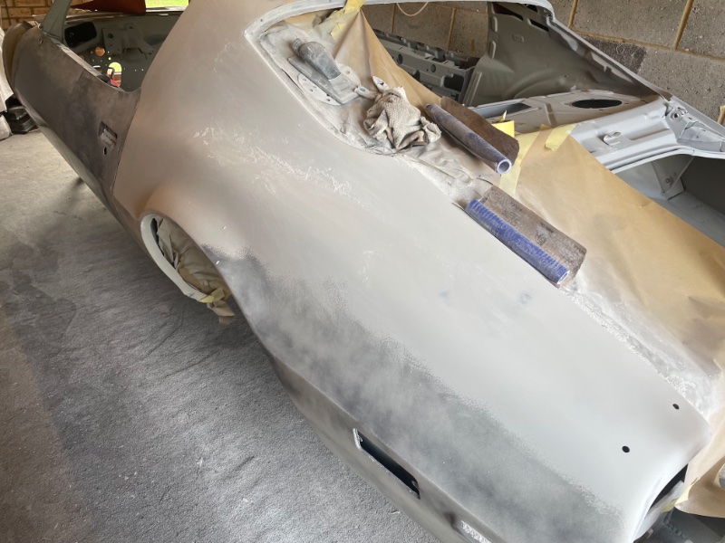

So fitted the right hand door yesterday,
Fitted on really just needed a bit of therapy,
Done the filler work to the right quarter,
Corrected the door and got it in polyester,
Just the left side quarter and roof to prepare now !
Thank goodness!

Gaps look good from that angle.
newsatten
Posts: 304
Joined: Sun May 10, 20 11:41 am
Location: Whitstable, Kent Coast
Re: My very last restoration!!!
Post by newsatten »
Yes for a AMD panel they are not bad, currently at 210 or 5mm, can get them a tad tighter but need a reduced shim on the B post striker,
but plenty good enough for day to day use,
Ive already decided not to be anal with body gaps, im not restoring a show queen, from its inception its always been about getting the car as corrosion free, and as structurally strong as i can,

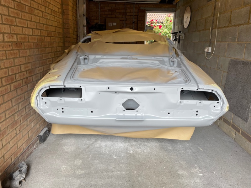

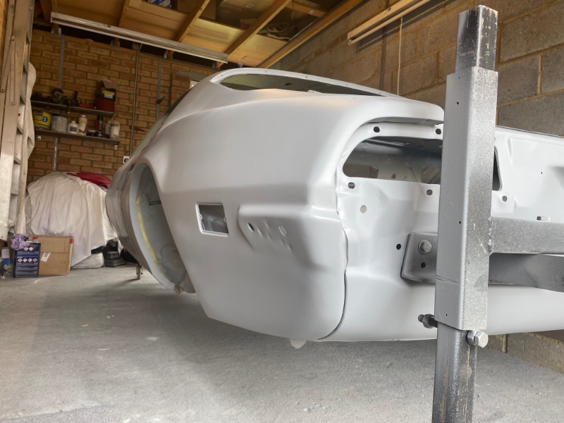

Busy again today,
Managed to get the rear end squared and in primer
Just the left rear quarter and the roof to do now

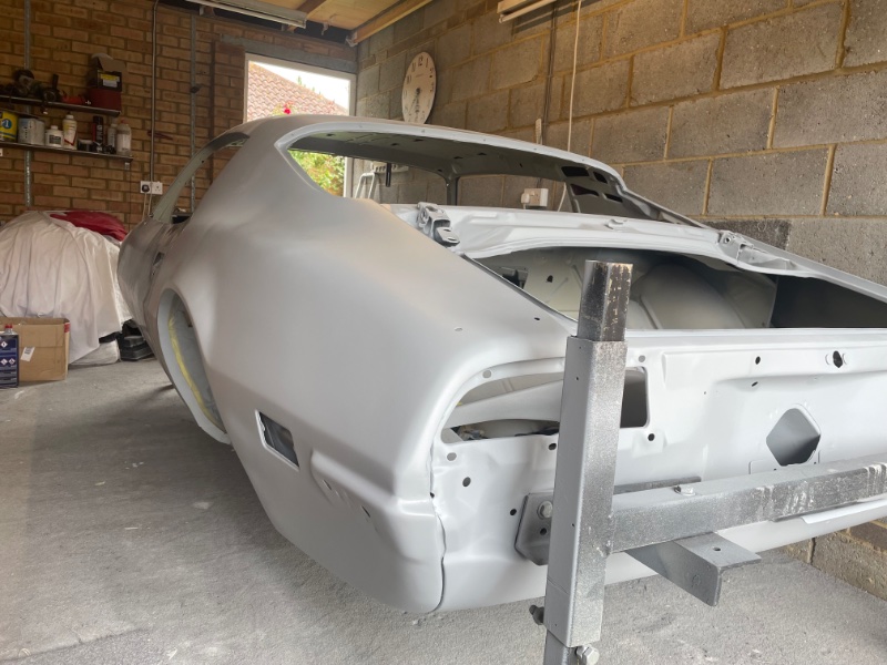

newsatten
Posts: 304
Post by newsatten »

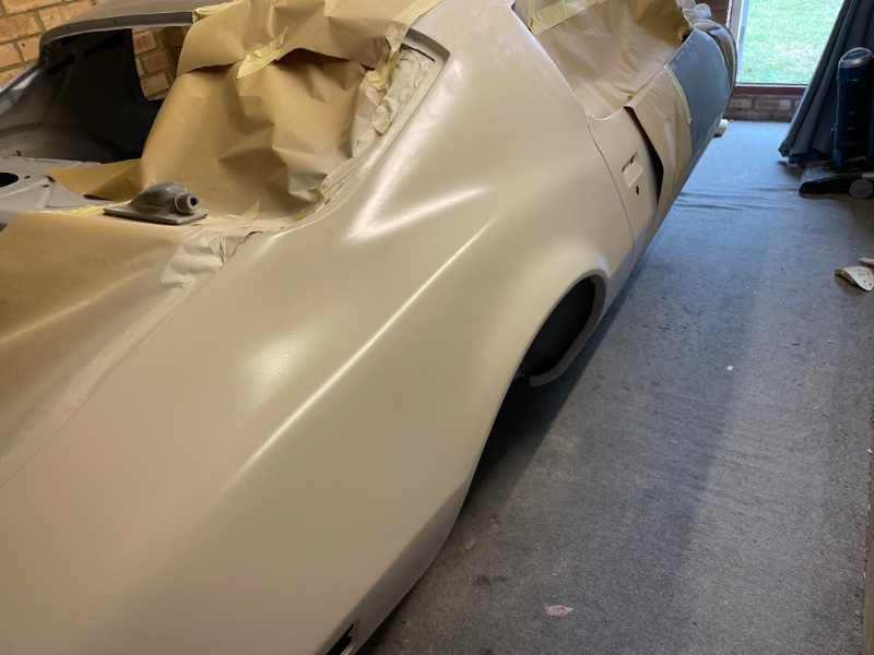

Got the left rear quarter squared and now in primer,
Just the roof to do now, I’ll need to local blast it again and the epoxy it,
Fortunately I’ve now completed most of the hard work and it’s starting to look like a car again!
Just gone over 800 hours !
#-o

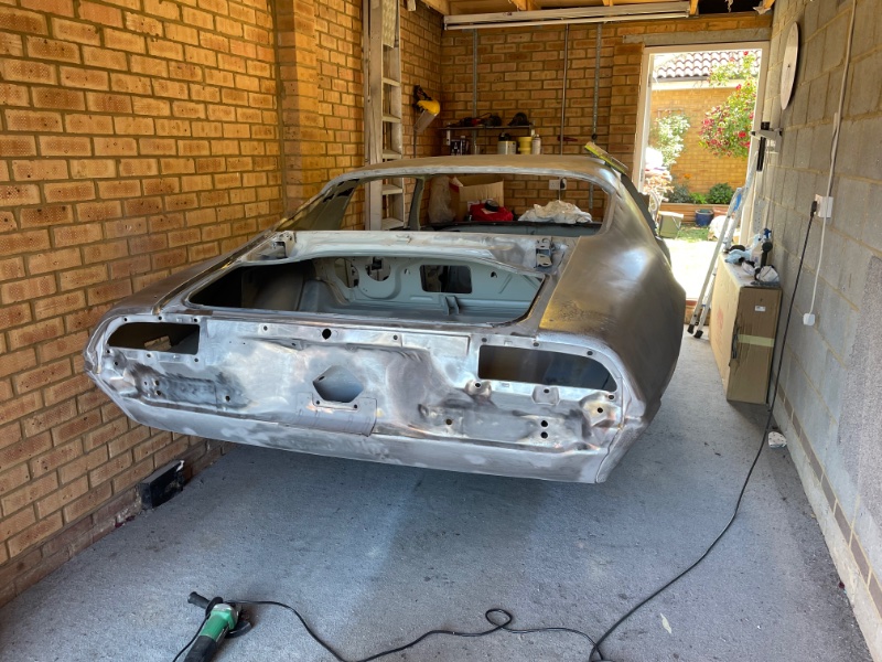

Posts: 1674
That's a great job in such a small space :thumbright:
