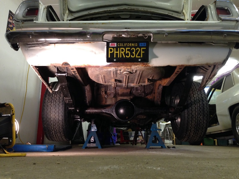

Quick mock up to make sure I can read a tape measure, narrowed E body 8.75 case with Strange shafts. 28 x 10.50 Mickey Thompsons on 8" rims fit nicely with no other mods, phew! All removed again and back on with the scraping....

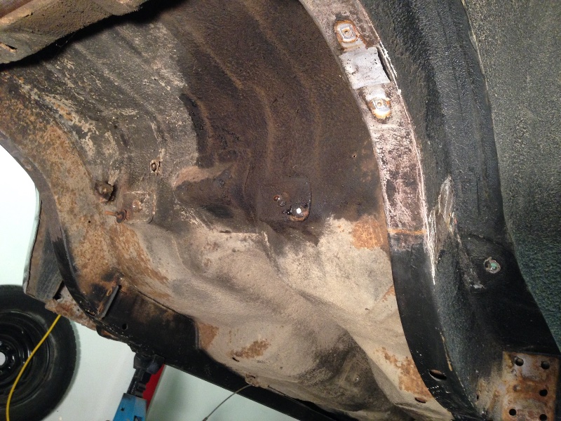

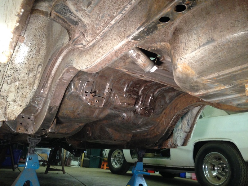

Pretty much all done and ready to paint.

wow... thats almost sparkling... what will you be treating that with now?

lough3969 wrote: Fri Dec 15, 17 5:04 pm wow... thats almost sparkling... what will you be treating that with now?
Seal all the seams with Tiger seal, Galvafroid on the bare metal bits that never had paint on then black textured stone chip over the lot.
Yes large bolt pattern all round now. Car is really solid, front floor pans were very thin in places and the lower rear quarters are badly repaired but other than that it's minty fresh!
Drivers floor pan and the rear panels are still on back order (since August) which is a pain, I wanted to have all the welding done this side of Christmas.
