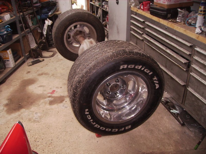

i collected the slot mags monday after work, all drilled to fit ford/mopar 4 1/2" pcd. so good for the 9" ford rear axle and also the front hubs once they too are redrilled from the small mopar 4" pcd to the bigger 4 1/2" so only one spare wheel will be needed.
i got wheel nuts from work but wasn't happy with the washers, i thought they were a bit loose on the 3/4" shank of the nut. to be fair all the lug nuts i've ever had have been the same but i can make the fit better so i got washers for 11/16" shank nuts and opened them out to suit on my lathe, 'cos i can. they are now a nice sliding fit so with a dab of copperslip i'll be happy. the shank is a bit long for the thickness of the front wheels but they won't take long to turn down. i've really missed having a lathe so i'm enjoying getting to use it :thumbright:

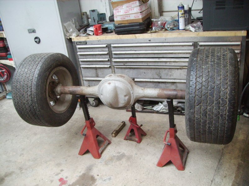

i got the wheels mounted to the axle and i've got some measurements of overall width which is 67" and distance between the tyres at 42". i can add a little once there's a disc each side between the halfshaft and wheel but only about 3/16" per side. the valiant's outside under it's new cover as i've got that anglia back in for exhaust, gauges and a couple of other jobs. these jobs all pay for my car so....

I’ve been running a 9” axle for at least 15 years, Ford 9” has more easily available options than a Dana, generally cheaper, lighter, .... :D
