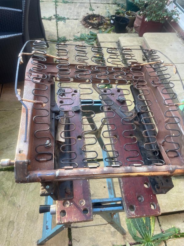

12) The seat base springs have "stays" this is stiff wire in a Z shape wrapped in hessian or paper crimped on to [provide a link from the side springs to the left and right spring no.2. Reclamp all the clamps with your mole grips or crimp tool. Or make up new parts using coat hanger or similar.

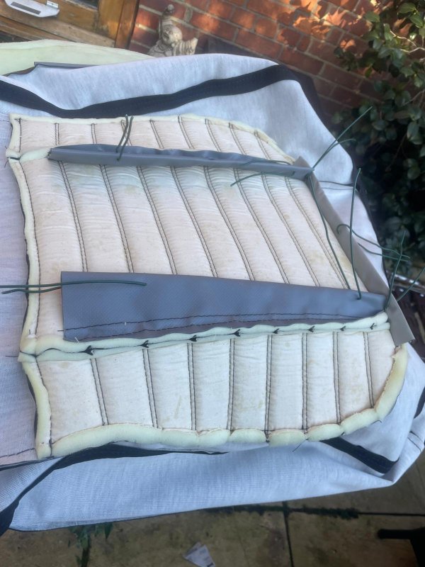

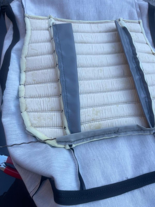

1) take the foam in hand, and clear every listing wire channel out down to the hessian, if the channel is stuck together with contact adhesive cut through.
2) fold each foam at the channel in the foam, and draw a line on the hessian on the other side to show where it is.

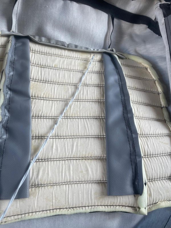

3) clean and fit listing wires into seam tunnels on cover
4) mark the centre of the front and rear of the seat frame and the seat skin , centre dictated by the pattern of contours in the seat as well as the shape of the skin. Do the same on the foam.
5) on a listing tunnel that is 8 inches or more use a skewer to pierce through the channel over the listing wire in 3 places on each listing tunnel and stuff through a 4 inch length of garden wire, a shorter listing you could use 2. one front one back.. longer need 3 or more
6) bend the garden wire into tight U shape around the listing wire in the tunnel, so it can be pushed through the hessian on the seat foam
7) spend time to mount the center of the cover onto the foam. centre it push the listing wires into the contours and push the garden wire "Us" through the hessian to the other side two holes about 1/8 inch apart. get the seat skin centred and leave it loosly attached.

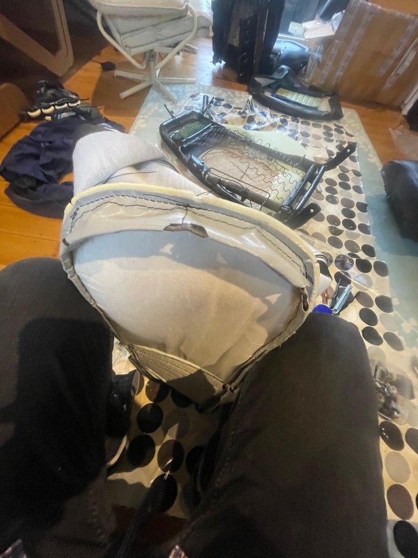

11) now you need to do a "James Herriot". Stripping to the waist, and asking a rosy cheeked farmers wife for buckets of hot water and towels is optional, full arm under the cover from the front, pulling up the hard edges of the foam around sides of the listing tunnel seams, make the contoured section look as good as it can, and it won't if the edge of the foam is trapped under the listing tunnel or pulled down on just one side of the contoured section. you are centering the contour section foam, under the seat base middle section.
11) use your manual hog ring pliers to hog ring around the springs through the hessian through the listing tunnel and around the listing wire, do this in 3 or 4 places, for each listing, near your twisted wire U makes sense.
12) make a decision about removing your gardening wires... i didn't but hey i'm lazy
13) the foam is about 2 inches too big in every direction, get ready for pain and frustration.
14) put listing wires into sides of skirt, if missing, make a new one:- clip the hook section out of a coat hanger, straighten whats left, fold exactly in half, put 1 end in vice other end in hammer drill chuck, apply power and twist up a new one, bend over sharp ends in a tight U and push the other smooth end forward into the skirt listing tunnel in the inner of the side skirt of the seat, do not put the sharp end forward....! . the twist stops it working its way out of the hog rings in use, and working the metal wire with the drill makes the wire stiff.
15) Now a big fight, stretch the cover round the bolsters, hog ring middle of each side skirt, check it is all centred, then the front and back then fill in the gaps so that the bolster sections are smooth and the skirt has no ripples. if need be get you hands in to pull the foams into place outside of the contoured area
16) cut holes based on old seat covers once seams that should be on hard corners are checked for correct positioning
do a couple of hours at a time and walk away when frustrated

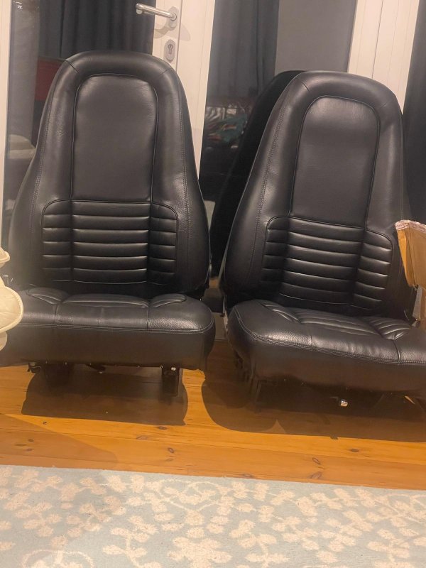

job done or should i say 1/4 of the job done
done  but before application of gentle hair dryer

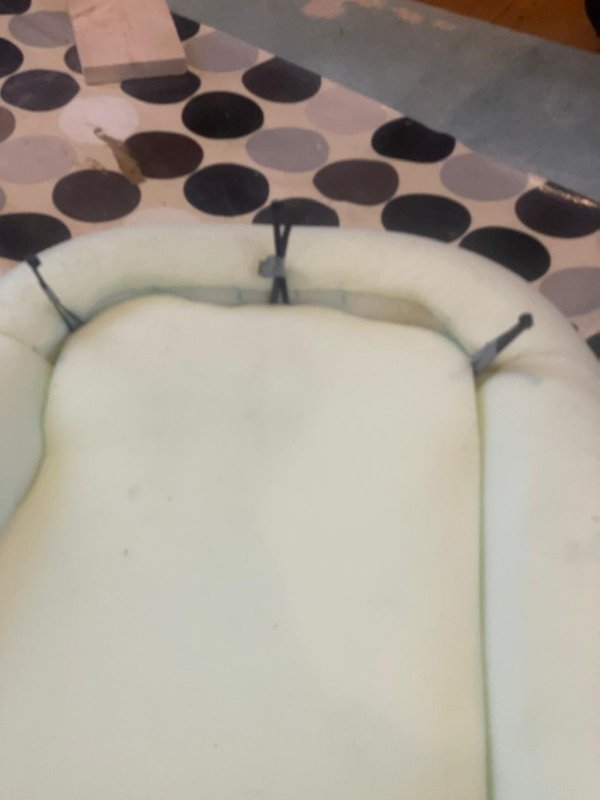

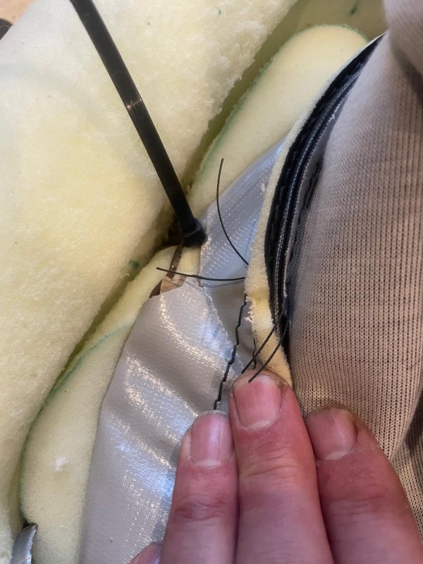

Listing wires in listing wire tunnels and garden wire applied
Listing wire being shoved in front tunnel

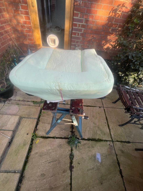

centering the foam
centering the foam

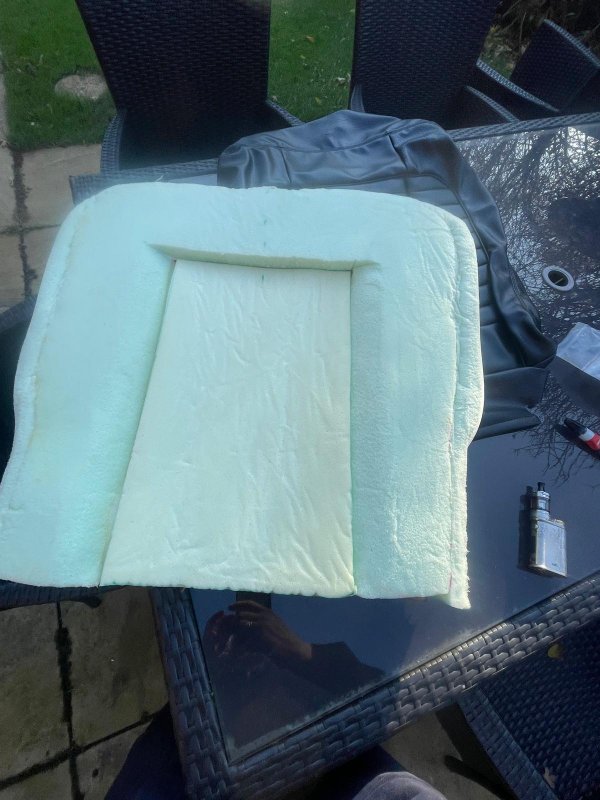

new foam needed the contour valleys clearing out
stuck down foam and then decided to de rust  so did it again  :)

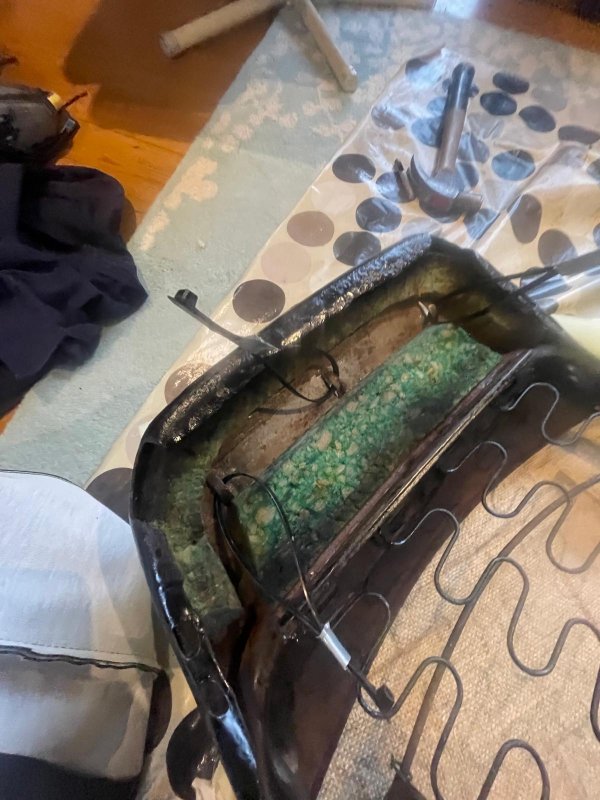

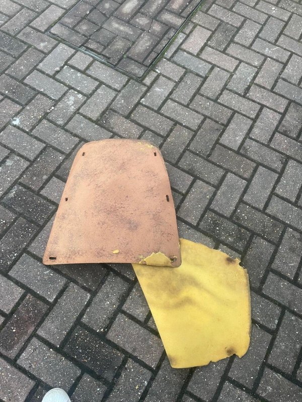

seat pan  flat spring steel spring support and springs.  this was the good seat.  The springs and flat spring steel support on the drivers seat were snapped and exceedingly rusty.shows the "stays"/"tethers between spring 1 and 2 each side

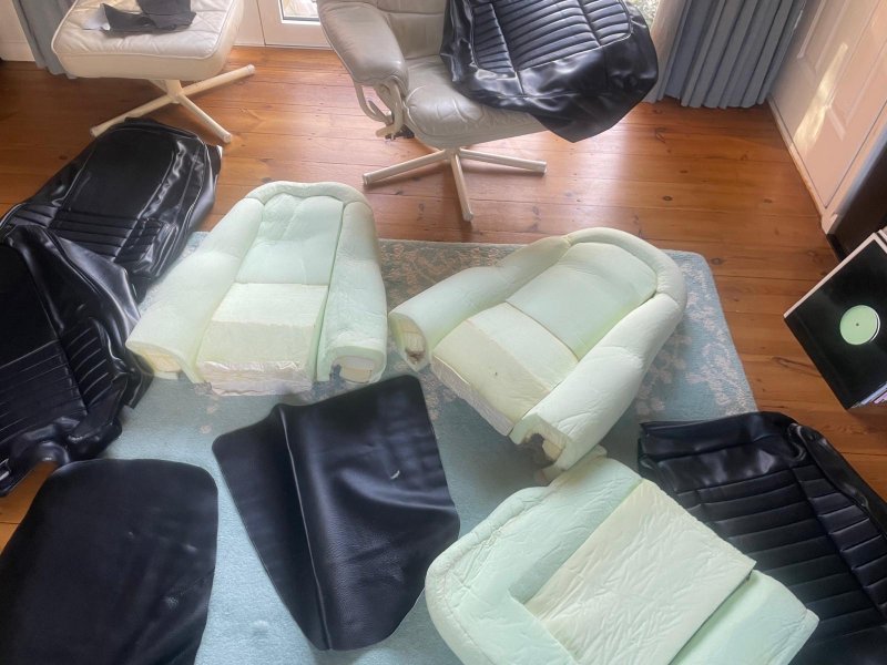

after a few hours unpacked... expanding after being vacuum packed for years

That looks good, Mate!
Would you do it again, knowing what you know now, or would you ask an upholsterer?

Stu I've done all of both of them now...
i set aside a week per seat and did about 2-3 hours a day first one done in 4 days the second in 3
afterwards took about 2 weeks before i could button my shirt without wincing. my hands were a mess. tips of fingers were like a pin cushion and i still can't use fingerprint to open my phone....
when you are doing the job you don't notice. its afterwards that the pickled onion jar highlights just how many holes you have in your hands,
every hole carries its bruise. Just picking hog rings out of the box, the ends are raggy with swarf, pick one up and stick it in the pliers only to find often a good few minutes later that you have another embedded in your little finger.... :) and these didn't come from china. I do not have the hands of a lady washed in mild green fairy liquid etc

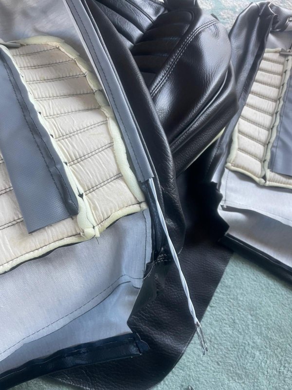

Notes on seat back
1) heavy
2) the rear of the head rest area is plated over, making access very awkward.
3) sort out the seat back, button area in the foam before putting the skin on
4) you need cable ties
5) you will need to cut a hole for the seat back catch at the door side bottom of the skin, don't just hack right through cut a slit and pass the catch and its cable through, you will need to remove the mounting for the seat back catch cable to pass the lot through the hole and the latch is held on with a circlip.
6) having the seat semi reclined before removal makes more space for wrapping the bottom corners properly during installation
7) The seat recline pull lever is on a shaft with a welded on lever or e-clipped lever on the inner end. These break when the outer lever gets stepped on or someone pushes it rather than pulls it. weld it back on, bend the hog ring rail nearby to refit the assembly, then bend it back. Do not get weld in the lever "stop" area. Reset length of pull wire so that the lever is taught but not partially activating the recline mechanism.
8) the bottom flaps at the back of the seat go around the outside of the recline frame. there should just be 1- 2 inches of the cross bar and the mounting arms sitting in view when done.
9) my seat skins used rip stop style tarpaulin like the bottom of a vango tent from the 70s, for the listing wire tunnels. robust as hell. the originals used cotton/calico.... not robust as hell.
method,
1) pull off the back...if it uses the auveco trim panel fasteners some will die in the process, or you will destroy the masonite board
2) start removing all skin edge hog rings
3) remove all listing wire hog rings
4) you'd expect to be able to remove the skin...But you can't... turn over to the frontside, pull skin up to the top of the tombstone contour below the headrest area. the listing wire here is hog ringed from the front side to pressed loops in a welded in section in the inside of the head rest area. go digging, there are 3 hog rings in the base of the listing channel near the top of the tombstone shape.
5) remove skin and crack on with removal of the foam
new stuff
1) Repair the seat back, sort out the cable for the seat mechanism and fix the recliner levers.
You also have seat spring stay chains from the hog ring rail to the outer most springs at mid point up the back. if missing make some coat hanger loops that are not in tension when nobody is sitting on the seat.
2) Remove nasty degraded horrible foam around the pressed loops in the front of the head rest section.
3) use same technique as previously, clear out the listing channels in the foam, fold and mark with on the hessian side where the channels are.
4) appraise your listing wire situation
5) mark centre on top and bottom of frame, skin and foam
The tombstone profile in the seat back that maintains the semi bucket shape of the seat is created with either of the following
* a 2 foot long curved listing wire that fits into a listing tunnel right around the section in the cover..
* 3 shorter listing wires, one across the top and longer ones up either side
how you prepare is dictated by your listing wire configuration
long curved wire
straighten it, clean it up as smooth as possible and manipulate it up one side through the curve and down the other side, leaving about 1 inch sticking out at the bottom end of each side..... this is not an easy task.
2 long and 1 short
place onto back of skin following the listing tunnel
cut listing tunnel so you can fit 2 long sides and 1 short cross listing
Both cases
Cut a V in the listing tunnel so you can see the wire in the exact middle of the top
place this V on the centre pressed hog ring mount on the frame and cut a V in the listing tunnel so you can see the wire adjacent to the outer pressing/hog ring mount at either side. do this without the foam in place.
press the listing into the foam and centre it
Cut a 1.5 inch hole in the hessian backing of the foam next to where each of the V sections in the listing tunnel is across the top of the contour, so that you can see the pressed section loop in the pressed steel section of the back of the seat
5) you should have your listing wires in the cover, you should have v section cut in the top of the listing tunnel
6) do the skewer and garden wire routine on the rest of the listing tunnels from top to bottom, where is dictated by 1 long or 3 separate listing wires
7) assembly routine changes here from what you did with the seat base
8) put 3 cable ties around the 3 pressings for hog rings in the seat back head rest area
9) loop up ends and tape together to make an easy to grasp pigs tail so you can use the cable tie later
10) put foam onto seat back and pull the rear down until the hood of foam covers the steel backing of the head of the seat, it should reach the edge of the steel at the back.
11) moved no. 11 to later but called it 11 to confuse people
12) check base of bolsters near the bottom of the seat back are not hung up on hog ring rails, the sides should reach the bottom of the frame sides
13) pull each cable tie up through the holes in the hessian to the front side in the listing valley in the foam and then hog ring the foams calico top and bottom. to maintain its position. then do the sides.
14) force the top listing into the channel in the foam
15) centre it and cable tie though your listing tunnel V cuts in 3 places
16) with the skin centred manhandle the seat back with foam on and cover flapping around, to stick you garden wire through the hessian and around seat back springs.
17) use wires and mole grips to draw the listings down tight
18) use the cable ties at the top to do the same. swap 16) and 17) order if necessary
19) from the front side use your manual hog ring pliers to clamp through the listing tunnel V cut, around the listing wire which you can see in the V cut, through the hole in the hessian to the pressed loop in the seat upper head rest area. really awkward to do. check it is all centred. Middle one first. Kneel on the Bananarama! if you need to. approach from top side or lower side whatever is easier.
20) draw the listings down tighter with your wire twists and hog ring them in multiple places to the seat springs through the hessian backing and listing wire tunnel
21) get you arm in up from the bottom to pull up the edges of the contour foam in the middle to make it look even and nice, especially over the curve of the tombstone section.. same routine as seat base for exactly the same reasons
22) you should have a seat back with a perfect centre contour, in the centre of the back and the bolster /head rest /bottom flapping .
11) cut hole in foam for the seat back push switch. use nail or screw driver into actuator in seat to centre then push button base as template to cut, note the strange angle of its mounting holes and make you foam hole align. while you have the stanley knife and scissors out, cut away foam near the recline lever.
23) Hog ring the rest of the seat skin, pull the head rest sides in and hog ring to top bar 1-2 inches between at the bar, not so tight as to cause a dent in the top of the seat. get hand in to pull the foam.
24) hog ring the center top flap over the 2 side flaps previously hog ringed get about 1/4 -1/2 inch wrapped round bar and hog ring through the wrap. 2 or 3 rings middle and sides
25) check that you have no pleat and that the head of the seat aint lumpy
26) do the bottom. centre flap up to bar going around the frame so you can not see the cross bar
27) do the pleated side pulls around the recline hinges.
28) pull the side on where the seat back latch catch hook is, check skin seams line up with the hard corners, cut if you have not already, a slit for the catch, and push the catch its cable and cable mount through.
29) hog ring the sides alternating from the top down until you have a decent wrap around the hog ring rails on both sides right to the bottom, adjust as you go pulling mainly in a downward direction to remove any creasing in the bolsters
30) refit seat catch (circlip/snap ring) and re mount the seat catch cable bracket
31) cut hole for recline lever
32) pierce hole for seat back button, you are clamping the skin to the frame via the seat button bezel, so the hole just needs to be big enough for the plunger provided you sorted the foam beneath when you have the chance before. if not you are snipping foam through a keyhole in the skin. possible but not fun.
re mount seat back on seat base.

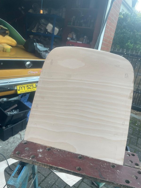

Masonite seat back boards
1) strip off vinyl and manky old foam
2) buy some 3.6 mm ply from wickes
3) used old board as template
5) stick 2-3 mm thick foam to board (peal off pre glued stuff is easiest)

I Have to say, once done the seats are firm, in an almost modern car sense
i had to remove some spacers so my head didn't get too close to the roof
driver fatigue greatly reduced
i'm higher so i can drive with my elbow on the window sill
i no longer have to learn how to walk again after driving.
i have much better angle into the clutch and i'm not fighting the edge of the seat, i was basically sitting in a bucket previously. so i don't get shaky leg when stuck in traffic.
the seat base on the drivers seat was just held together by the skin the spring steel spring support was snapped....its so much better now.
well worth doing

cable tie in use. still a long way to go
cable ties
cable ties
