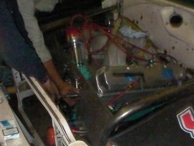

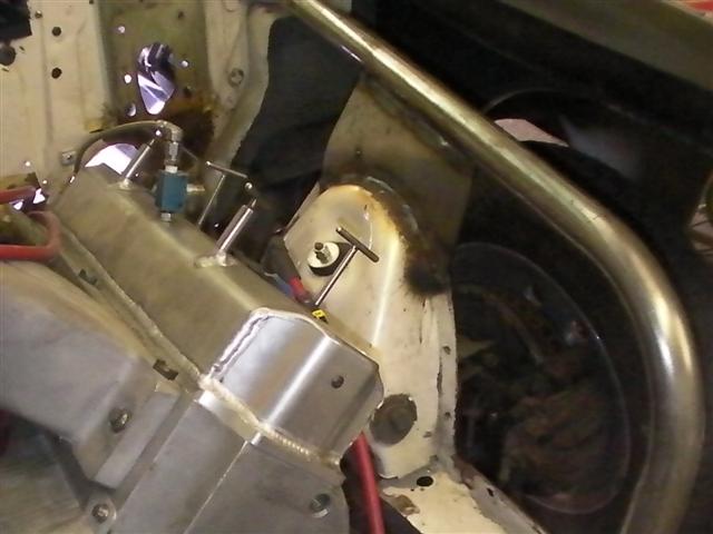

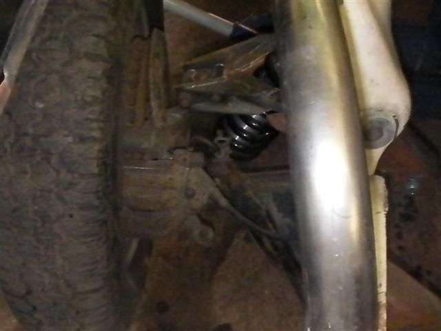

Trail fitted the engine and that turned out to be more difficult than expected and threw up some more questions about the new suspention.
Basically I guesed the front spring loads at around 600- wrong dooh.
it seems the front springs will have to be around 800 lbs per side if not more.
I did not have the right rear gearbox support so it proved very difficult even with the prop bolted in the get it right so will have to do all again.
But hey ho thats part of the deal.
I realy neeed to place the car on some scales to check the actual weight on the front end so if anybody has some or has some ideas I am open to sugesstions / help in this corner.
Here ar some pics.
Here ar some pics.

Spent another day in the garage (which got me into some serious trouble) but actually got somewhere with the front end set up.
With a few tweeks she is sitting somewhere near the correct ride hieght and will not need an enourmous sheet off aluminium chequerplate under the sump to drive it without mashing the sump
Getting some good support and thanks to the big fella for comming back today with a clear head and some usefull suggestions.cheers Jay.

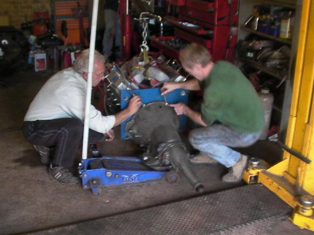

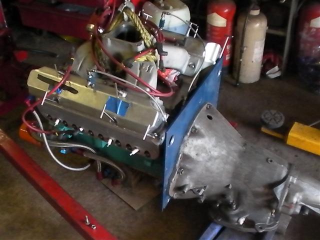

Blue has done a great job and the gearbox is resplendant with all the new billet bits and the PN123N transbrake. the only indication that there is anything different from a normal 727 is a small bayonet connection for the transbrake new sheild to attach and it is ready to bolt on.
Next job is to refitt the engine and box fix the front plate mounts, I have decided to ditch the mid plate after speaking to a few sexperts which will make it a lot easier, then tweek the coil overs to obtain the correct ride hieght.
