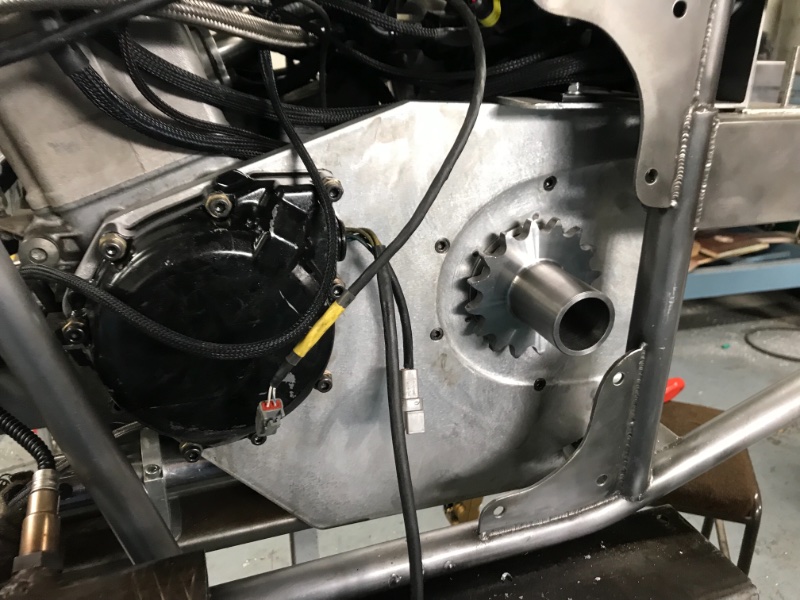

Re: Fifty shades of Jade

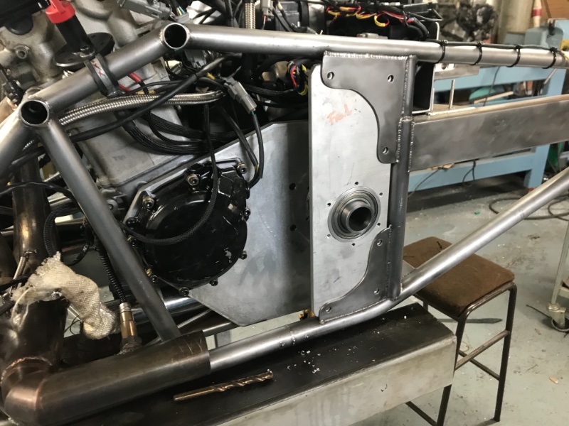

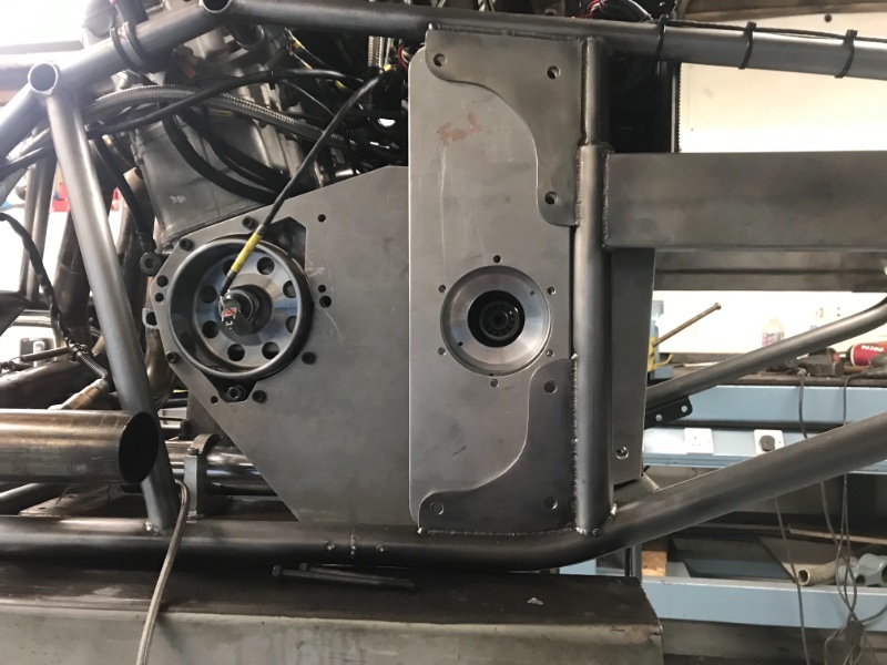

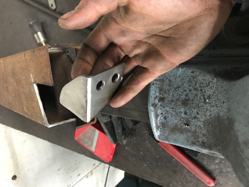

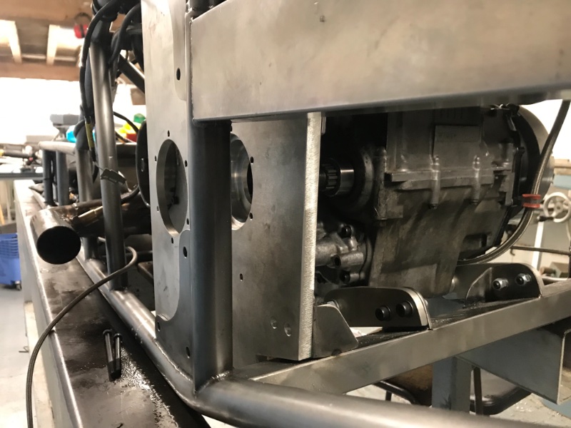

I’m just trying to go at this point !

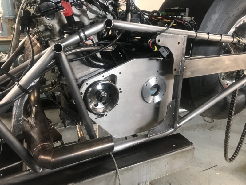

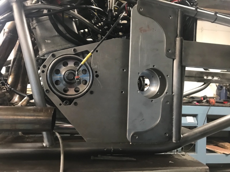

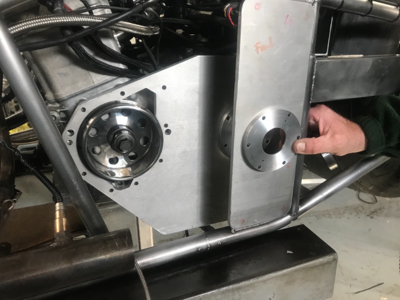

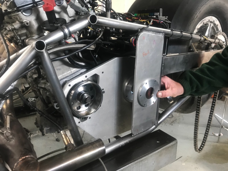

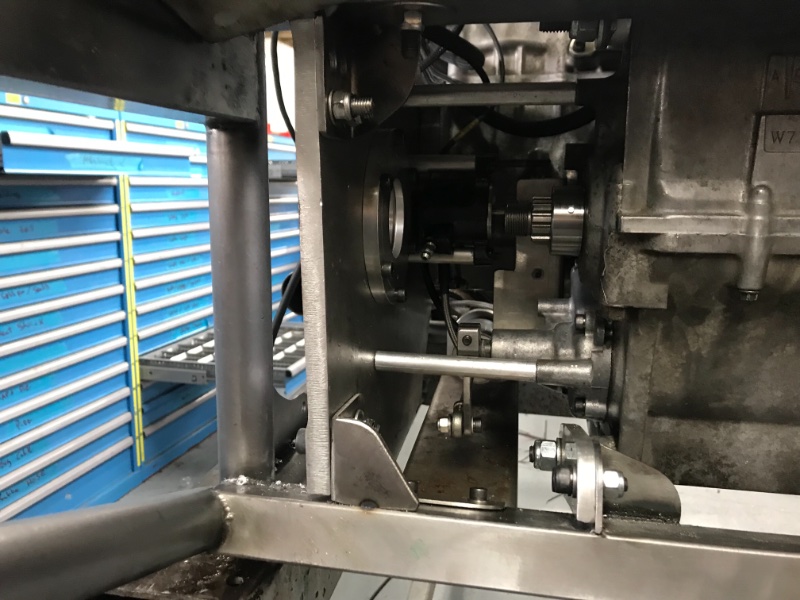

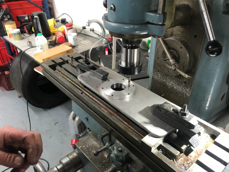

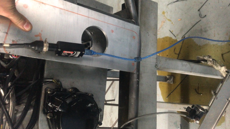

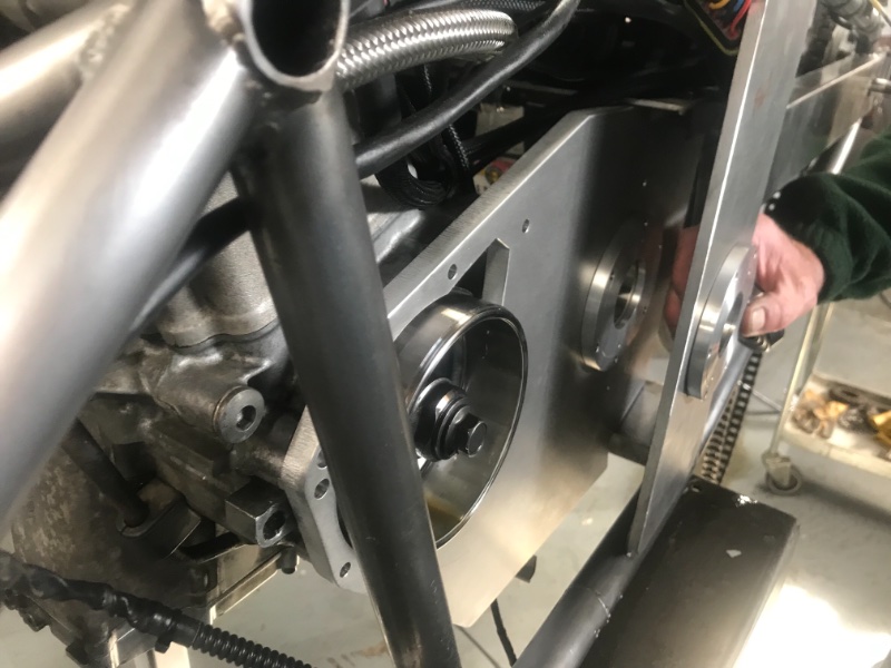

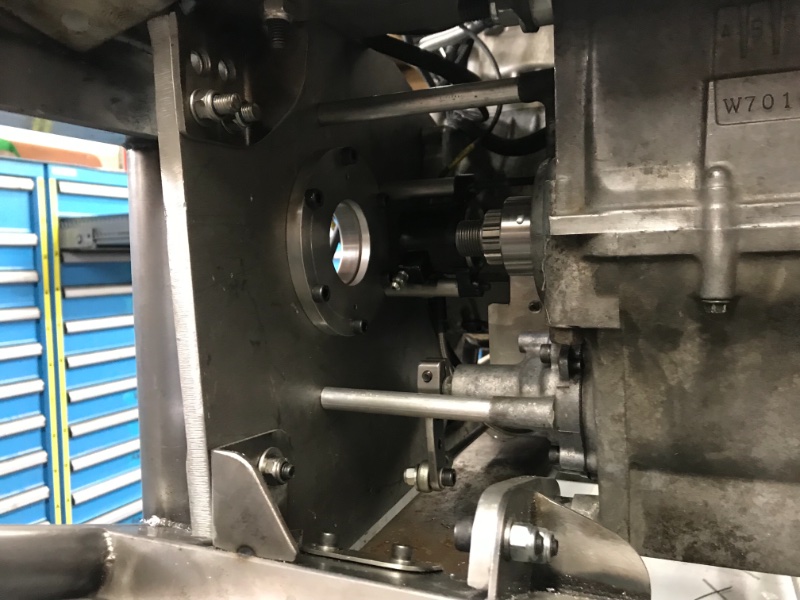

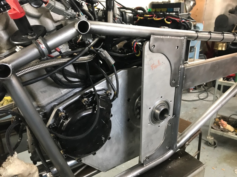

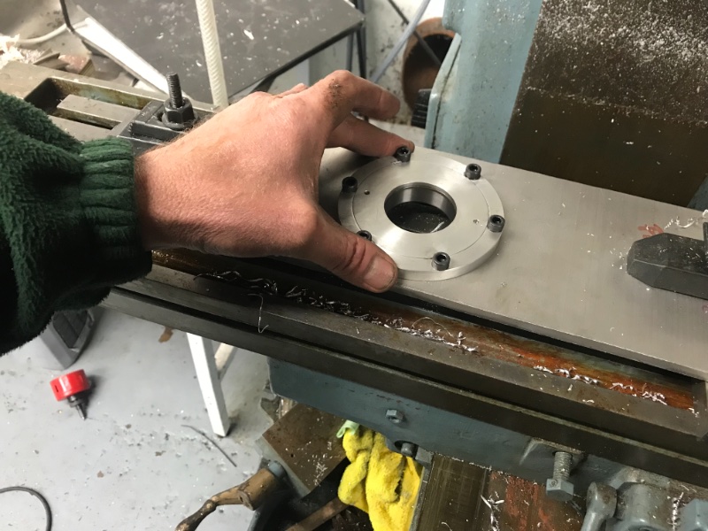

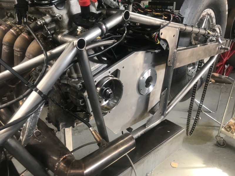

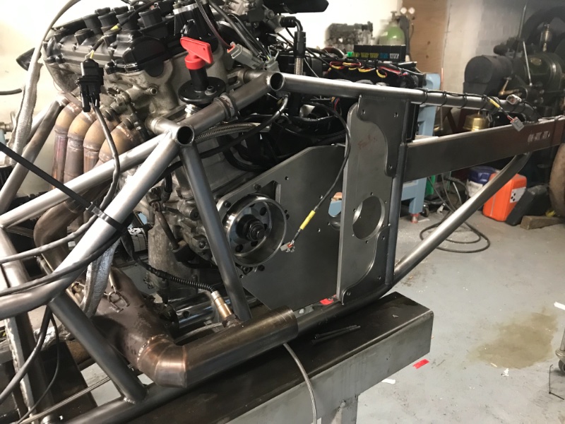

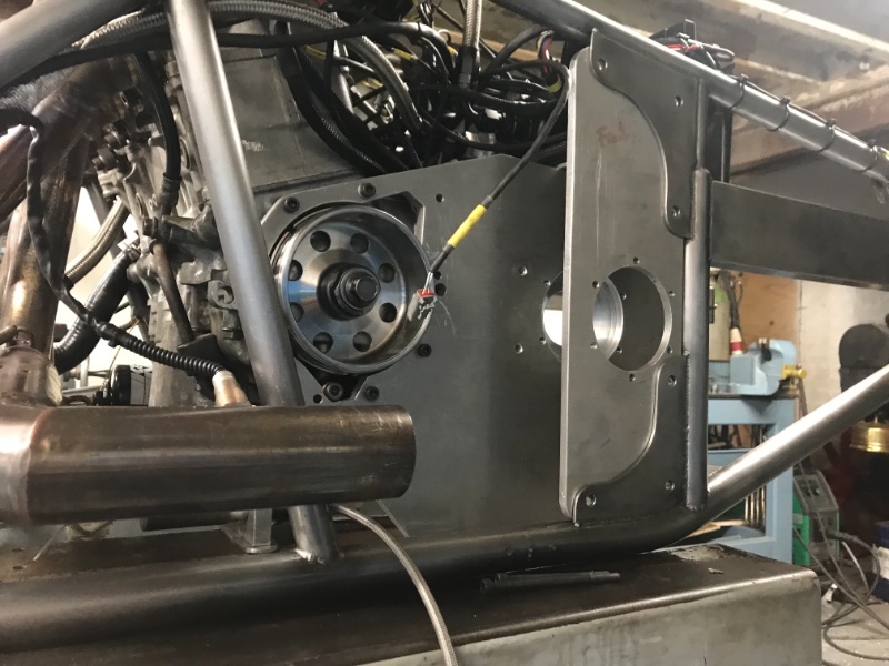

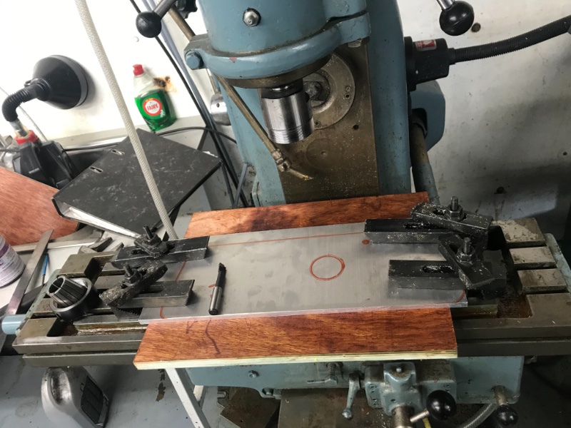

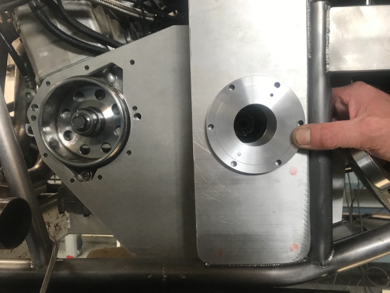

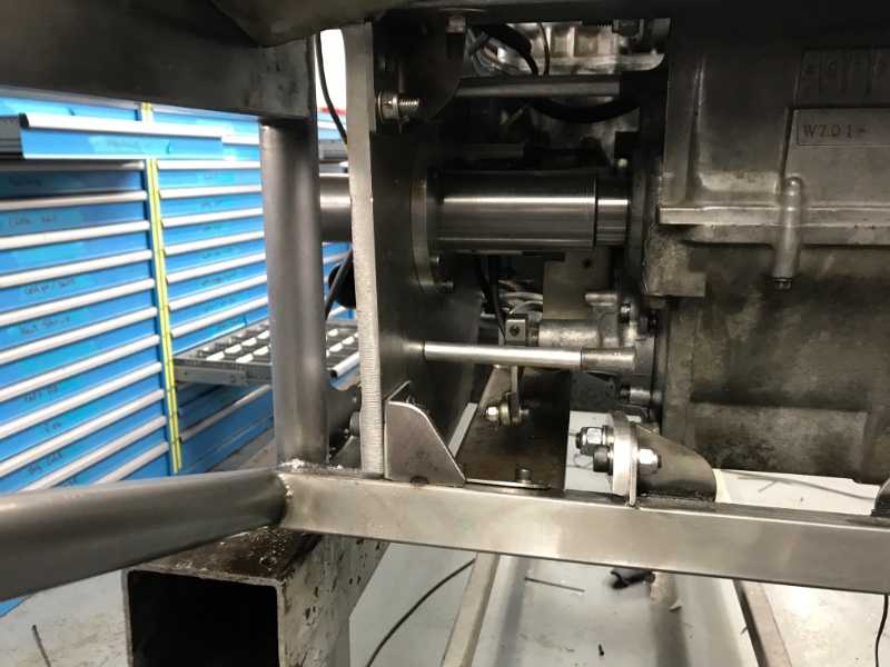

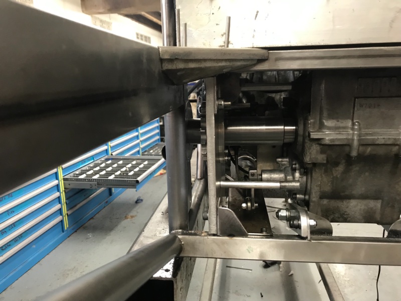

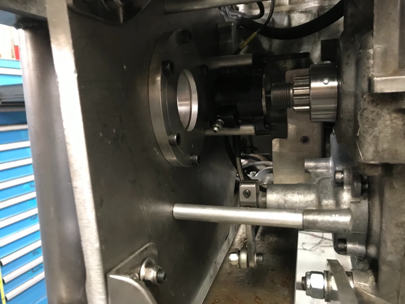

Hours spent making 10mm plates to support giant bearings
These bearing will support a very special Sprokets if it every arrives !

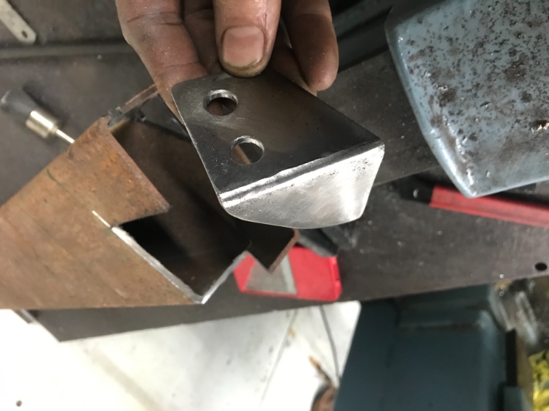

Plates bolt to engine with tabs to frame
This better not break after all this work

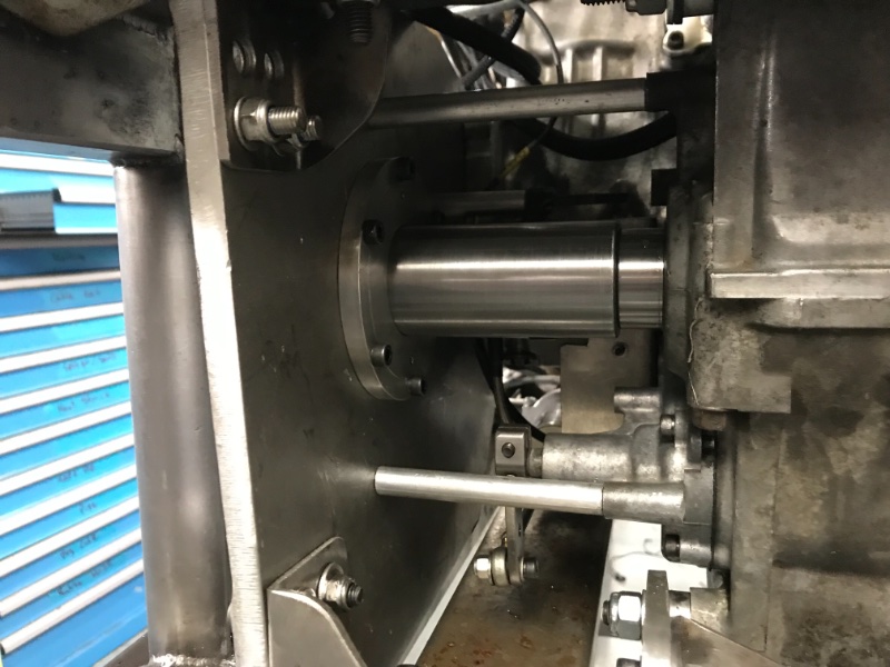

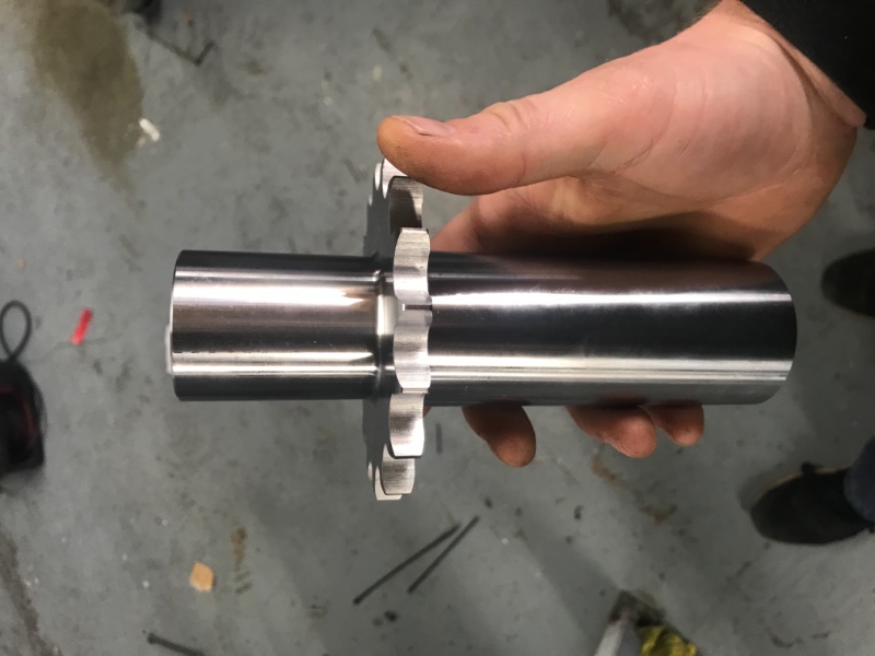

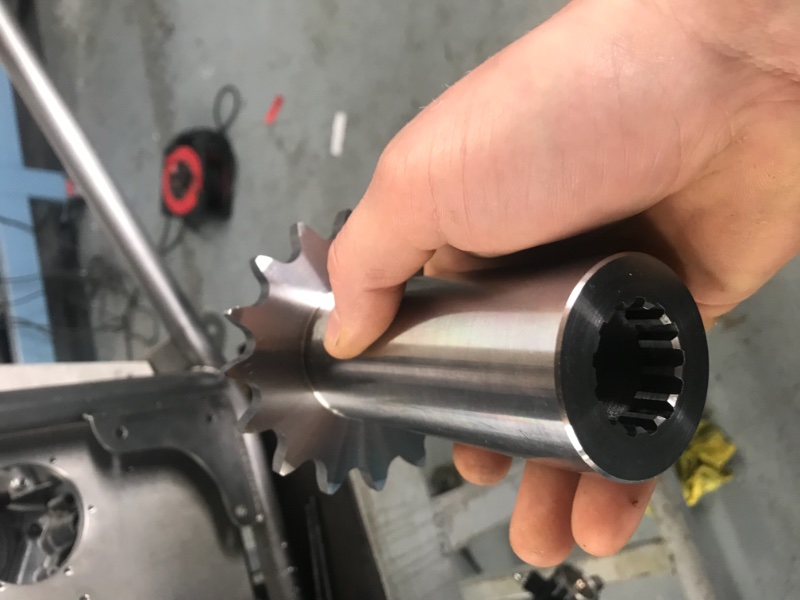

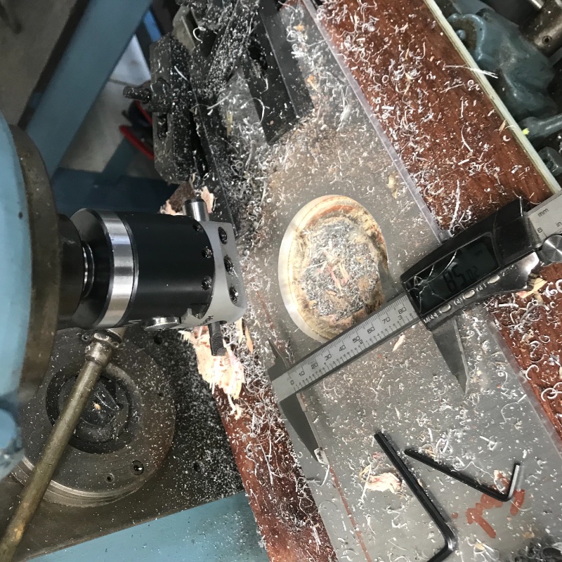

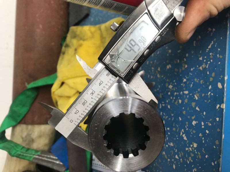

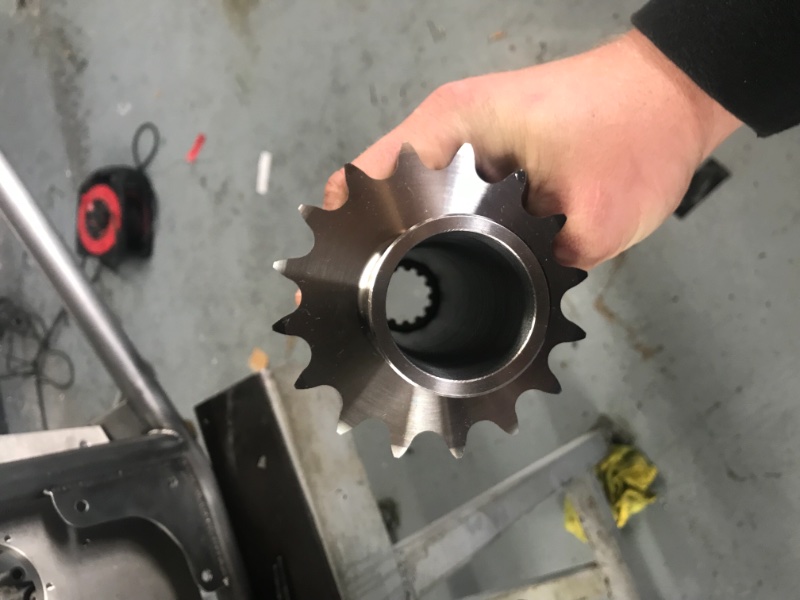

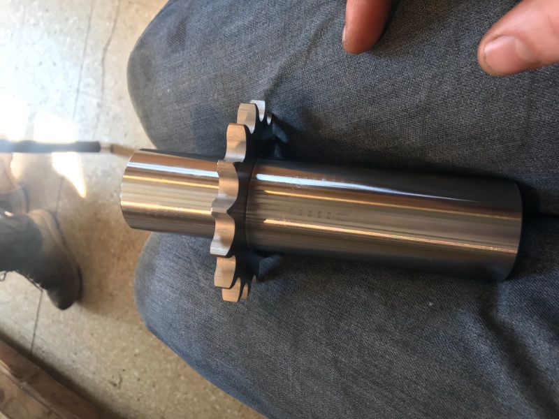

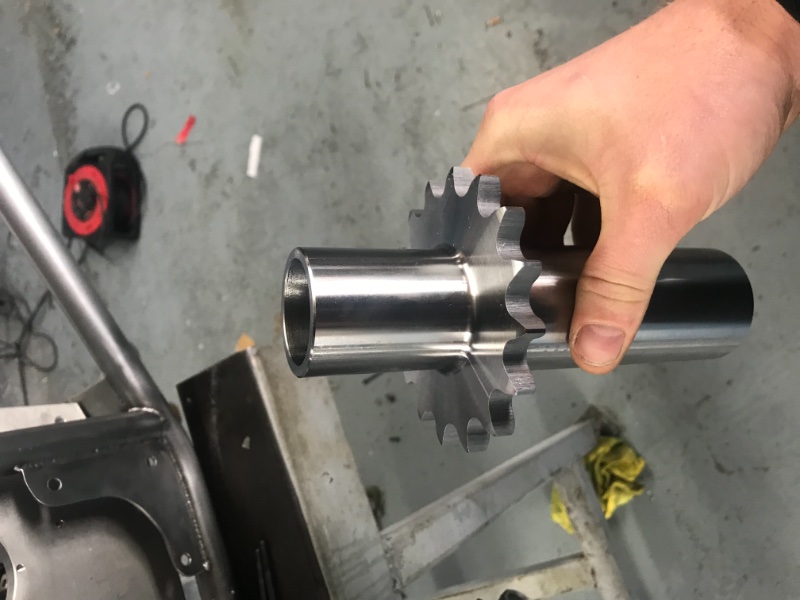

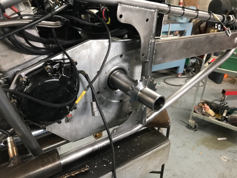

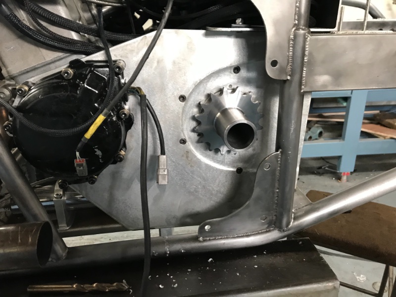

Made from a solid billit of unobtainium heated by the flames of a dragon's breath and quenched in squirrels tears
This shalft will sit onto the new drag racing large gearbox output spilnes. Then be supported by 2 large bearings.
A little over the top but built to last big power hit after hit.
Kev

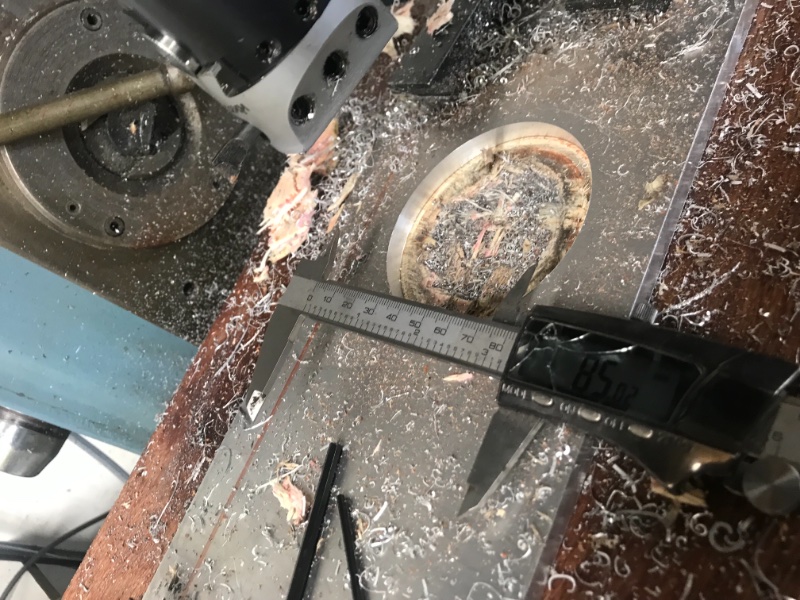

Loving the cracked Vernier screen, all Bananarama!, and that!
Make sure your chain tension is correct, you don't want to "Hook" that bad boy sprocket....
Fabulous thread. 8-)

What do you mean hook a Sproket ?

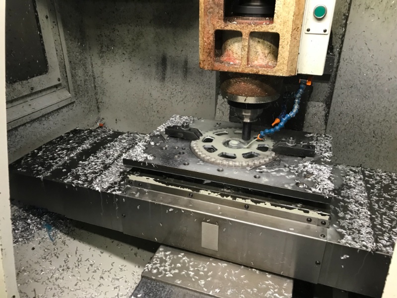

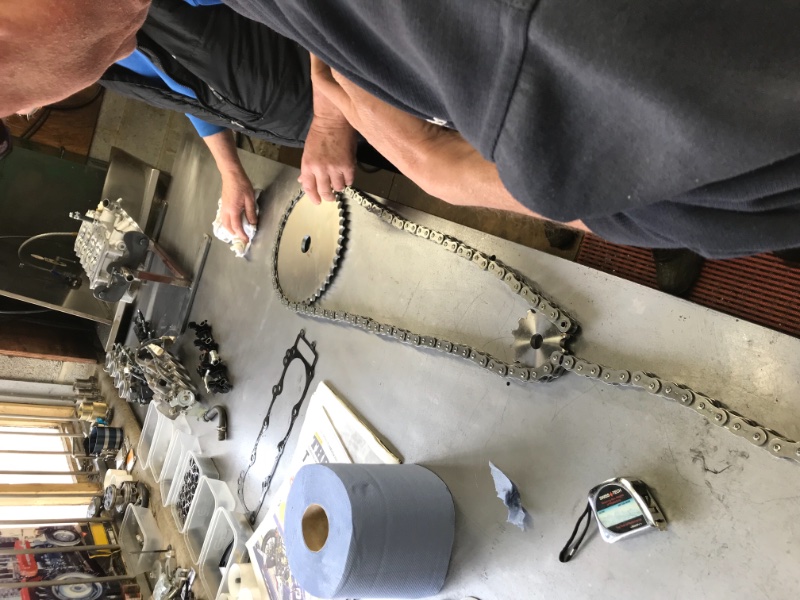

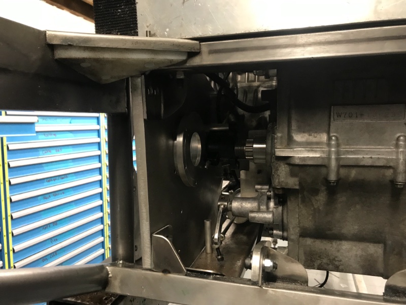

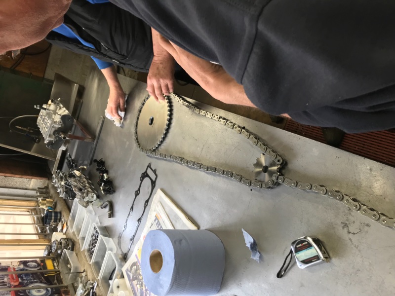

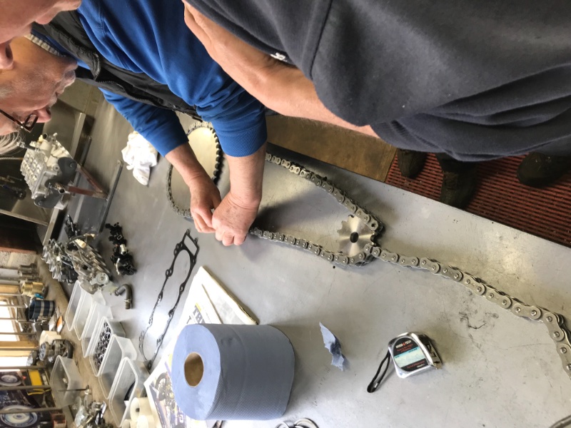

New chain and a sproket made to fit !

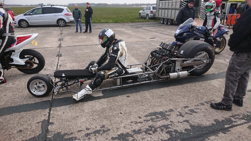

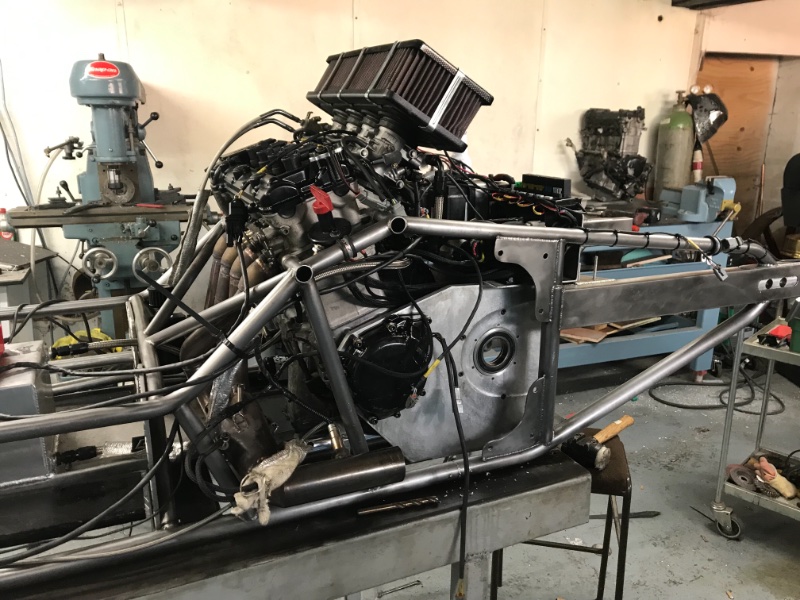

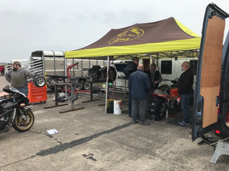

Some major changes needed as handling wasn’t great and riding position very uncomfortable was all over the place
Last run of the day was 112MPH
