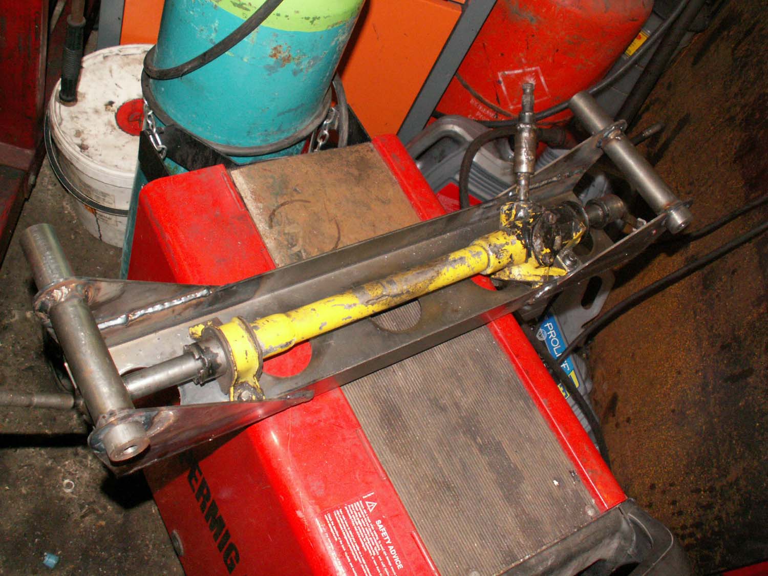

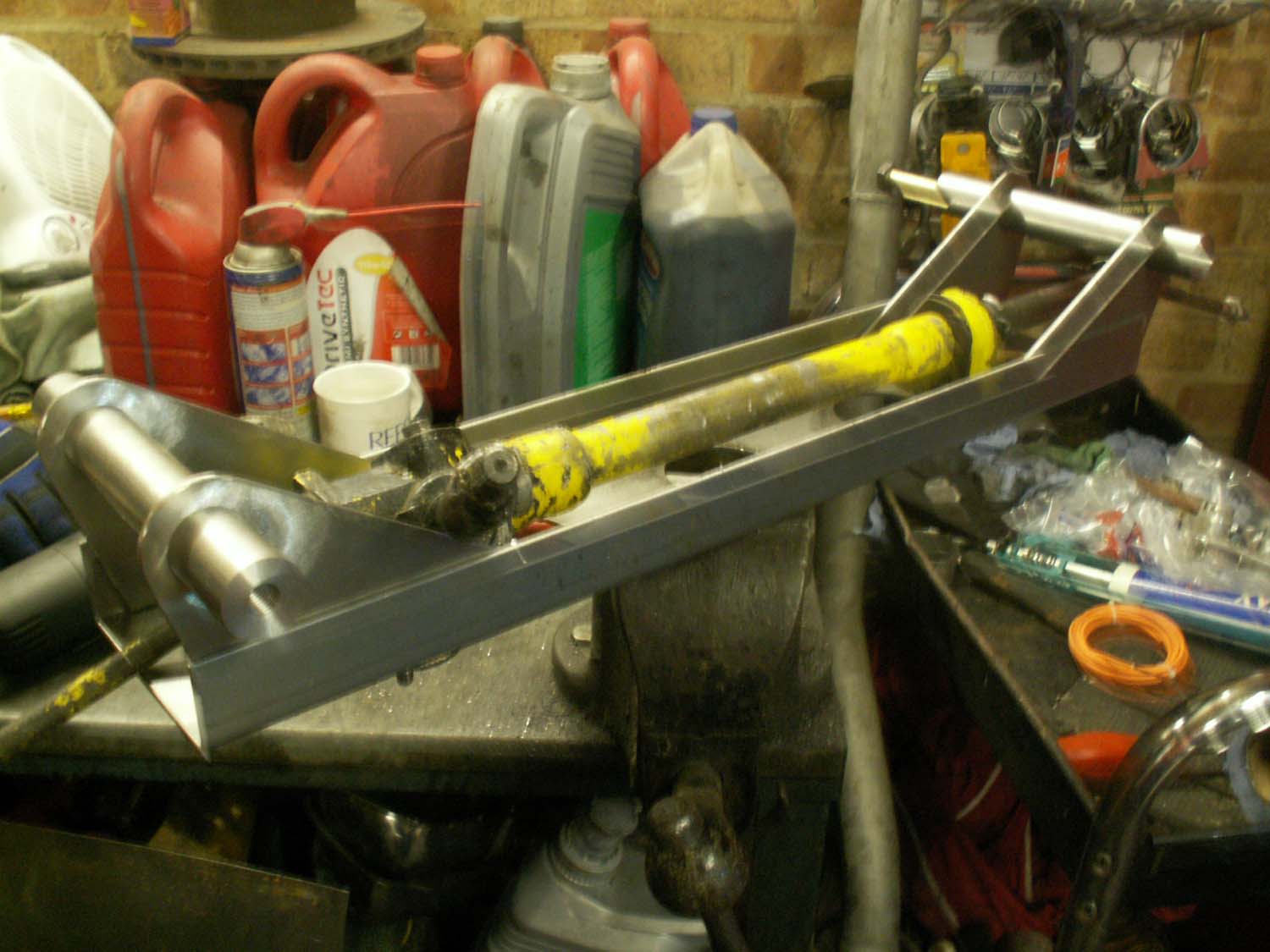

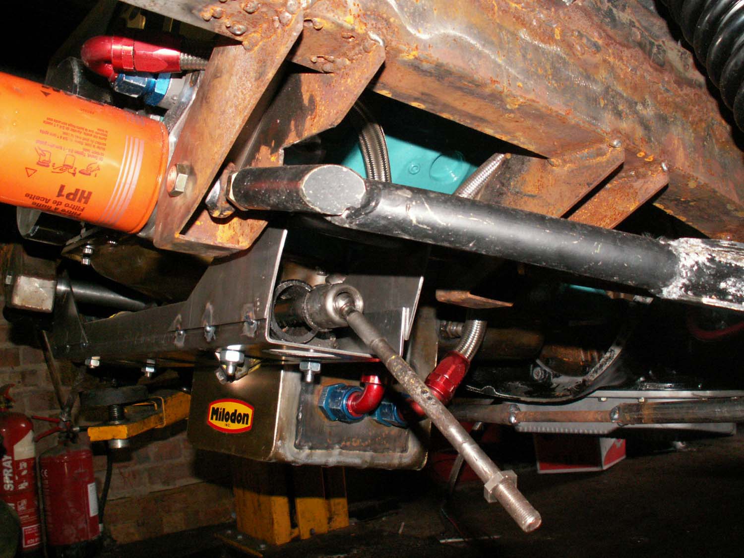

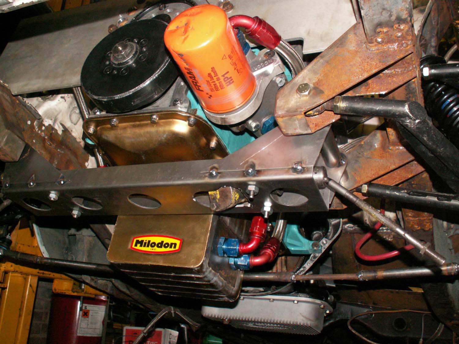

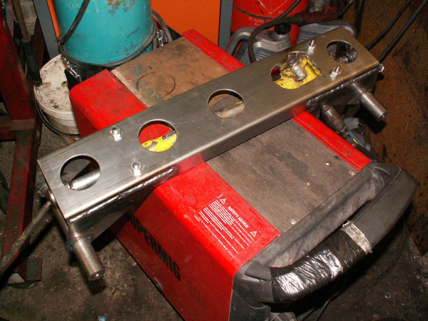

Update Stardate dec 2009.
Sorted out the mini K frame and steering support toady.
the idea is to stiffen the new lower A frame mounts and support the steering rack.
the first picture is the components assembled on the bench, we then offered them up and tack welded them in situ to allow for any small intolerances, we then removed it and welded it on the bench.
the welding was done by wiggle arse mark
As you can see from the pictures, it is forward mounted and that means the steering column (tube) will miss the headers and starter motor.
Now I have the dimensions to make the steering arms and steering column and fit the removable wheel.
It will certainly make moving the old girl easier.
Then I can strip it all down again, clean up all the components and get them plated and the engine bay and intierior can be repainted.
