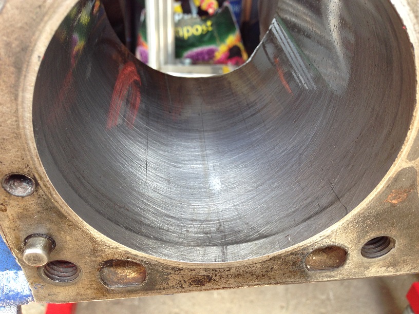

Okay its here, your next instalment of the rebuild you have all been eagerly awaiting.
The Block came back looking like this after its 5tho hone, its not 100% but a vast improvement on what it was. They said to get all the scratches out I would be going into the next overbore size and the block wont take it.
The black marks are from gapping the rings.

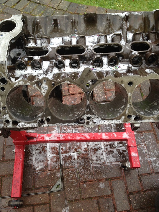

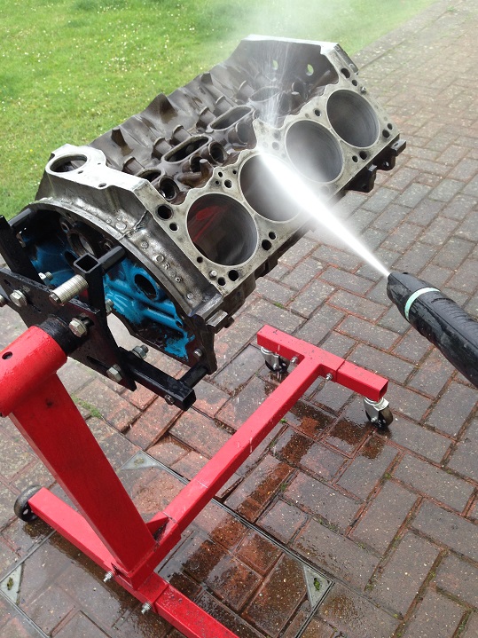

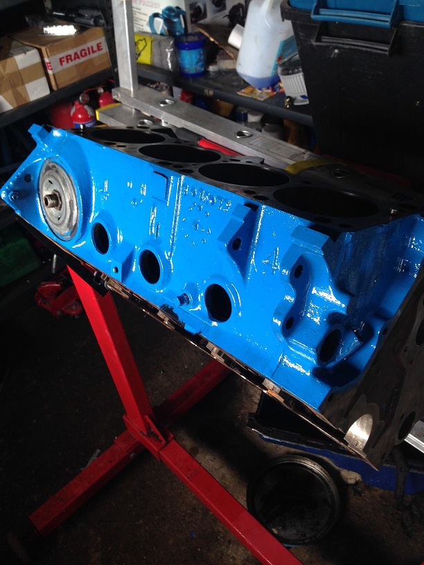

Then the block got stripped of all the old paint and a good wash down to clean the bores from the re hone. And the Block got a new lick of paint.

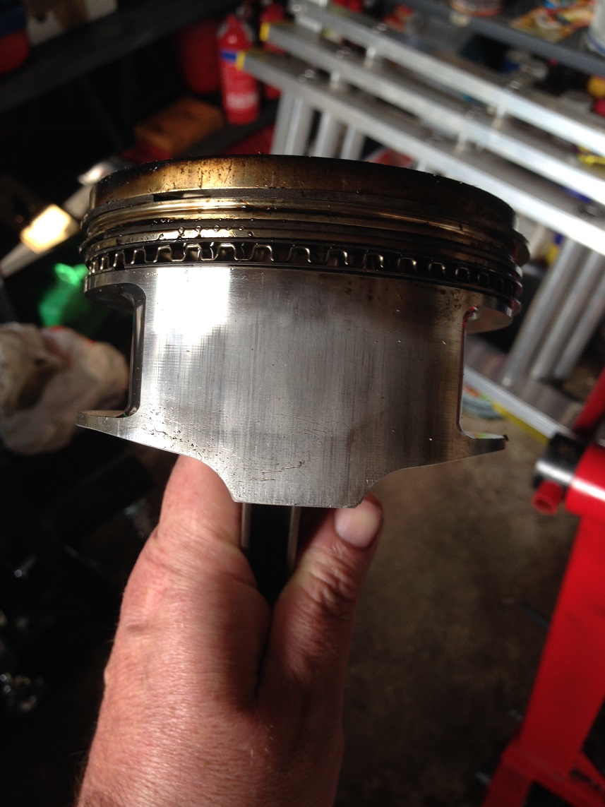

I gave the pistons a bit of a clean up, not great but better than how they came out. And Total Seal rings fitted.

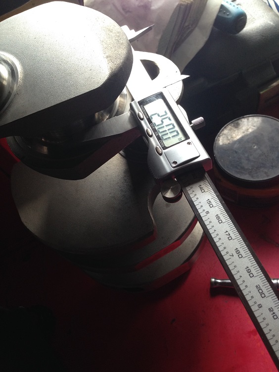

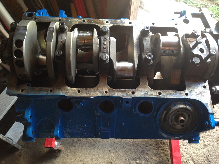

A measure up of the mains and crank, and plenty of Bearing Guard on the shells.
crank measure.jpg (133.99 KiB) Viewed 427 times
measure mains.jpg (178.59 KiB) Viewed 427 times

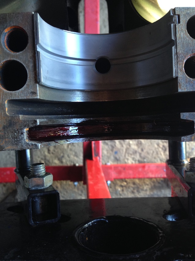

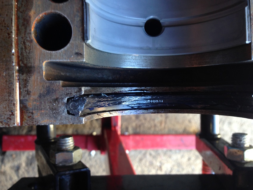

Almost forgot about the rear oil seal going in.
Used my trusty High Tack Gasket Sealant in the groove then placed seal into grove gluing it in. Then Greased around the seal.
seal glued.jpg (161.25 KiB) Viewed 423 times

Crank goes in
crank in.jpg (173.94 KiB) Viewed 423 times

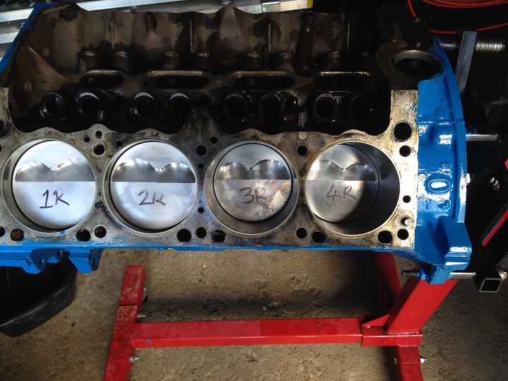

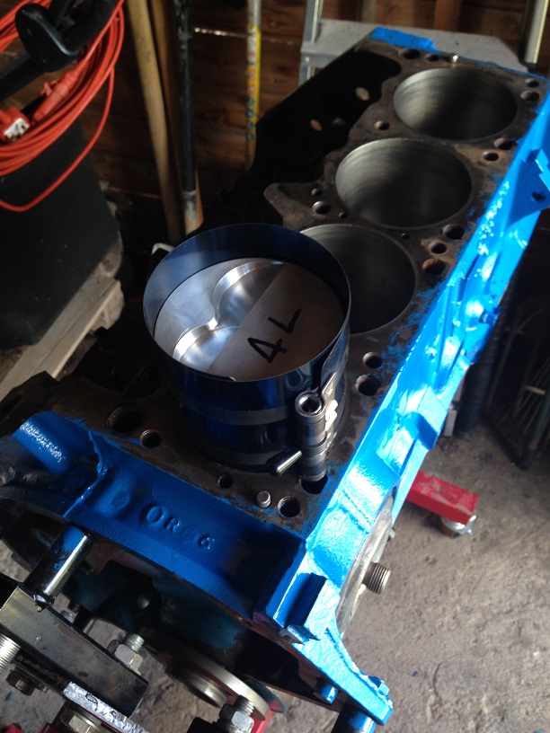

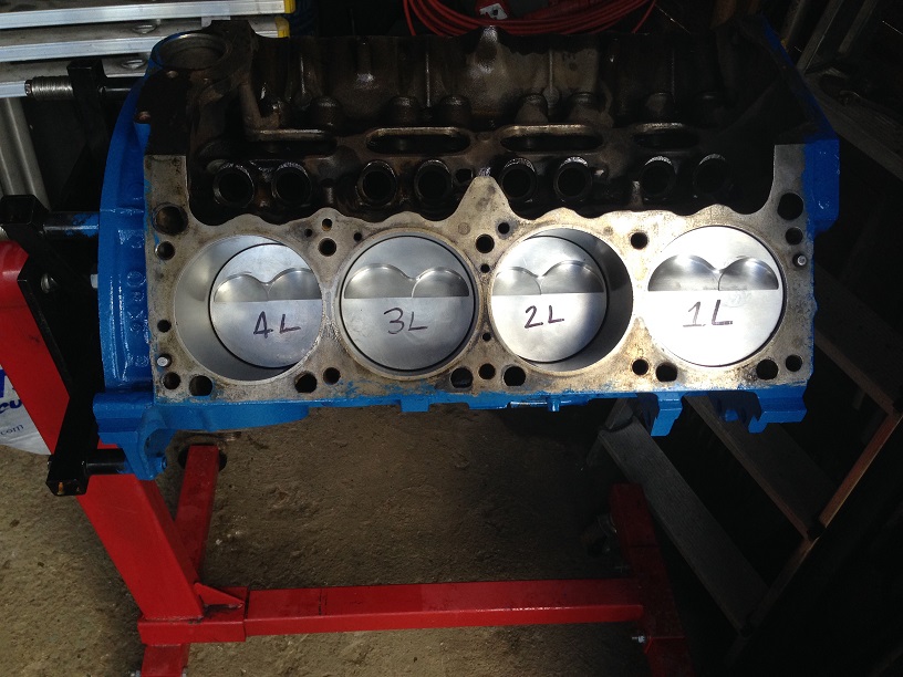

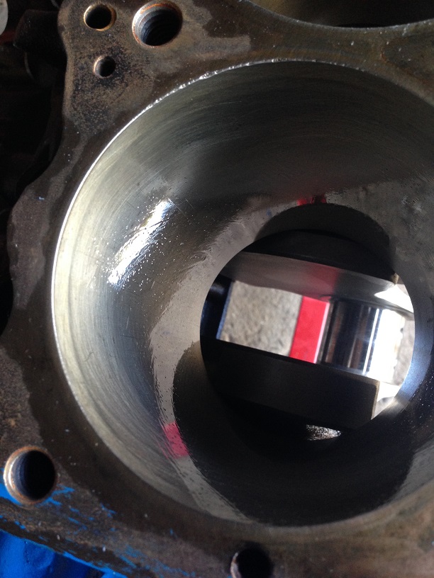

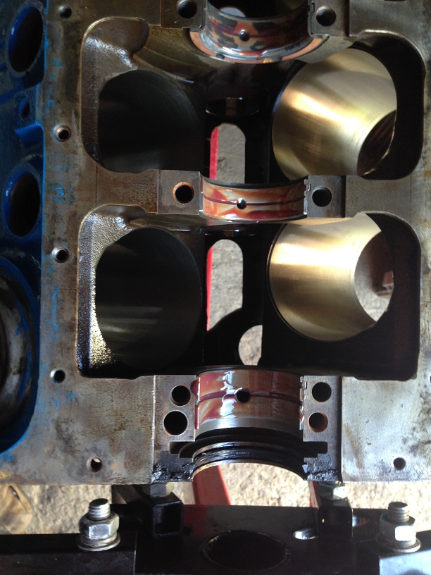

Time to pop the Pistons in at last. The Bore got another good dosing of oil as did the ring compressor. Yippee the Pistons are finally in the correct cylinders. And as you can see there is a noticeable PTW clearance now.
right bank.jpg (164.92 KiB) Viewed 416 times
left bank.jpg (175.27 KiB) Viewed 416 times
piston in.jpg (182.55 KiB) Viewed 416 times
oiled bore.jpg (170.41 KiB) Viewed 416 times
