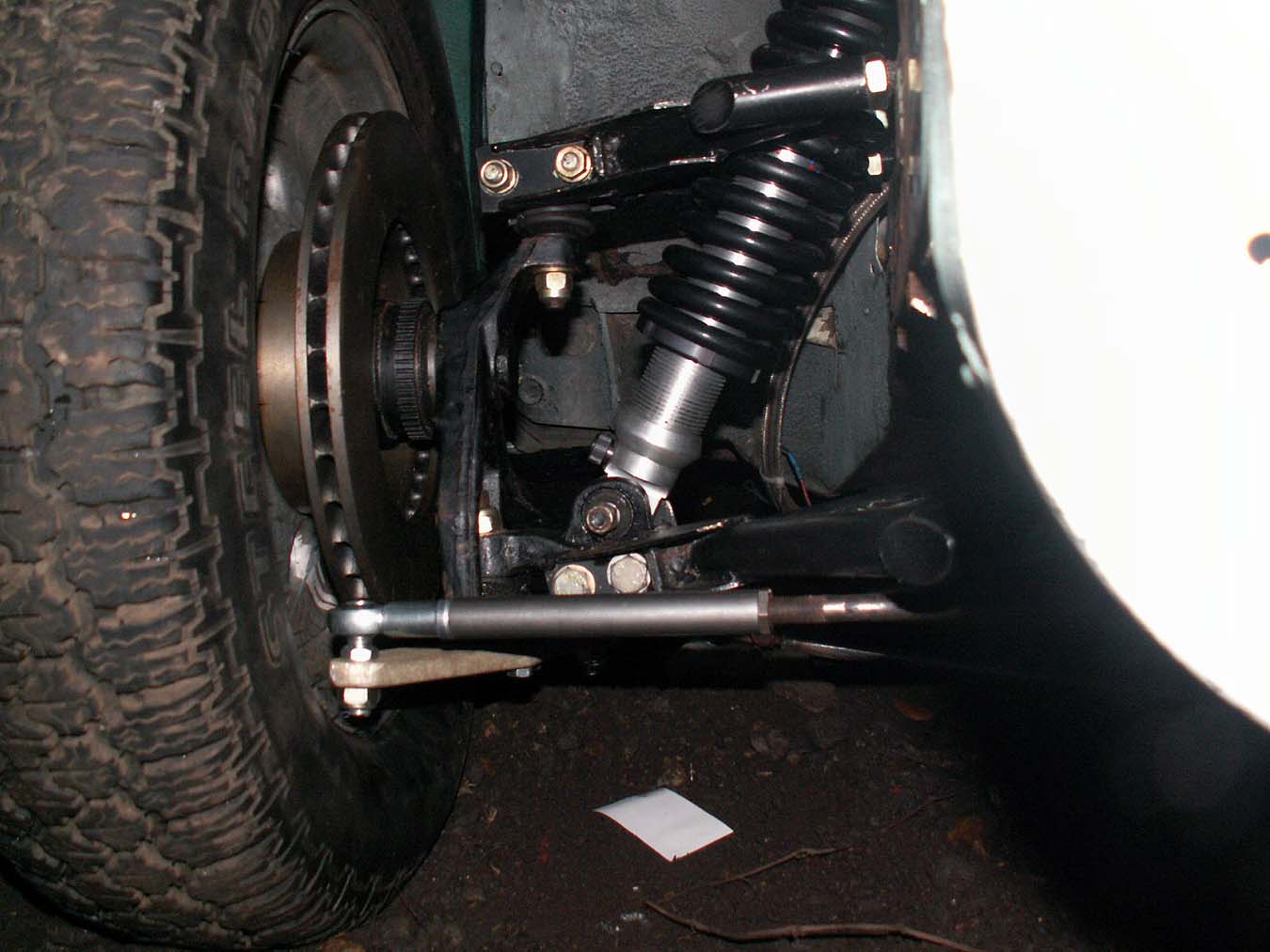

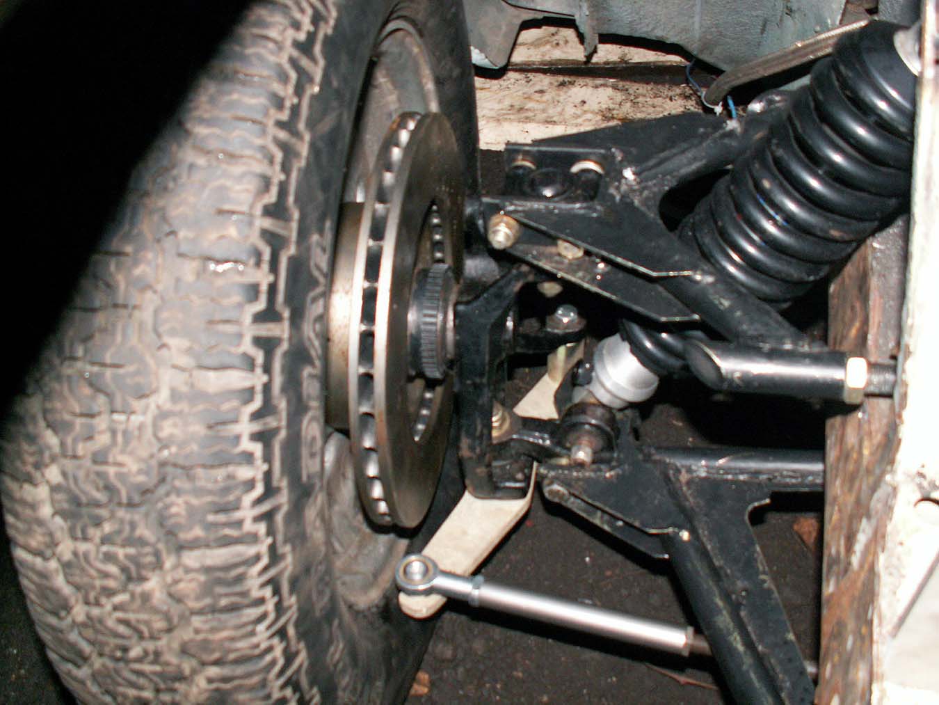

Great day at the salt mine today steering is in and sorted, just a couple of steering column brackets to fabricate and will have completed the steering and suspension modification the rest is pretty straightfortward after this.
the pictures show the new steering arms and the rack and pinion steering rods connected.
The first picture is a guess the arse competition
- Sus 001010.jpg (165 KiB) Viewed 2818 times
- Sus 007003.jpg (127.94 KiB) Viewed 2818 times
- Sus 004005.jpg (161.96 KiB) Viewed 2818 times
- Sus 011013.jpg (142.77 KiB) Viewed 2818 times
- Sus 010002.jpg (119.7 KiB) Viewed 2818 times
