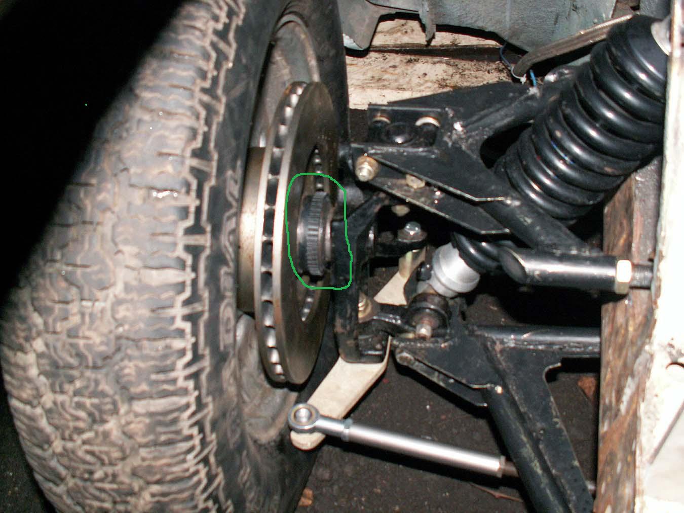

You got ABS there Bob???? Isaid ABS not IBS... :D :D
blz 2.jpg (169.49 KiB) Viewed 2851 times
Well spotted Rich, your almost as observanrt as Dunc. :thumbright:
The spindles are off a late jag and have not bothered to knock the rings off.
On the other hand could put a sensor on them and plug it into a data logger.
But as this car is going out old school the only logs are probably going to be in a race suit ala naughty Al at shakey. :D

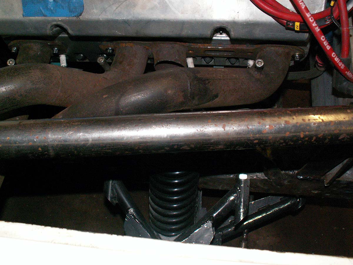

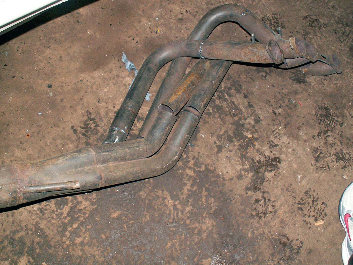

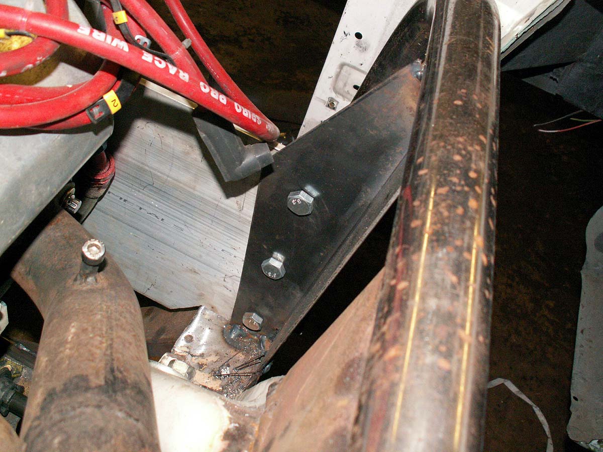

Few pictures of headers and engine bay.
thers is a shot of the front engine mounts, the steering column, the headers waiting welding for the nearside and the headers on the ofside showing the 6 pot exhaust and the route it has to go up and over.
