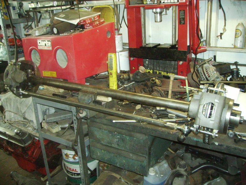

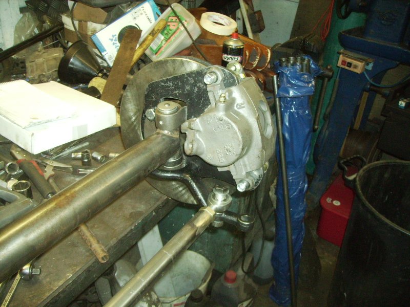

i pressed the other top hat spacer onto it's spindle today and assembled that side hub,caliper steering arm etc. with my stash of bits from rally design i had 4 allen (cap head) bolts to hold the steering arms to the spindles as there was no room to turn hex heads due to a step they have. i still had to turn the heads down about 0.5mm and cut them to length for full thread engagement in the steering arms. then i just ha dto turn 2 spacers, again for the steering arms as the caliper brackets only bolt to 3 of the 4 bolt holes on the spindle so i had to make that thickness back up for everything to fit. i guess if i'd bought a conplete setup from speedway then i'd have had all the right bits but the way i've done it is roughly half the price so...... lastly today i made the trackrod with 'rose' joints (which i'll use on all the front suspension and steering), a length of tube and a couple of threaded insets.
here's a couple of pics,
neil.

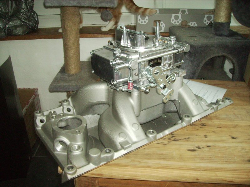

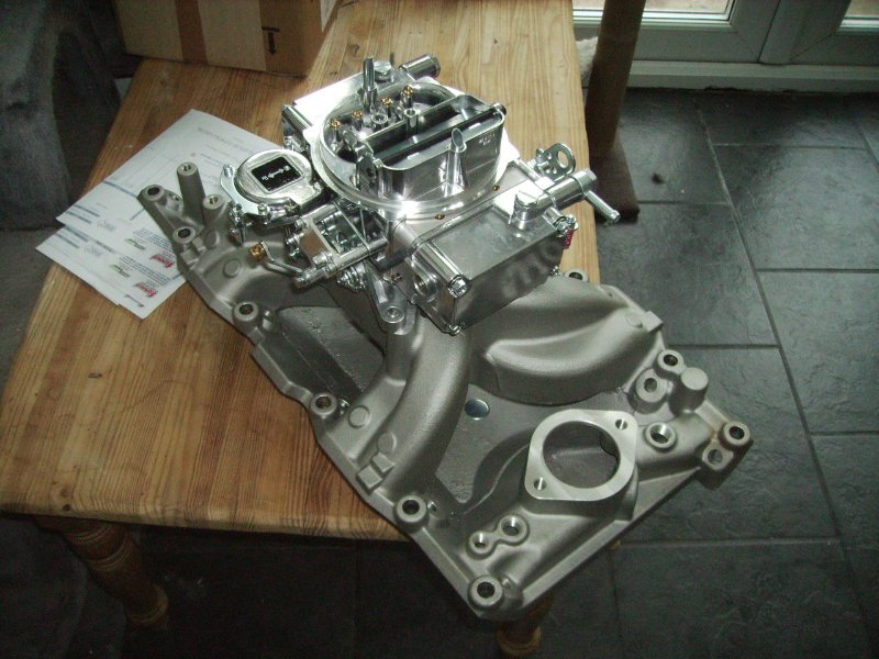

i just ordered a speedmaster intake, it's their performer rpm air gap knockoff but so cheap. also a 600 brawler carb, again very cheap. then a pair of stainless headers off ebay, probably chinese at the price but i need a car to drive while i build the rat rod chevy truck and 32 roadster pickup so....

the intake manifold and carb arrived today. it seems summit are as quick as ever on in stock parts. 4 days from order to my house in the uk, wow!
