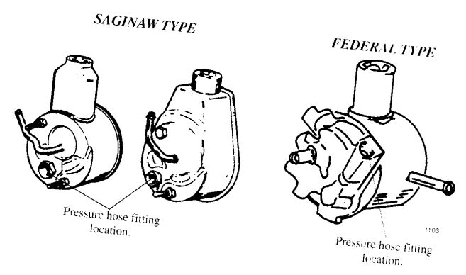

Evening ,
I will have to look under the bonnet ,but have a feeling its the Federal.Maybe.
Its a good fix .I wouldnt mind light steering if I knew which point of the compass I was headed.Saying that box only has minimal play,I think its a bit of everything .A lot to check over.
You say on the output Dave999 but Dave previously said shim input shaft.Sorry to be picky!

input shaft bearings on steering box need correct preload that was the subject of the first post
but this is a pump modification to give better feel.
to do it to a federal pump i think you would need to take it to bits and it might not just be shims
