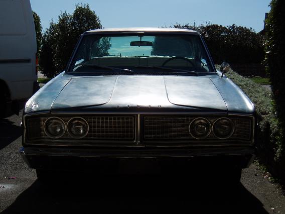

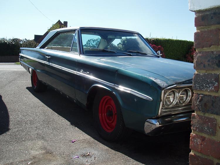

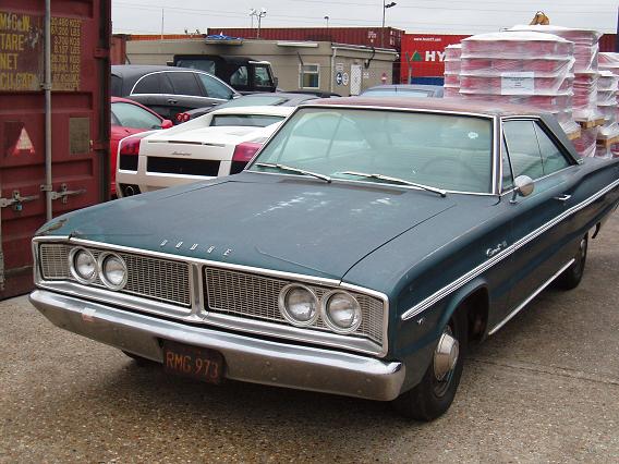

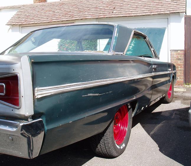

More pictures ,I did say it was original.
