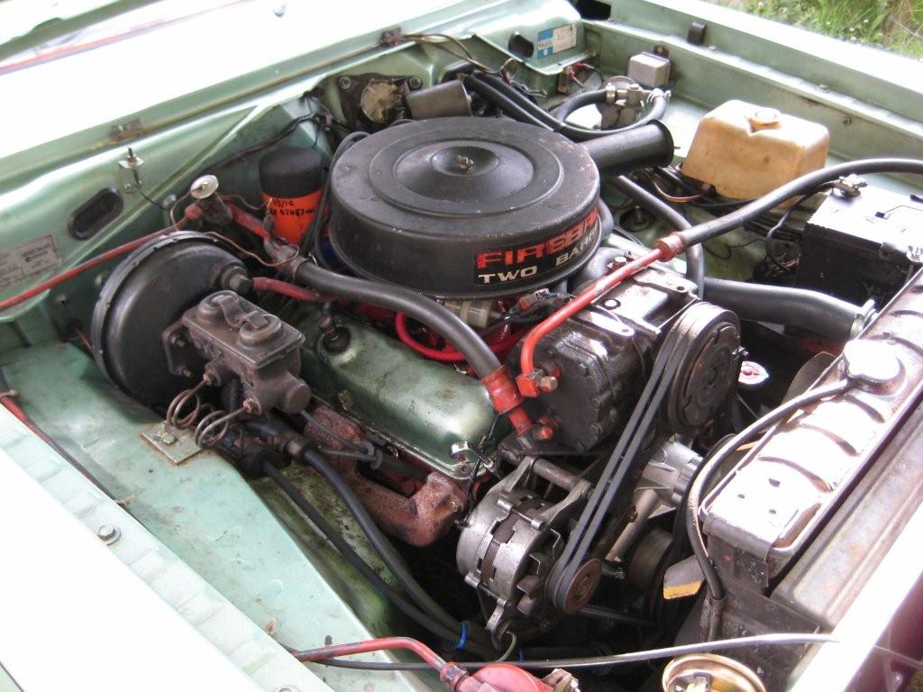

Reason for questioning is that with servo and master cyclinder fitted there appears to be little clearance for the rear spark plug and have seen articles on a number of mopars being converted to manual brakes junking the servo. When I saw the below while surfing it gave me the idea.

Expect that your booster will be the same as on my VG - see pic
What is the problem with your booster anyway?
Any pics?
I have a couple of extension bars in my socket set that I use to get my hidden plug out, from the outboard side of the booster & master cylinder.

One of the boosters has a broken locator which I will repair with parts from the other unit, so I should be okay. As previous was interested in the manual braking system as it looked an easy mod and wondered how it would affect the pedal pressure. Probably best to rebuild as is and wonder about the mod later.
