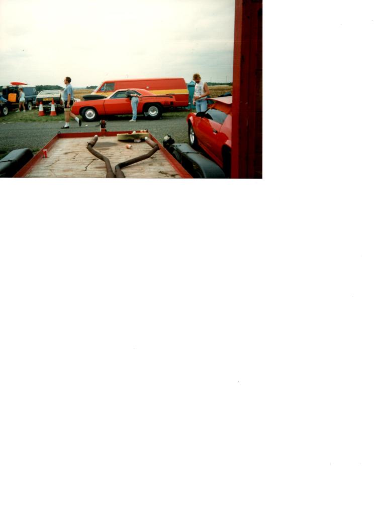

[quote="baccaruda"]Hi Les,
Cookies Dart!
Used to run 8.3's at 180mph.
Street legal and all that stuff!
Now owned by Ray?
Me and Jimbo ran with an iron-headed 440 as funds were tight.
Ex Rob-Loring built motor, ex Grumpy's Dart?
Raised port 906's, 1/2'' spacers screwed to intake sides.
Steel crank, ali rods, venolia pistons 13 t0 1.
650 Crane roller cam with Crane Golds.
Team 'G' with 1050 street dominator.
4.56 gears and humungous tyres 31 x 16's.
Best run by Jimbo was 10.40 at 132ish.

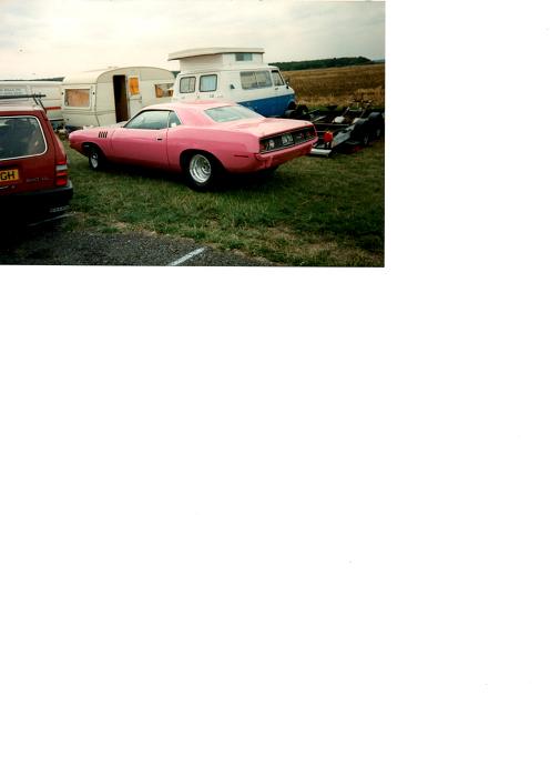

[quote="baccaruda"]Hi Again,
Mick Payne and the Artful Dodger!
Iron headed 440, ex Hauser motor.
He used to run 10.40's all day long in a very heavy 67 Coronet!
Tunnel ram with twin 750 double pumpers.
Think he used to cheat abit with a shot of NOS!!!
Story goes he had a buyer for the motor and run it one time too many.
Guess what, the motor went bang and 5grand went up the swanny!
Still got one of the heads orf dat motor, very nice work done by Hauser back in the day!!!
The pink car went 11.00 on the motor, seen it run loads of times.
Mick

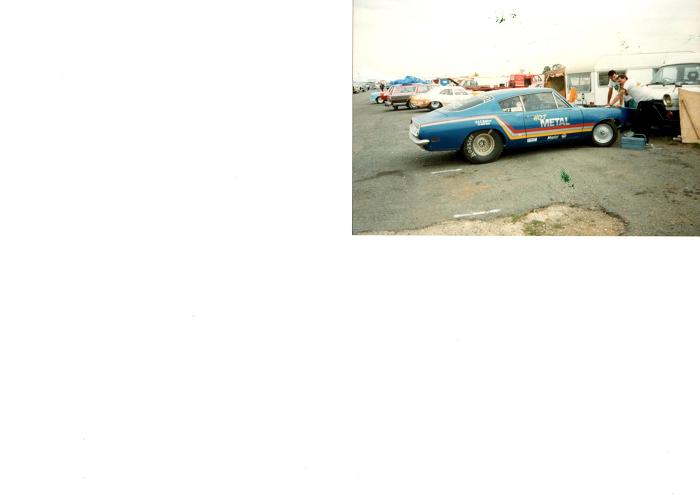

Hi Bacca, yeah them Koffel motors were something....too dear for my budget at the time....basically a super stock motor like the Hausers Paul Rossi Challenger but with extra cubes, certainly made hp, and yes those 452 heads could produce well over 300cfm of flow on a max port and were more readily available.baccaruda wrote:And Again,
Roger Povey and his 70 Cuda!
10.01 with a Koffel iron headed 451, (440-crank in a 400-block)
Had the heads orf that motor too when that went to mopar heaven.
They were so heavily ported they were lighter than ali ones LoL!!!![]()
A true work of Art and proof that the iron head was King of the strip.
Koffel believed that the late model '452' head was even betta than the 906!
I think that motor will be back on the track agian in the near future, in another Cuda LoL.
bacca.
Only downside was no N20 so whatever it ran in your chassis, that was it, I guess some went tits up cos some tried the N20...don't know the full story.
