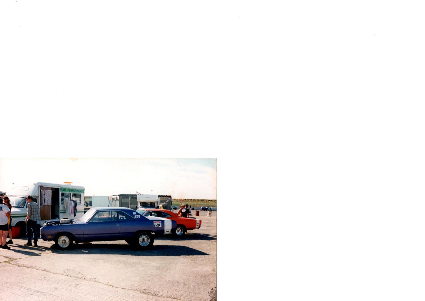

Hi all, just thought I'd put this up again as a refresher for anyone who hasn't seen it in before on here, and who's building a race car and starting with a standard 440 engine from a wrecker or similar.
This is what I ran in 1991 to run the times mentioned below, its intended to keep costs down to a minimum as todays vast amount of bolt-on goodies can be very tempting, but do you really need them? to achieve YOUR goals.
Car..1969 Cuda, Race spec
Engine:
440 6-pack, std bottom end, rod weight 2lb ea, std pistons 10.5:1 CR, 1100gms ea., internally balanced, and weight matched.
Camshaft, Comp Cams Flat tappet, .650 lift, 290deg@.050thou
Heads, 906 Ported, 2.14 inlet/1.81 exh., HS Roller Rockers, triple springs with small spring taken out, all set up to exact length....your biggest outlay, but the biggest gain (7/10's), apart from N20.
Oiling, single external line Milodon, deep sump. (important)
Induction, Team G Race, +2" spacer+N20 plate, high as I could get it. 850dp Holley used on the 340, 50cc front pump, 88fr jets/92 rear, no.31 extended shooters.
Exhaust:- 2/14" Fenderwells with 12" extensions.
Transmission:
727, Full Manual, std pattern, 8" 4200 Converter. Mr G. Shifter
Ignition:- Accel electronic with std MSD6A, NGK 7's, 38 deg total all in at 3000rpm
N20- Cheater Big Shot plate kit, 2 x Holley Race pumps, 2 x 1/2" fuel lines, seperate pump for fuel for N20. 4-6psi, simple on/off arming switch, 15lb UK bottle, microswitch set for max hit on WOT.
Chassis:-
2x3 rear rails, std 8 3/4", narrowed 2" per side, Strange 33 spline shafts, strange spool, 4.88 richmond gears, adj Coil overs/ladder Bars, loop and balanced prop with long u-bolts. 12x15 wheels, Tyres, 14x32 Hoosier's at 4-5psi.
Car weight with me approx 2900lbs, prob a bit more like 3100....wasn't light
Best on motor 10.71 @ 126, = 500hp.....could've got it to mid tens with a bit of fiddling with what was there.
Best with N20 175hp shot...1 run only at 9.96 @ 133.90 = 620hp.. at a trap rpm of 7600!!!!.tooo much.
So there you have it, not an absolute, to be used as a guide only but should give you a good idea of whats achievable with a good chassis and tyres, and nothing fancy in the engine dept.
I hope this helps/saves money for some of you who would be happy with these ET's and are thinking of exotic parts you don't necessarily need.
Happy Racing....Les
