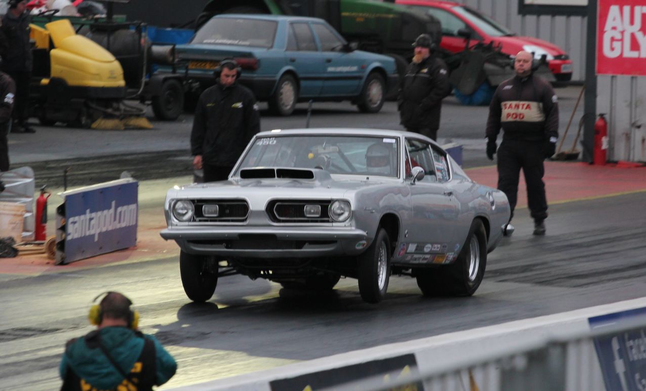

Guy
Posts: 5002
Location: Behind a Camera
Post by Guy »
Heres Mark's Barracuda , a really well prepaired car.
mark Bailey.JPG (114.25 KiB) Viewed 1307 times
Les Szabo wrote:You mean 2700lbs.....no, don't know it mate, there's lots of cars I don't know about now, as rarely went back till last years Nats..got any pics and some spec?....sounds interesting at 9.1.
yes 2,700 sorry sweet car
