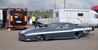

Love it 8-)
Wow. Speechless
:shock: :shock:
Mad Max on Steroids.............Looks mean as hell!
Top quality work! :thumbright:

Nice pics Rob.
Still seems weird to me, to see a Pro Mod with a shifter cable (I understand why though)
How long are those plug leads, seems a long way to the Mag, maybe the photo angle.

Mark, they are seriously long, just routed that way so that they are out of the way of anything hot or moving, whilst making it easy to service the top end.

I was watching the coverage ,The Badbird kept dragging itself over the line when in stage,,,,, check out ARs new Camaro....

We've been struggling a bit this weekend, we have a bump box for the trans brake which allows you to build boost against the T/B when in pre stage, then hit the bump button which momentarily releases the T/B for a set time (adjustable on the bump box) this "jumps" you in to full stage. It is quite violent & we chose to try a larger jump then reduce it to find the correct setting rather than starting small & increasing. We are pretty much on the mark now & hopoefully we should hit some good numbers tomorrow morning.
Andy's car is stunnimg as you would expect & he has already made a high 6 second pass.
