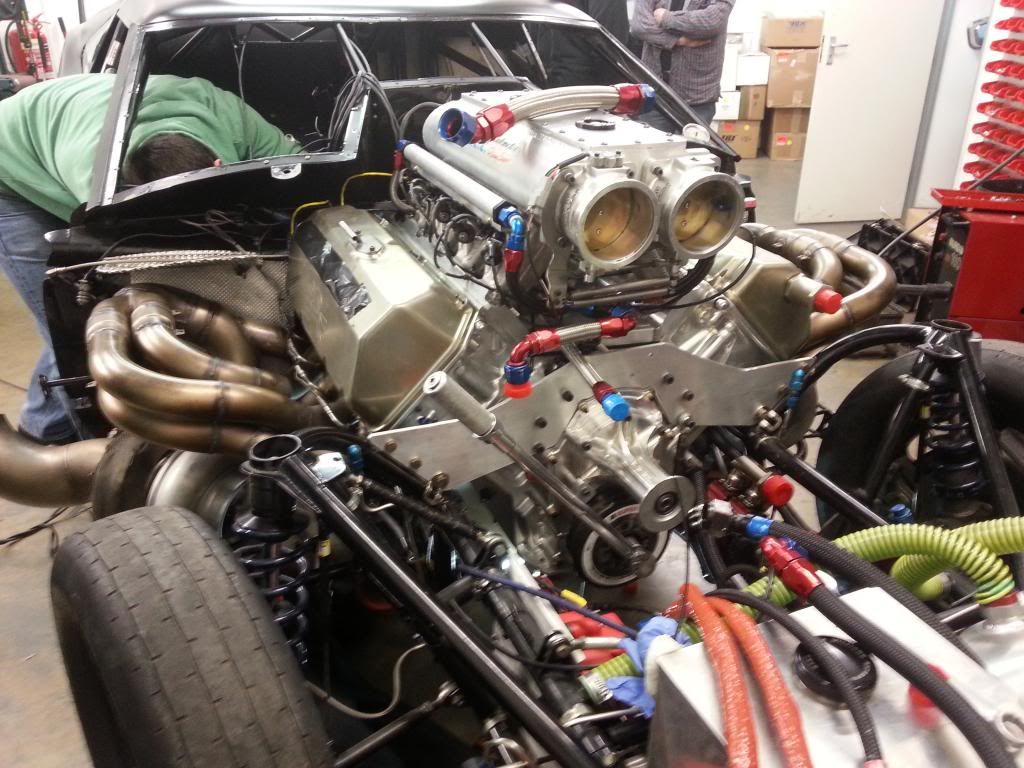

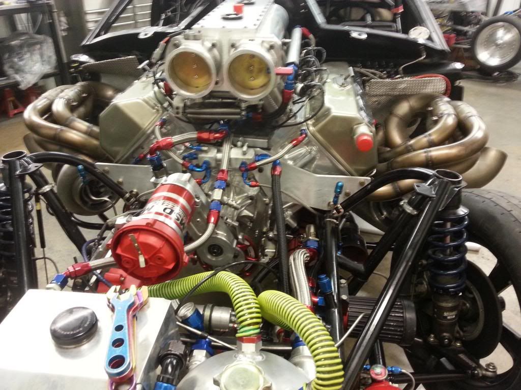

OK for those of you that may be interested the hard work started yesterday most of which was spent getting the new Meziere starter to fit & mesh correctly with the starter ring. Bit of time with a mill & lathe sorted that. Then we started today with a thorough clean up of all the motor ancillaries before bolting in the long block.
Then on with the intake
Followed by the front mount mag

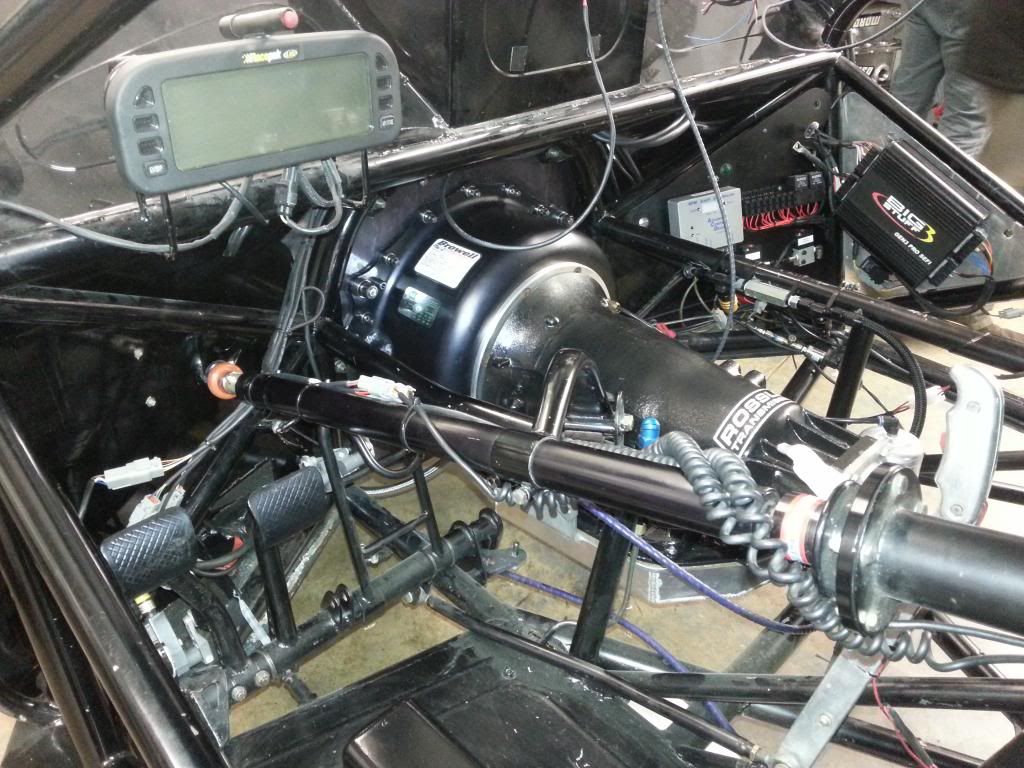

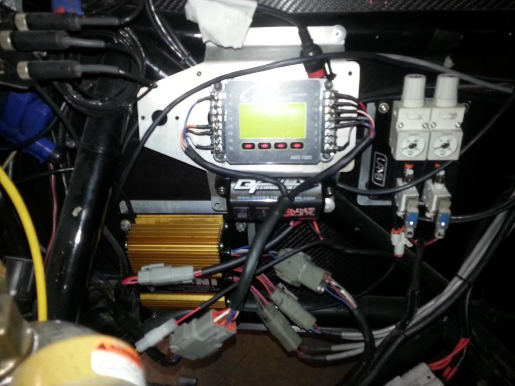

Most of the electrikery is now done, just a bit of tidying up to do & it will be ready to test to see if the new custom made loom works, I don't know if any of you had looked at it, but for the last couple of years (since we went turbo) the wiring has evolved to such an extent that it looked like a couple of plate fulls of spaghetti, it was always the plan to do a full rewire once we knew what worked as regards getting the car to launch properly.
Sorry for picture quality, didn't take a camera with me. Should be a few more updates before the first test session.

Regarding the AMS, do you use CO2 across the waste gates or is that not allowed ?

Mark, yes the AMS uses CO2 across the waste gates, this has been where we have had a few problems, hopefully now ironed out, can't say too much at the moment though! I don't think the car has been raised although when it first came out of Andy's shop the hat for the blower was above the roofline so we had to raise the rear end a tiny bit IIRC.
