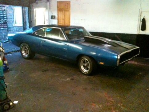

10x15 with 295/50x15 rear
7x15 with 225/60x15 front
No problems on my charger

same same but i have 11inch wide wheels and 275 i think or maybe 295 on back but have jack up springs.
this seems to be the standard big combo a fews people are running like this.
If you need me to measure back space or you want to take my wheels for testing feel free

Any pics 70_charger ?
Is it stock height at the rear ?

Standard springs no chrome mouldings. Standard 3.75 bs torque thrust
But I also would like to know whats the biggest tyre you can get under rear if low like yours even if springs have to be relocated but with standard tubs and inner arch lump, think the tyre sitting under the arch looks better that back end sitting up.
