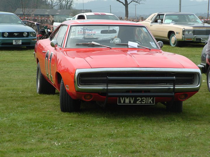

MilesnMiles wrote:I hope 295 x 50 fit as I've snagged a brand new set for my Roadrunner.
295's on mine Miles :thumbright:

Post by vipergts »
Your 70 looks great.
