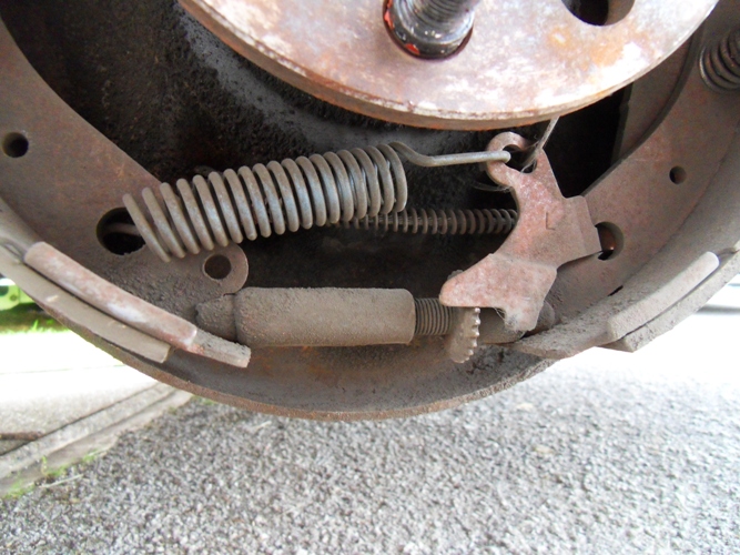

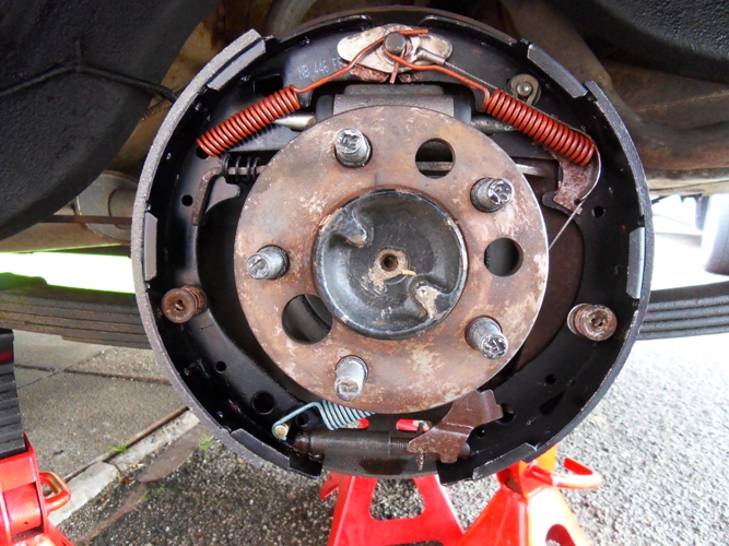

Managed to get the drums off ok....tapped them, no joy so thought I would VERY gently put a wide blade screwdriver into the gap between the drum and backplate to see what happened. Tiny bit of pressure and the stuck one just popped off! Other one came off easy...
Good clean up, new shoes, cylinders and brake lines (in for a penny) and shes all done. I now understand exactly how the adjusters work but had to actually see it to work it out. The lever that links into the ratchet adjuster just pushes straight back on mine, not up or down, to allow the adjuster wheel to be turned.
Managed to strip a thread in the union on the axle but thanks to Dunc, Im sorted again. Learning point...dont try to turn the brake pipes into the union with it tightened down onto the axle...loosen the breather bolt to allow the block to lift off the axle a bit, screw pipes in, then bolt down again. Tough way to learn but got there eventually
Thanks for all your advice and support gents, fronts should be easier when I tackle them,

- 2.JPG (230.53 KiB) Viewed 631 times
- 1.JPG (229.4 KiB) Viewed 631 times

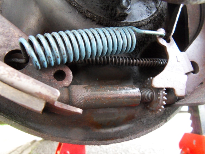

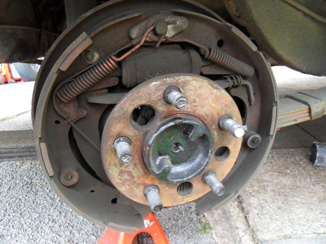

Thanks for looking Pete...Ive had to turn the blue spring around as my new shoes have a gold stud to hook the spring onto instead of a hole for it to sit into as per the ones I took off. I couldnt see another way to get it to sit properly without bending the spring too much....the original shoes shown in the manual have a hole, not a stud so the ones I took off were exactly like the OEM ones in the book but my new ones have the stud....
Do you think it will be ok as it is?? They work fine and the spring is straighter than the original set up

- 4.JPG (210.14 KiB) Viewed 616 times
- 3.JPG (227.4 KiB) Viewed 616 times
