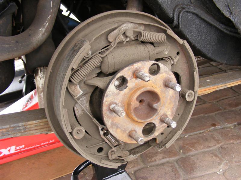

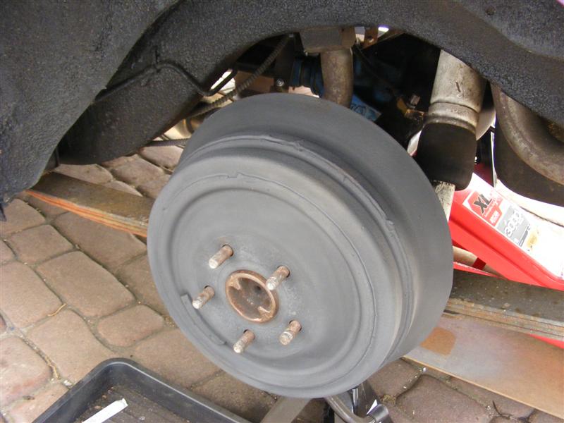

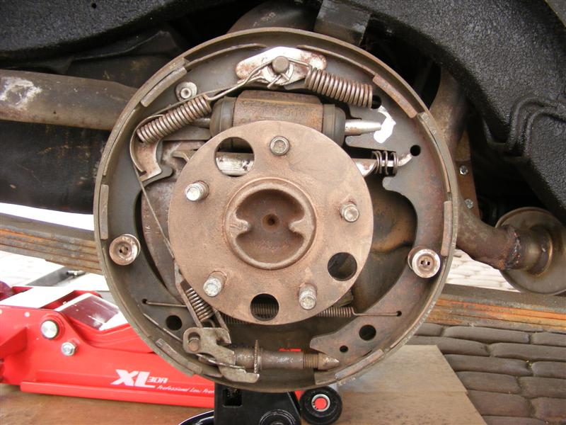

Hi Steve, I had a similar problem with my rear drums and thought they would never budge :evil:
My adjusters were solid which in one way was a good thing as it meant the shoes were able to move back and clear of the drums ( but not good cos braking was poor :roll: )
I spent the best part of a day with penetrating oil and a cow hide hammer and ended up leaving them soaked over night.
Next day with more persistent but moderate hammering :violent1: all round the rear edge they did eventually come off :woohoo:
I agree with the others that you must be as sure as sure can be that the adjusters and shoes are backed off to prevent any damage but it does sound very much like my issue, my drums were stuck/bonded on the inner faces.
This did take a lot of time and a couple of one ton bags of patience :lol: but hang in there and I'm sure they will give in :thumbright:
I cleaned everything out (mask on and brake cleaner spray for the dust) and had to soak and dissassemble the adjusters to get them working, all worth it in the end.
I have some before and after pics, good luck mate and show them who's boss :argue: :lol:

just out of interest James... On one of your pics I can clearly see the adjuster. I assume I have to find the little notch visible next to the adjuster wheel and push the sprung lever upwards to release the adjuster to turn freely?? Its not clear in my shop manual and your pic is really clear....just needs an arrow on it!! :D

Provided everything spins freely regarding the adjuster (mine were solid :( ) then you need to go in through one of the two holes in the back and push the lever down. Mine ratchets the adjuster with an up motion but the picture above from the book appears to show a version that ratchets down? In which case the lever would need to be held UP to get it away from the ratchet teeth on the adjuster wheel. Then the fun bit, you need to get in there and rotate the adjuster manually to screw it in which shortens it.
Wish I could show ya cos I'm a bit poo at describing things :lol:
The first ever time I did the fronts I'd never seen drums before so the adjuster confused the brain cell out of me :? as it didn't turn at all and I didn't understand what it's job was. "How the heck does a toothed round thing work with a fixed slot at each end?" I thought! Plenty of penetrating oil and twisting freed them up completely and all four now spin effortlessly :)
I really don't want you to break anything but honestly my drums spun freely with no rattles etc but it felt like they'd never come off!
