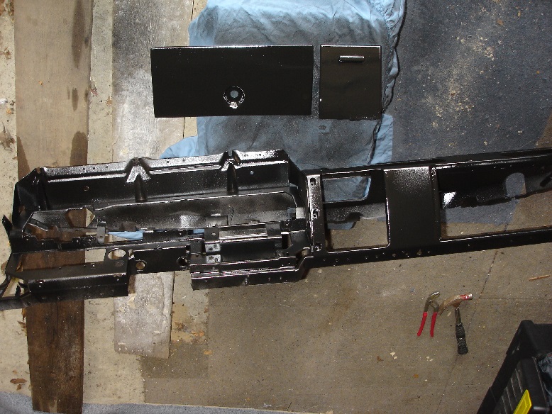

One of the main things my car was still missing was the frame onto which the dash board components would be mounted but this has now been resolved (Thanks Dunc).

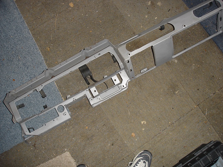

The frame was sand blasted and, after stripping the existing black paint from the ashtray and glove-box door (revealing traces of the original blue underneath) , the whole assembly was painted. I'll reassemble before giving it a final coat so the finish is consistent.
Awaiting final coat.
Frame 006 small.jpg (220.14 KiB) Viewed 2283 times
And now you don't (due to the miracles of media blasting).
Frame 004 small.jpg (206.48 KiB) Viewed 2283 times

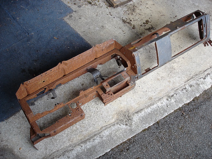

Surface corrosion - now you see it.......
frame 001 small.jpg (240.18 KiB) Viewed 2283 times

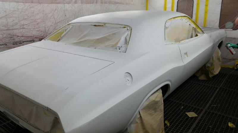

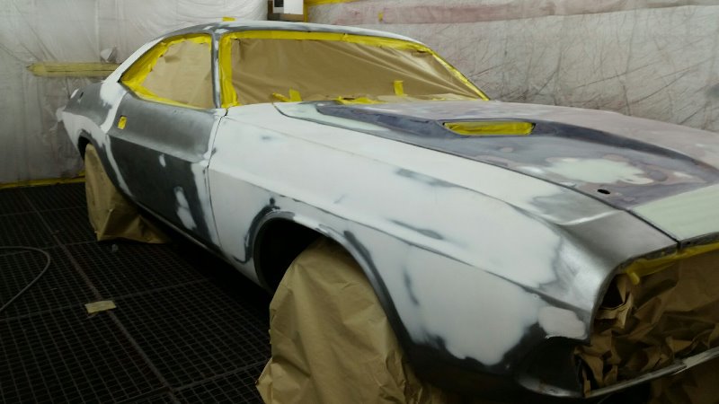

How time flies. Faux has previously been "resting" with my chosen body-shop for a while (the trouble with using a marque specialist is that small insurance jobs tend to jump the queue) but we now have progress.
The shell has been media blasted and a few more rust patches/pinholes have come to light, notably a ping-pong ball sized hole above the headlight on the l/h side and a dent in the middle of the top of the r/h front wing - this wasn't really a surprise as there was a distortion on the inside edge - but all have now been sorted.
Accordingly, there has been a lot of filling/sanding/filling (8 litres of white polyester spray filler to be exact)/sanding/before the black primer.
Before spray Polyester filler applied
Before  filler applied

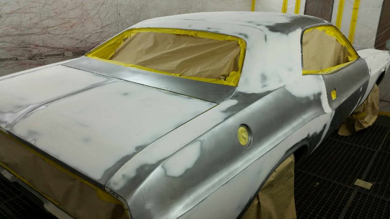

Guide coat being applied over polyester filler before further flatting.
All together for the moment - flatted and awaiting priming.

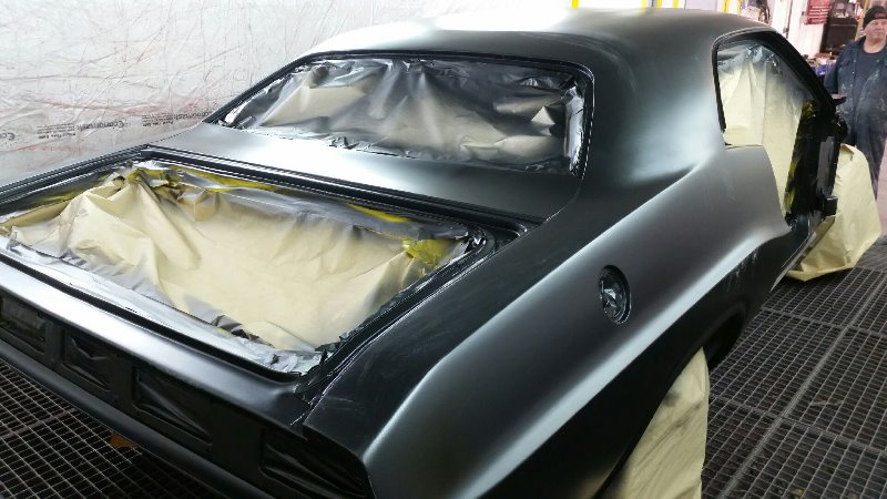

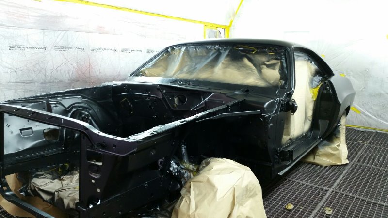

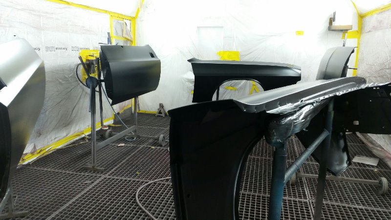

Couple of pictures of the car with the black primer applied. This was done pretty much immediately after the polyester filler was applied to avoid micro-blistering in the final coat.
