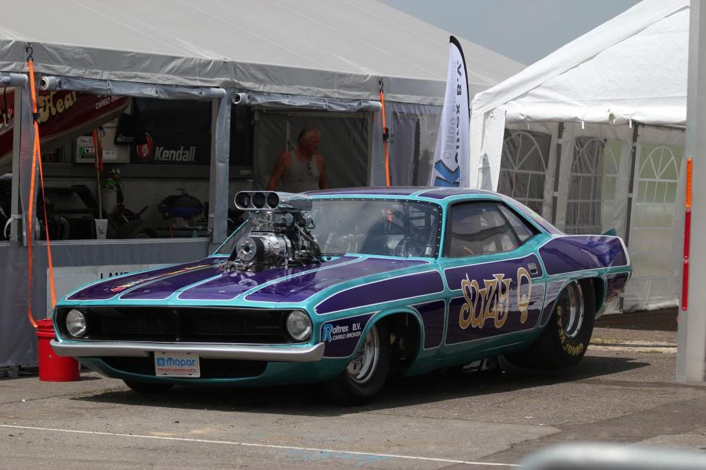

What's the deal with the Rover, is it a sleeper or just a stocker? Anyway the Suzy Q Cuda will do very nicely thank you...
