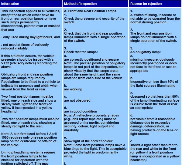

Ok - new MOT now obtained!
I just disconnected the rear (red) indicator connections to leave just the amber reversing lights as indicators.
The front was a more obvious bodge with a pair of small bike indicators cable tied to the grille.
Permanent solution?
Rears - Maybe just leave it as it is. I can enable/disable the original red indicators in no time as required.
Fronts - This is more difficult without changing the appearance of the car. The cleanest solution is a pair of LED white+amber bulbs. Job done. Except that no-one sells them :( . According to google/ebay, you can get them in the states (where you don't need them) but not here...
Jayce - How do your switchback bulbs work? All the ones I can find switch off the white when the amber is on, and that will fail the MOT regs again.
If I can't find suitable bulbs then plan B is to use amber bulbs in the sidelights and install headlights with integral sidelights. More faffing around though and I have to remember to open the headlight doors (as mine no longer work automatically - broken switch).
Back to the rear - I can't see that one amber light is more safe than one amber plus two red lights all flashing away. But, hay-ho, if that's what the rules say then that's it.

You do know that you can have amber front sidelamps as long as in addition you have something white.
For the rear you can put in powerful amber leds that will shine amber even through a red lens, that way you can keep your reversing lights.

Hmm... as I read it under A3e, they have to be white only unless you have yellow headlamps.
Richard
Posts: 281
Joined: Tue May 30, 06 9:24 pm
Post by Richard »
Yes but your amber sidelamp is not your obligatory lamp- your white ones are.

For the front indicator / sidelight issue, would you be able to fit an amber LED inside the front sidelight under the bumper, this would allow the white sidelight to show whilst still being able to flash an amber indicator regardless of whether the sidelights were on or not?
You can keep the original wiring for the red indicators on the back by connecting a green LED and fitting it in the red lense, when lit up it will show an orange / amber light through the red lense
'68 Dodge Charger
‘75 Ford Ranchero
'93 Toyota Hilux Surf
YouTube - Double Zero Garage
Make the reverse lights indicators with orange bulbs
(You don't need revers lights legally I think)
Make all side markers indicators
Make front lower side lights indicators with orange bulbs
Stop brakes like flashing
Install 2 x capri head lights with built in side lights
Cost £50 time 6 hours
