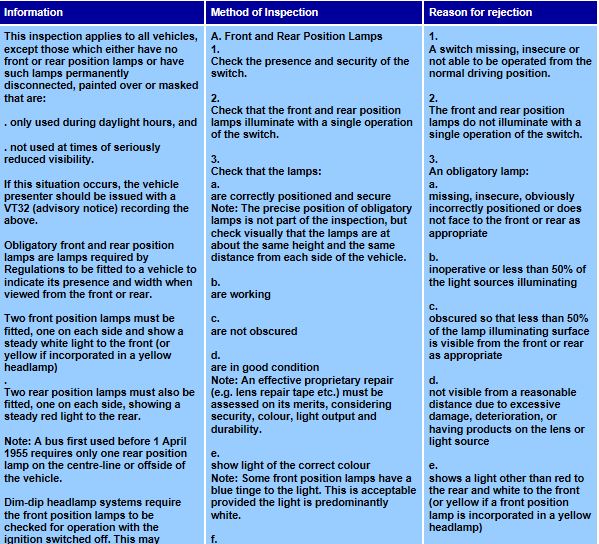

Took the Charger for testing yesterday. Chap comes back - 'Nice car, nothing wrong with that, but it's an automatic fail of course, with those lights'.
According to him, section 1 of the MOT manual requires separate white sidelights and amber indicators for post-65 cars. Fair enough, but not easy if the car only has a single combined lamp.
He was unimpressed by the twenty previous MOTs. They were just proof that other testers don't do their job properly :roll: .
(He also failed the rear indicators - apparently having an amber light in addition to the original red indicators is forbidden, they must be instead of. But this is an easy temporary fix).
Anyway, questions -
Has anyone else had this issue?
What was the fix?
I'm just going to cable tie some old bike indicators to the bumper to get a pass from cheerful charlie, but making up an LED 'bulb' that's half white, half orange and replacing the original dual-filament sidelight bulb could be a neat solution. Legal, who knows?
