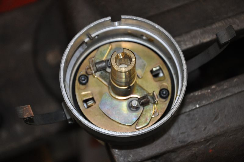

Posts: 5235
you need to limit the amount of total mechanical advance
the more you increase your initial advance, the more you need to limit
for 20deg initial and 34deg total, you’re looking for 14deg of mechanical advance
to do this you can use a J685K Limiter Kit … http://www.fbo-uk.com/fbo_ignition_systems.htm ... from Turnip (Jon) on here
or for an adjustable dizzy adjust with the 2 black allen screws like this …
Posts: 9563

if you are checking the timing with the vaccum connected you will pulling in an extra 7 8 10 degrees via the vacuum as soon as the throttle plate passes the vaccum port. Not syaing you are but the symptoms you describe sounds like you are
plug it at the dizzy end of the pipe with a nice screw so it can't get in the way of measuring mechanical advance.
initial + mechanical + vaccum can result in 45+ degrees under ceratin circumstances (which is fine, those circumstances need that advance for emissions and ecconomy)
spin it to 3500 and set it to 34 BTDC
let it idle and measure what you got at idle
if its at 5 BTDC or something daft like that you need a recurve kit that takes out 8 or 10 degrees * from yoiur distributors mechanical advance so you can set it to 12-15 BTDC at idle and still not go over 34 at 3000 or so.
then connect up your vaccum advance and don't worry about what it is doing at the mo.
as long as you have it connected to a port that enters the carb just above the throttle plates you will be fine.
* speak to turnip. if you have a mopar dizzy he can provide an FBO recurve kit
springs
a limiting plate
set of instructions
plate sits on top of the advcance plate and limits how far the Tabs in the advance weights are allowed to move outwards therefore limiting mechanical advance in the dizzy. plates come with a number of holes labelled on the diagram so you can choose how much you want to take out
use springs to adjasut how fast the advance comes in
use instructions for a nice bit of bedtime reading before starting :thumbright:
(helps to avoid firing the circlip that holds on the armature into a hedge like i did)

Disconnect and plug the vacuum line. Leave it that way until you figure out how much initial the engine wants and then limit the total advance to 34 degrees. Then you can reconnect the vacuum and see where you are going with that.
Posts: 7454
Im a real novice at this but have found that Daves way works well for me, Stick the tacho on and slowly advance the timing. You will hear a steady rise in rpm. When that rise shallows off, lock the dizzy down and take a reading. That might be 16deg btdc for example. Now readjust your rpm to stock setting at idle. Get a pal to rev her up to 2500 rpm then take a reading. You ideally want 34-36 deg all in at 2500. If its 46 then just use one of Jons plates to knock the 10 or 12 degs off (the plate has marked slots) and you should be there or thereabouts. If you rev beyond 2500 and its still rising then I guess heavier springs are going to help.
If total adv isnt all in soon enough, try a lighter spring or two and if in too soon, try heavier springs.
Im a simple soul and need simple ways to do stuff. This is the closest Ive come to finding a way I can get my head round it and keep it all straightforward
