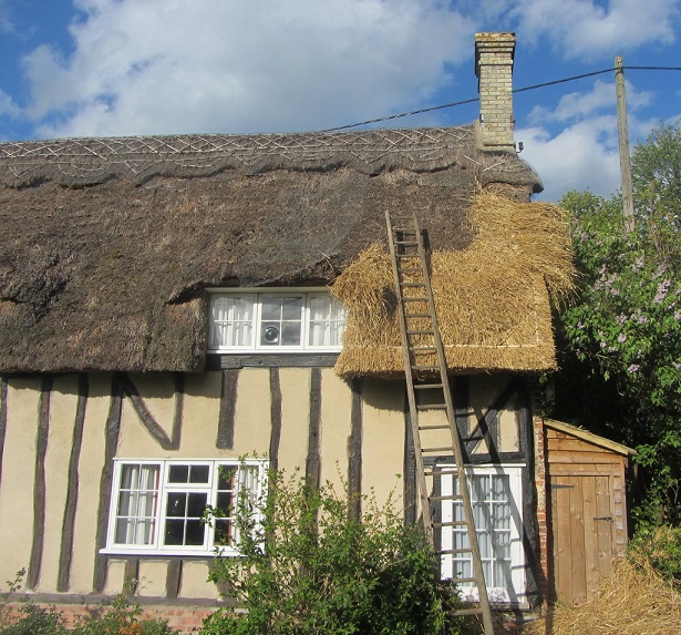

You can see the start of the Thatching process where the Yelms are placed at the Gable end at a 45 Degree angle and then gradually brought to the vertical as they work into the centre of the roof.........
...you can also see how battered the existing thatch is, but this is merely flatted back and a cover of new thatch placed over it. This is called "Spar Coating".
Only Reed needs to go back to the timbers each time (unless there is Rafter damage on a Long Straw Building).

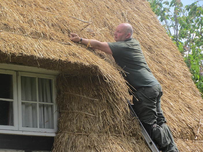

The Thatch had lost a LOT of material over the Windows (or had not been done properly the last time)....so a great deal of material that was dropped when the Yelms were made or trimmed on the roof fitting was then packed above the Window Eyebrow.............This took ages....probably 2 days...........

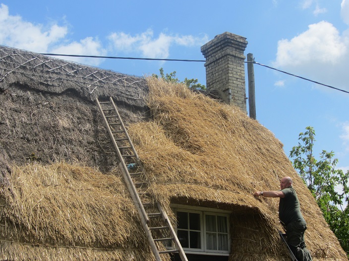

Once the Yelms have been packed to the correct thickness and shape (obviously all done by eye), the Thatcher then installs the "Liggers" to keep the thatch in place prior to the final finishing off and wiring..
The Liggers are held in place with more Spars - ohh Goodie!!!!!
You can see it taking shape and ho much more "body" the roof now has..........
Only 5.5 Ton more Straw to go............
